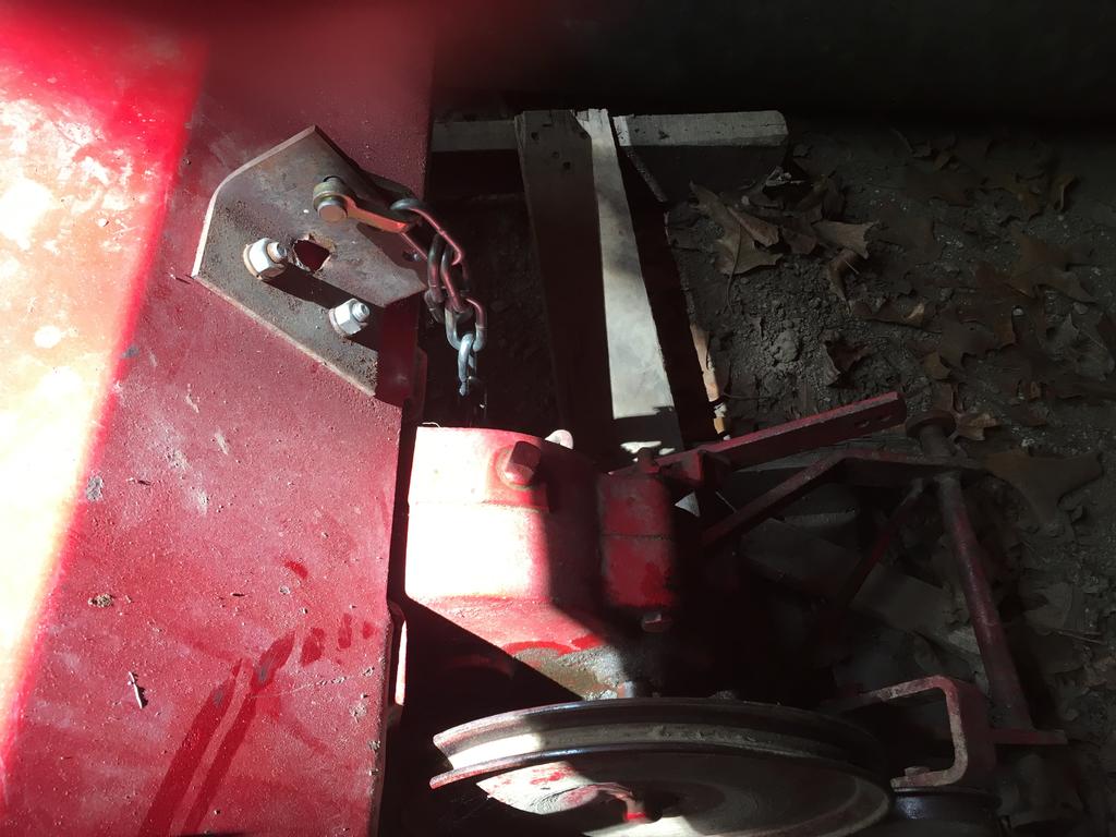

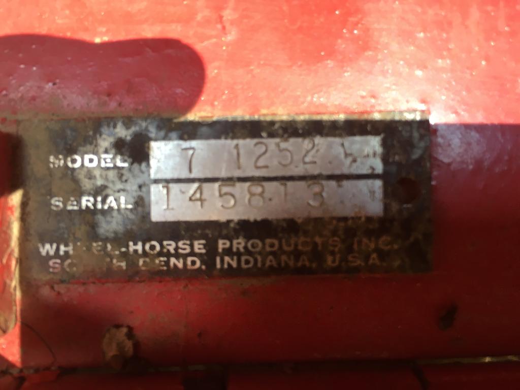

I bought this tiller earlier this year and it works great.  I don't think it's actually made for my 315-8 but with a little modification, it really seems to work well.  Now I find myself looking for another horse that will primarily be used to run the tiller.  Reason being, my 315-8 is my mowing tractor and, aside from the tiller being somewhat of a pain to hook up, my Cyclone Rake is coming into the picture around the same time I need to do some late summer/early fall tilling.  Then it becomes a real pain.  The way I am set up now, I know I could go with another 300 series, a 400 or even a 500 series I believe.  My question is, what else would work?  What models would this tiller actually be made for?  Could I go with a C series?  I would love that as those are some of my favorites.  You can see my modification in the second pic.  Ugly but it works.
Racinbob
Your tiller is a 1975 and will work on B-series through 1977, all C-series as well as 3/4/500 series. It will also work on the older Raiders, Chargers, etc. :)
