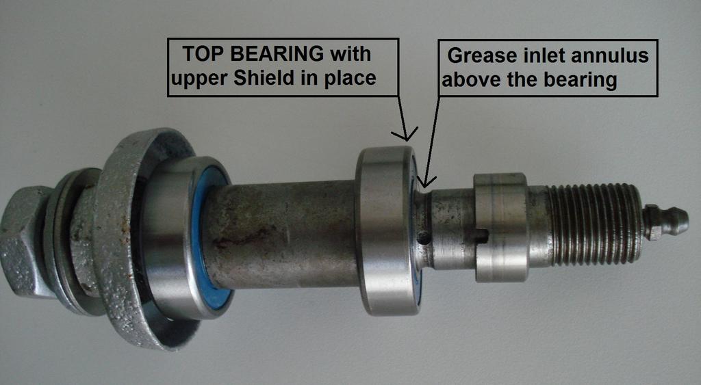

One point that needs to be made clear.
If the upper (old) Bearing from the Spindle(s) is found to have no Shields, then I strongly suggest he does a trial assembly on the Spindle to see if the replacement Bearing also needs to have both Shields/Seals removed if plan is to use Grease Gun in future.
If the Spindle is like some others on WH Decks,  the grease access point is above the top Bearing and if the upper seal is left in you will not get any grease to the bearings. Here is an example-
The Example Spindle Ass'y is for a 1978 36" RD Deck (Double Shields were left in as there was no intention of future greasing), but is similar in layout with different dimensions and part numbers.
Hope this helps.
