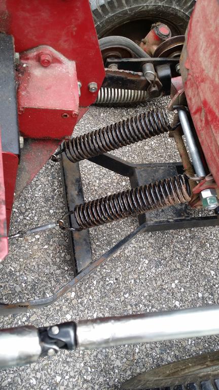

Well I hooked up the old ber-vac blower to my trusty 312-8 and i cant even pick up the darn thing! I do have the lift assist springs but haven't bothered hooking them up yet. I think I need the turnbuckles,but I have no idea where to find them so any ideas?
Ed Kennell
Any good hardware store like ACE, Lowes, TSC, or on line for about $5.
cafoose

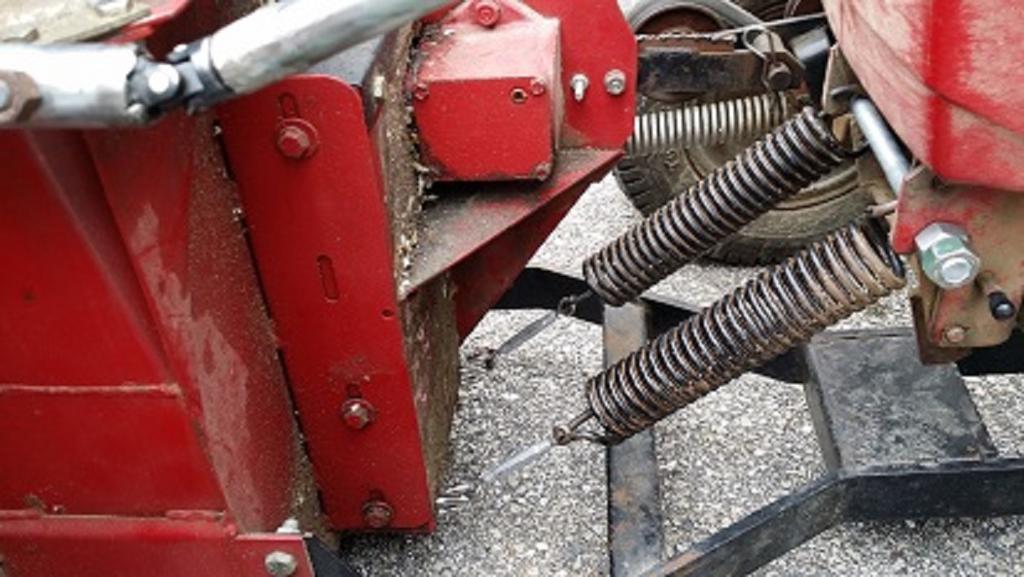

This is how I did mine and it works great:
I used hardware store turnbuckles and a large bolt in the front attachomatic where the mule drive normally goes :banana-wrench:
