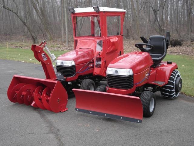

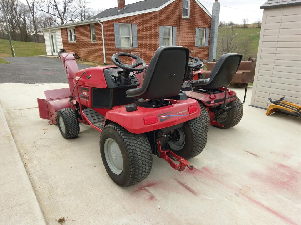

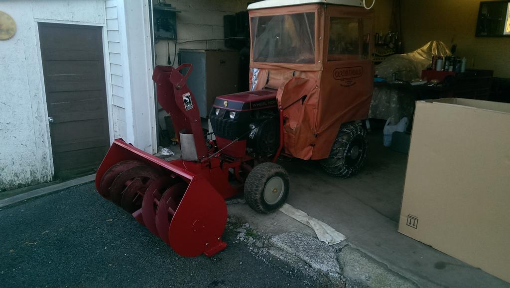

Yes and no, the upper/rear frame and "hard top" are basically the same but the doors and and front frame are different so with some fabracation it would work but with that being said any cab from the B,C( black hoods different),3,400 SERIES tractors will fit as I have an older cab from a 417 on my '97 520, here's some pics showing the differences, Jeff.
