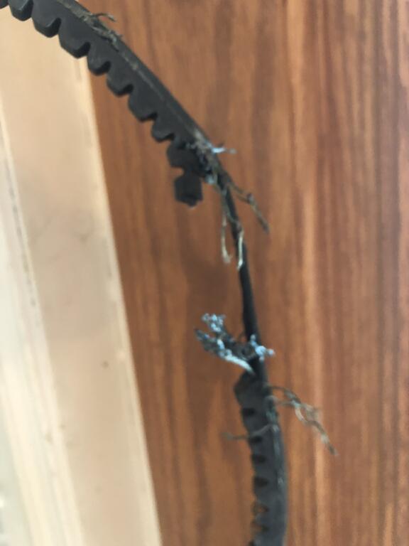

Pete, my front end loader always made a nasty screech when engaged. Just pulled out to warm it up for spring and the belt was eaten up on about 6 of the teeth. Since the belts are no longer provided by toro I’m wondering what the OP found as the best alternative.

So I used a 1/2x40 v belt to try and power the ark loader and it didn’t have enough grip on it to move anything. The 39” belt was way too tight and could not be disengaged. I left the 39” belt on there to drive my t posts in but if you’re going to do this remember to never engage your mid pto break, it won’t be able to hold the crankshaft and will just burn as it tries to hold the pto pulley.
I finally ordered some adjustable belts from Amazon (https://www.amazon.com/Adjustable-V-Belt-Lathes-Woodworking-Tools/dp/B07Y7Y3Q7W/ref=asc_df_B07Y7Y3Q7W/?tag=hyprod-20&linkCode=df0&hvadid=416925996615&hvpos=&hvnetw=g&hvrand=14086984520148568459&hvpone=&hvptwo=&hvqmt=&hvdev=m&hvdvcmdl=&hvlocint=&hvlocphy=9003055&hvtargid=pla-873192956854&psc=1&tag=&ref=&adgrpid=94306392952&hvpone=&hvptwo=&hvadid=416925996615&hvpos=&hvnetw=g&hvrand=14086984520148568459&hvqmt=&hvdev=m&hvdvcmdl=&hvlocint=&hvlocphy=9003055&hvtargid=pla-873192956854). I ordered two sets then measured out two belts as close to 39.5” as I could. Put them on the pulleys, and they work like a charm. Best thing is if either belt break I have spare links to replace the bad ones.
if these end up wearing out faster than usual I’ll put another post on here. Basically just find a v belt that’s close to 39.5 (because good luck finding one 39.714”) and get them your D-250. I reckon if they can power the ark loader they can power whatever you need on the front or mid pto.
also the screech is gone on the front PTO.
