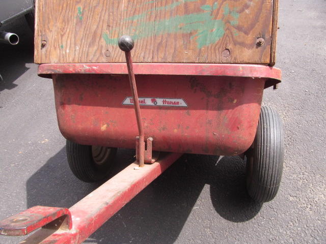

I know it sounds stupid but I disassembled a cart and now I am second guessing how the dump lever attaches.
do I slide the arm through the slotted hole from underneath, or does the whole arm and flat piece sit on top?

Will this help?
Racinbob
Push it up through the hole. The bolt you see is 2 1/2" long with a spring slid on it and held in place with a nylock nut. Run the nut on just far enough to get full threads. :)

That worked, got assembled with a coat of white lithium grease works great.
