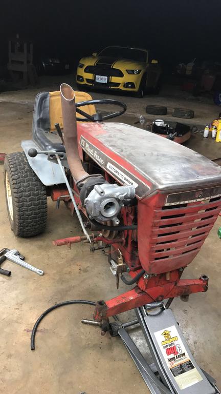

I do have a pic of the turbo 1276 in which I just took a junkyard turbo that was way too big and bolted a carb on the front and it just kind of worked. That's the one I cut grass with weekly

Does the turbo actually work, or does the carb just pass through it?
