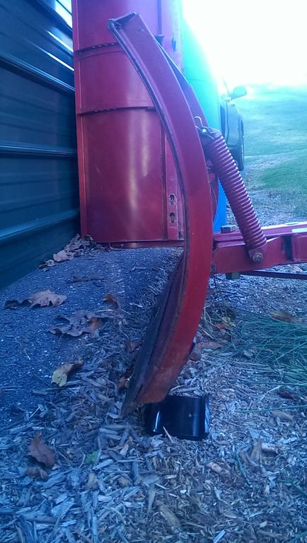

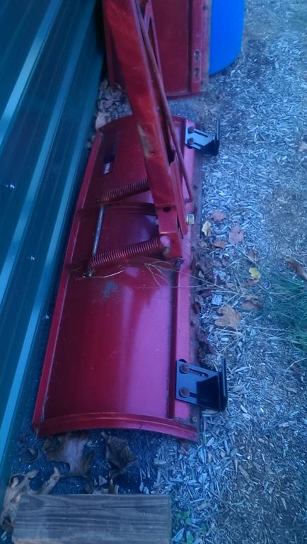

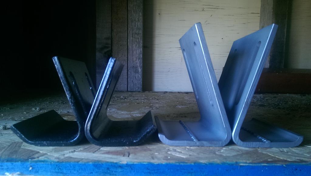

With the asphalt millings I would suggest using a steel edge again (my dad and myself have used car/truck leaf springs welded to the original edge last pic rear grader blade) but also investing in a set of skid shoes(not that hard to make as I have made some the raw metal in the pics vs the black T/WH which can still be bought from Toro) so yo can keep that cutting edge up 1/4"-1/2" above the millings surface when level ,reducing edge wear and surface media removal, Jeff.

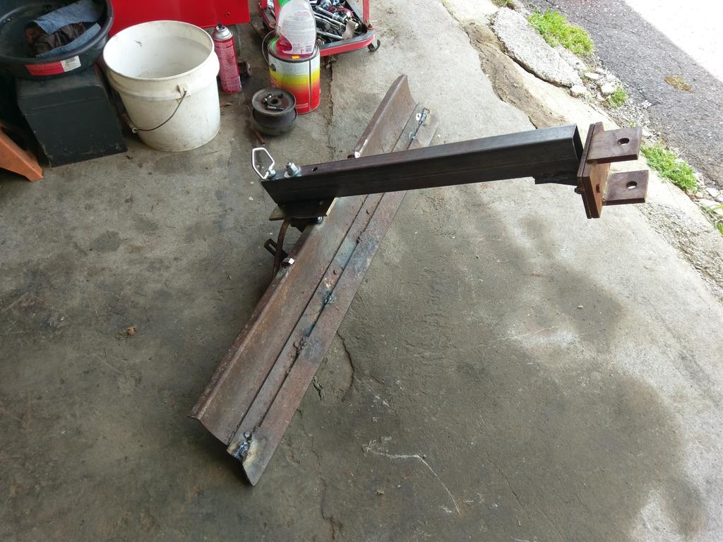

I think ill probably just use some flat stock with new holes. (i have some laying around) also any light sugesstions for my homemade weight bar?

my drive has a few cracks so I got an old tire cut to length drilled holes and mounted as a blade  works awesome
