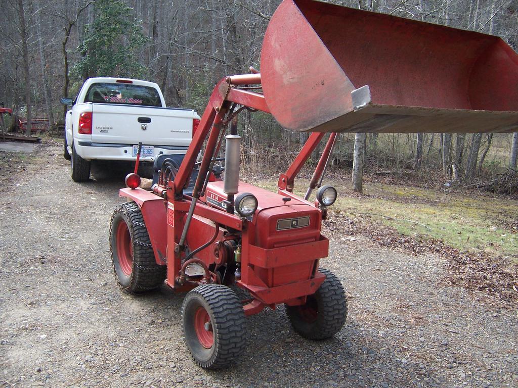

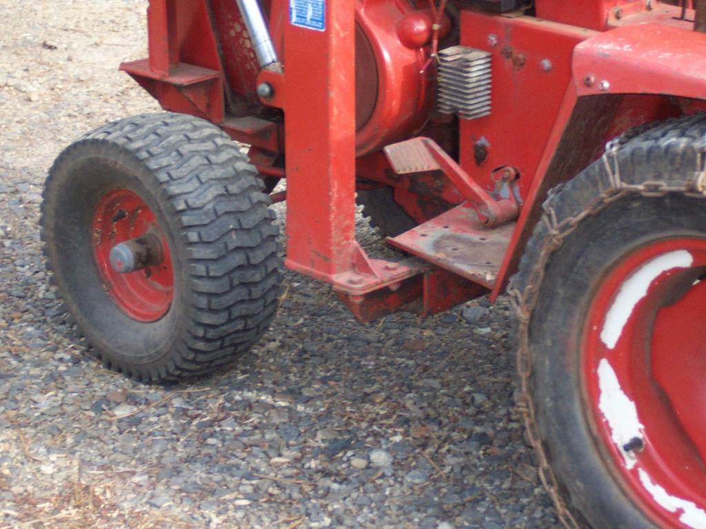

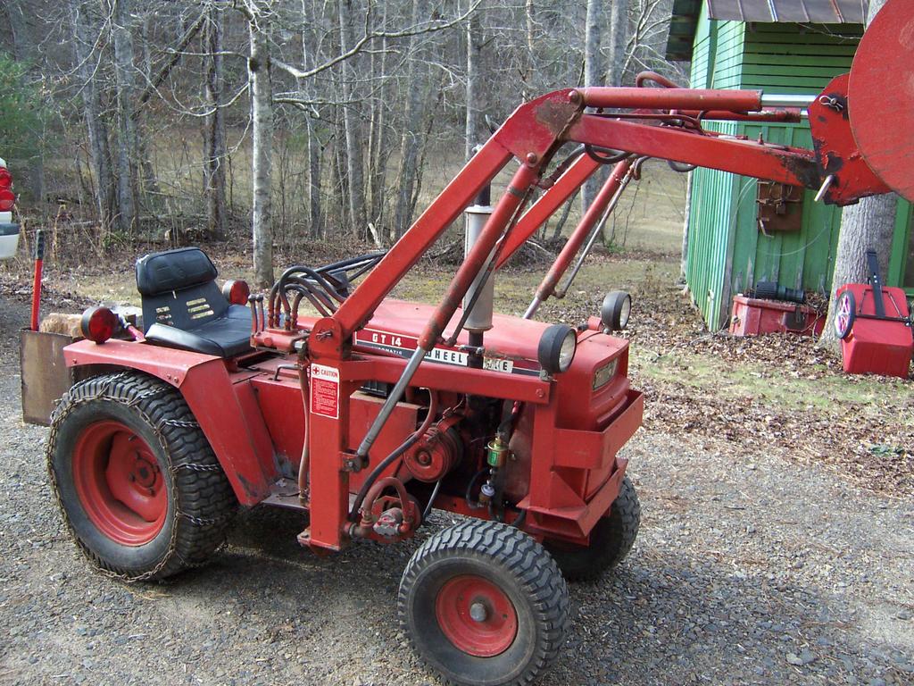

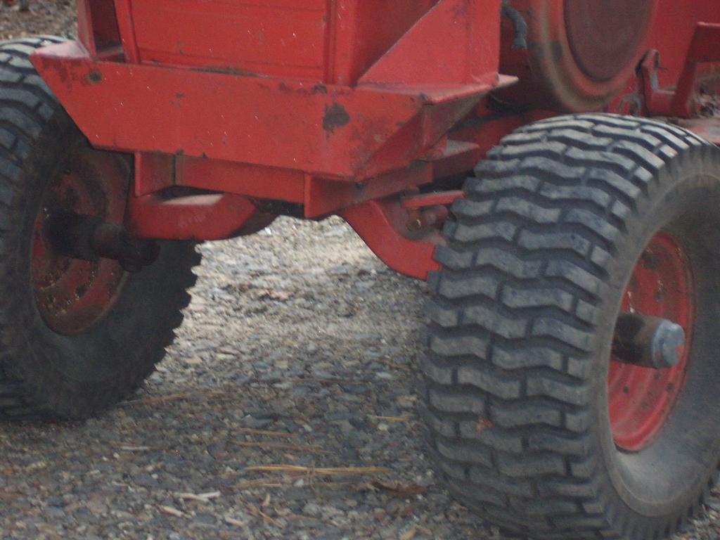

Unless you buy a tractor with a loader already installed there will be some fab work needed. Check out a couple of the threads on this site about installing a loader and see for yourself. Any good welding shop or farm machinery shop could do the job for you. take a look at the sub-frame on my GT-14 and you will see how it could look on your "D". It mounts under the frame and is bolted to it.
5990d1bf55aad_GT-14withFEL001.JPG.7dd5183bcf222bc52f7c7cbde8b729fa.JPG5990d1f0a966f_GT-14withFEL009.JPG.767fe0b5fdd72f41c4c4c4ce80e39700.JPG5990d20c090f1_GT-14withFEL005.JPG.7dbe49d66b9ebd0e6c588785531650c7.JPG5990d21ddfac8_GT-14withFEL006.JPG.93e1dc22f5bb21ec9d170b7767354bde.JPG
Firebug
So that looks like it attaches differently than I thought. I thought it had rails that follow along the frame rails but that looks like it mounts across the frame
