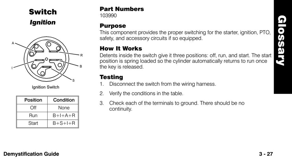

gwest_ca-(File Mod) 12,483 #8 Posted August 23, 2017 This one has been bugging me because there is an error somewhere. The wiring diagram above shows the pto switch powering the ignition switch B terminal when the pto is OFF. When the pto is ON the seat switch powers the ignition switch using the A terminal. If you look at the schematic of the 103990 ignition switch the position of the A and R terminals is reversed to what is shown in the C-Series wiring diagram. What am I missing here? It should be the A terminal that powers the ignition switch with the pto ON but what is it's position on the switch? Detailed wiring diagrams Garry Share this post Link to post Share on other sites
