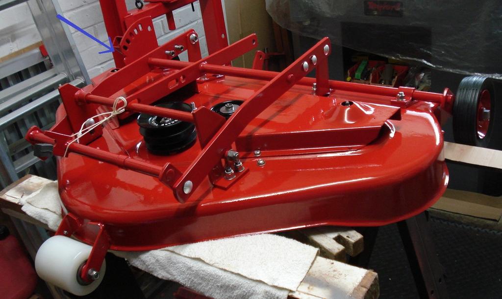

Just checked a 36" RD I'm working on and it's like Don (doc724) says, each increment raises or lowers 1/2".  On this one, the Deck is right on horizontal at the lowest setting measuring from the front Anti Scalp wheel to the Gauge Wheel(s). that sets the Blade Height to again as Don says  of 1"  and up to a max of  about 3 1/2" .
This Deck was found to have had the forward Limit Tab cut off (blue arrow), and so will drop down even lower than an Inch. not that I'll risk it, even though it has a Stop Bolt fitted (not visible)
