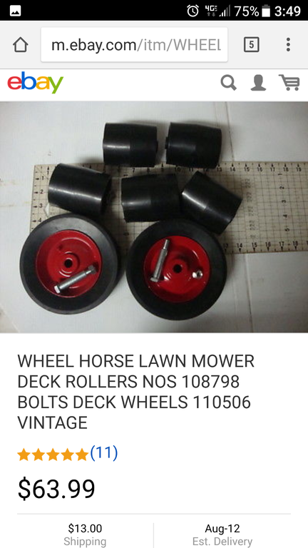

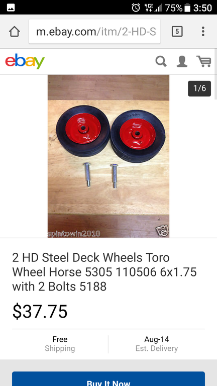

WVHillbilly520H 10,376 #2 Posted August 8, 2017 I use the original red steel centered wheels can be found on eBay as a kit with the axle bolts and also with the anti-scalp rollers as well, hope this helps, Jeff. 1 Share this post Link to post Share on other sites

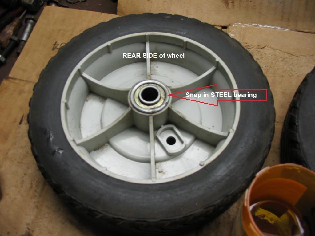

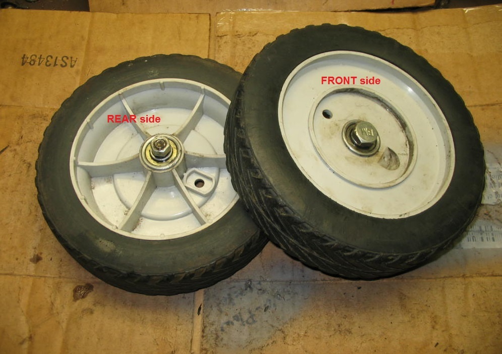

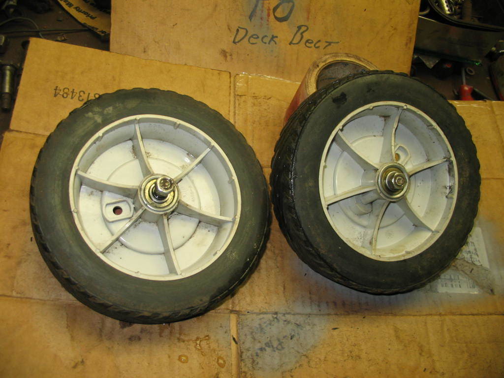

daveoman1966 3,788 #5 Posted August 8, 2017 I have a pair of ALL PLASTIC / NYLON (?) deck wheels that are 8" dia x 2" wide. OEM wheels are 6" diameter so these, at 8" dia will raise the deck by 1" and should give clearance for yard knobs... NOTE...these have separate replaceable steel bearings.... email to me at: daveoman@windstream.net Share this post Link to post Share on other sites

Mt Zion 520H 43 #7 Posted August 9, 2017 (edited) 4 hours ago, Aldon said: Just be sure that with larger rear wheels when you have the deck in the most high cutting setting that the center pulley does not impact with the deck hanger lift bar. You could grind off the grease fitting and damage the spindle. I've seen this on a few decks. Thanks for the tip brother. I will see if i can emulate larger wheels by putting an inch of something under rear wheels and see if it hits before moving fwd. 3 hours ago, daveoman1966 said: I have a pair of ALL PLASTIC / NYLON (?) deck wheels that are 8" dia x 2" wide. OEM wheels are 6" diameter so these, at 8" dia will raise the deck by 1" and should give clearance for yard knobs... NOTE...these have separate replaceable steel bearings.... email to me at: daveoman@windstream.net Email sent brother. cleat... Thanks for the washer, blade, thicker washer order brother. Seems they were put in the wrong way. I'll have to fix that next time around. Edited August 9, 2017 by Mt Zion 520H 1 Share this post Link to post Share on other sites
Mt Zion 520H 43 #8 Posted August 9, 2017 Anyone ever use those from tractor supply with the grease fittings? Share this post Link to post Share on other sites
WVHillbilly520H 10,376 #9 Posted August 9, 2017 The factory originals have a grease fitting, but are only bronze bushed but my first set on the one I bought brand new lasted 14-15 years, Jeff. Share this post Link to post Share on other sites
