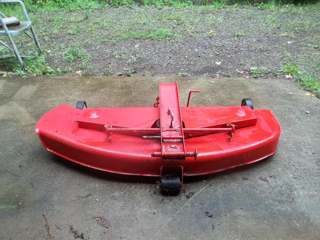

Would a 4 ft GT 14 deck fit on a 520 H
neil
I am curious to find out if the 4 foot GT14 Deck would connect straight to the same cradle as the 520 H or  is the GT14 deck on for that tractor ?
The GT-14 deck is the same one used on a '67 1267. The lift attachment would not be the same but you could bolt the lift cradle from a later deck to it or you could use a chain.
