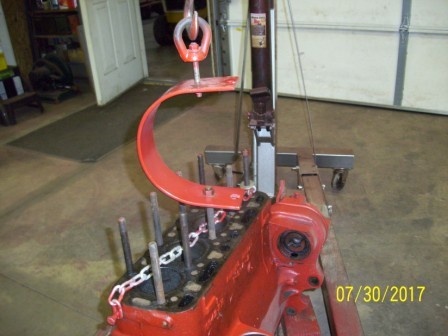

I am attempting to re-arch the seat spring. It has gotten to where when I set on it the seat rubs the fenders. By the way I am not over weight. 170# soaking wet.
I have a 250# engine block hanging on it. Didn't want to heat it as that would take the spring out of it. I measured it unloaded and loaded.  I am gong to leave it hang until tomorrow and see what happens.

My guess is no....250# will probably not reach the yield point of the spring.
But, keep us informed of the test results.

I am going to leave it hang for a couple of days. Then check my measurements. Waiting on a carb kit so I have a few days to experiment. I do have a 200# wheel weight I can hang on it.

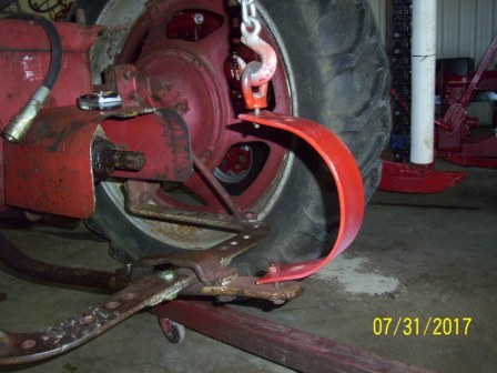

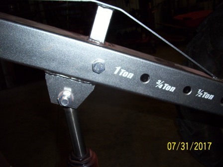

I fastened the spring to the drawbar of my Farmall H. With the hoist in the 1 ton position it began to lift the tractor. I stopped there as I could see something catastrophic happening. My advice is DON'T TRY THIS AT HOME !!

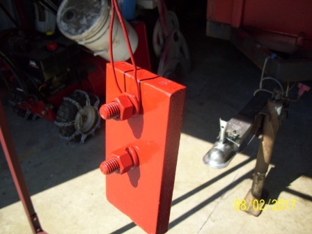

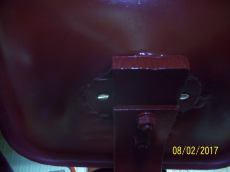

I went with spacers. 3/4" under the seat did the trick.  Thanks to all.:)

I made up and painted a solid spacer yesterday. In from the CBS paint booth and under the seat on the tractor this morning.
