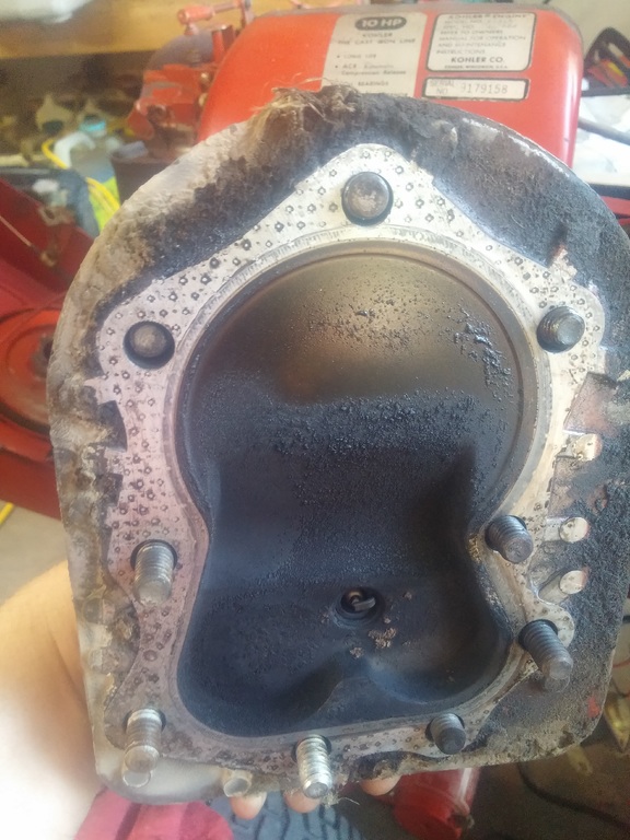

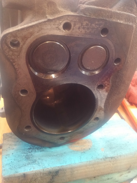

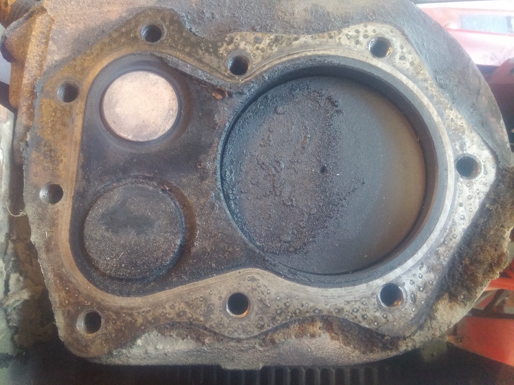

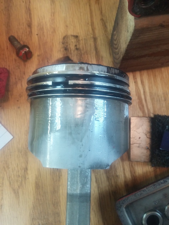

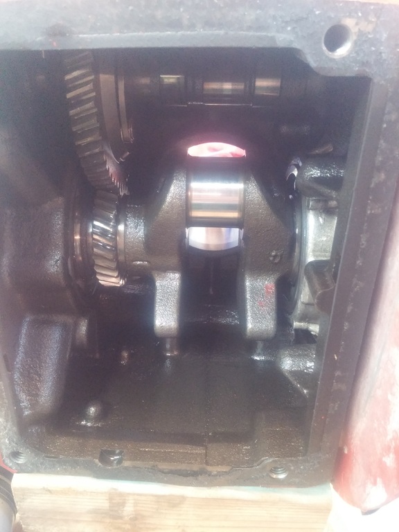

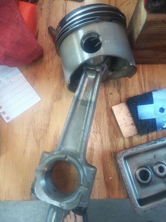

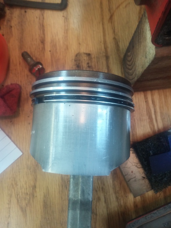

So the old Kohler K241 in my C-101 seemed to have developed a quiet knock once it got warmed up and under load.  Since, to my knowledge, it is the original engine and has not been touched other than routine maintenance, and I need to replace some gaskets because of oil leaks, I decided to pull it out of the tractor and tear it down and inspect it.  After putting a mic to everything the only thing I can tell it may be, is the rod journal on the crank, it is slightly out of round but I think still with in specs. Granted, I don't have expensive measurement tools, my micrometer is a dial mic and only goes out to .001.  So the crank rod journal spec is 1.500 and that is what it measures one way and 90 degrees to that it measures 1.499. See specs below.  I did check the valve clearance after tearing it down on both valves, The intake valve was good at .009 and the exhaust valve was over at .020 so I brought it down to .018, would the exhaust valve being over gapped ever so slightly have been the knock that I was hearing? At this point I think I am planning on honing the bore, installing new rings and putting it back together.
Here are the specs and numbers;
Piston  New spec. 3.2432" wear limit 3.238
My piston 3.240
Cylinder bore parallel to stroke
top 3.249
Middle 3.249
bottom 3.250
Cylinder bore perpendicular to stroke
Top 3.250
Mid 3.249
Bot 3.249
My Rod journal measured inline with rod length
1.500
Measured perpendicular to rod length
1.500
Crank rod journal spec
New 1.5000/1.4995
max wear 1.4990
Max out of round .0005
My crank rod journal
measured centered inline with bore (Piston rod at bottom of stroke) 1.499
Measured off set from bore (piston rod half way up/down stroke) 1.500
Like I said, my mic only measures out to .001 so the crank rod journal measurements are what may be in question at this point. But, even so, I don't see anything that explains a quiet knock under load after it is warmed up.

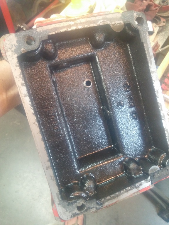

Any ideas?  Oh yeah, there was quit a bit of carbon build up on top of the valves, around the valves, on the top of the piston and on the cylinder head. Towards the to of the first photo you can see an entire ridge of carbon along the gasket surface between the exhaust valve and piston.  The third pic is the inside of the oil pan after just taking it off, that is how clean the inside of a 38 year old engine can be when it is properly maintained. You could have white glove tested it, I couldn't believe it!

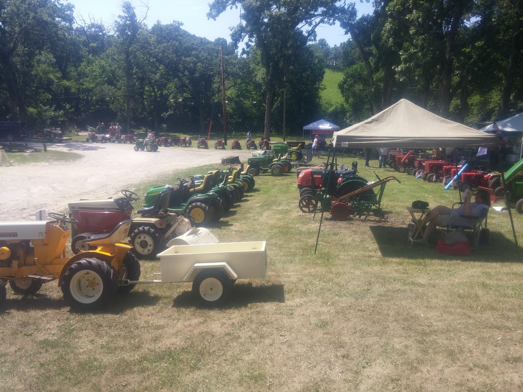

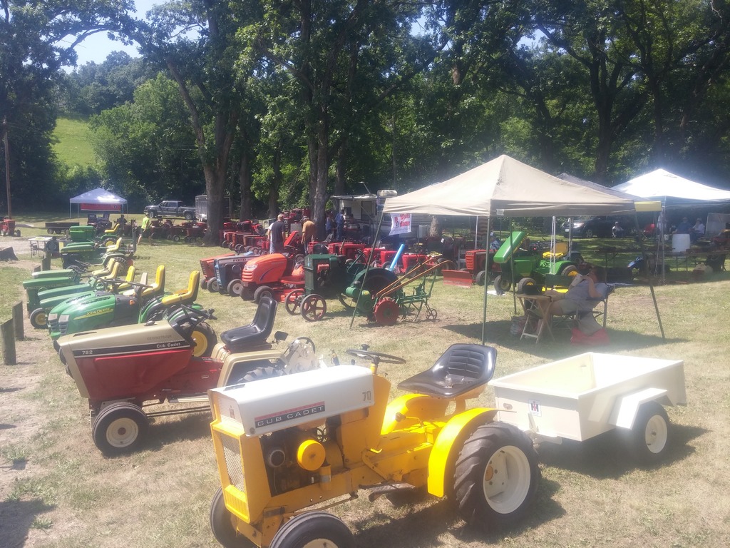

Took it to a show and swap meet a couple of weeks ago and had a great time, funny thing was is John Deere was the featured tractor this year and as you can see in the pics they were out numbered.  It was only the second year for this show.  It is held in Osceola, Iowa, and a couple of fellow Wheel Horse enthusiast got it started last year.  We had about 25 more machines this year, so it's growing.

The motor looks clean. That is not an original motor to that tractor, so it is not 38 years old. Could be why it's so clean!
Original Kohler for the C-101 woild hsve balance gears. Can't tell from the pics, but doesn't seem to have studs for the gears.
IF your micrometer is calibrated,  your measurements seem to be close to the wear limits...still good.
The slight knock may be piston slap. Nothing that a good hone, new piston and rings won't fix. Just my opinion  :handgestures-thumbupright:
Best way to check a rod and crank assembly clearance is to use Plastigauge. It will check the two components as an assembly, not just one piece.

Is there a technique one can do with plasticgauge that checks out-of-roundness of the rod journal? Also I have not found anywhere that says to use plasticgauge on bearingless rods like these small engines use.  Does one use it on these small engines like you would on engines with bearings?  This is the first small engine I tore into with the intent of rebuilding it.
In the case of small engines the rod is it's own bearing. I use two strips of Plastigauge, one on the bottom as shown in the picture and one running diagonally at the side, then torque the rod bolts, remove the rod and check.

Piston slap is generally more prevalent in a cold engine. Did you measure the piston at the right place as shown in the book? Slap rather than knock. I would also check the piston wrist pin, you cannot really do that with your .001 mic. I can tell the wrist pin by feel.  I would also take the crank to a machine shop and have them measure it. In your measurements you list a 1.5" crankpin measurement and a 1.5" rod size. That measurement cannot be correct, even if new. I do not like plastigage to check wear. It works great unless you are out of round. My limited Kohler knock when warm experience has always been excessive rod to crank clearance. Warning, if you replace the rod and piston assembly, if the new replacement does not weigh the same as the old, you will pick up some vibration.
pacer
Just my opinion here ----
Having read your descriptions and seen the pics of the engine, I would got to ebay and choose one of the - very inexpensive - 'rebuild' kits. (there are MANY of them) My guess is that you have some slight wear on your existing rod, with the crank being OK  (steel against aluminum). and a new rod would correct that, and you would have the benefit of getting the piston/rings along with gaskets, etc.
I have used several of the kits and found them to be perfectly good...
