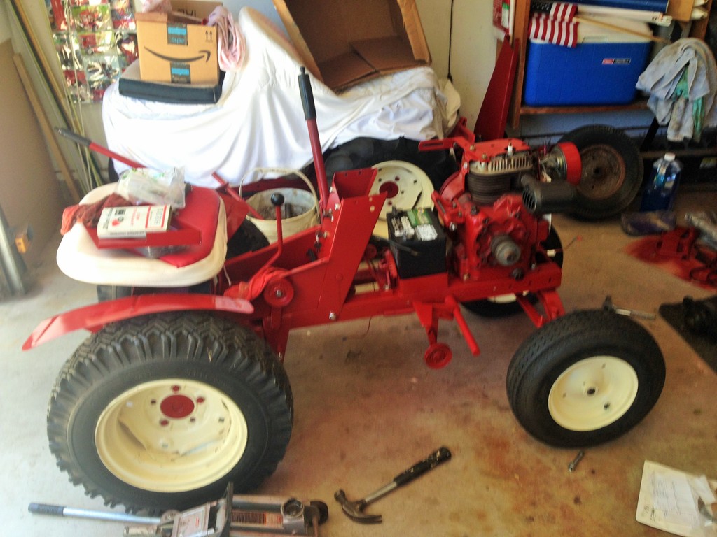

Lane Ranger 11,125 #5 Posted July 28, 2017 (edited) Carlos: 702 Manual is right here on Red Square: I am in the process of rebuilding a 702 right now ! Edited July 28, 2017 by Lane Ranger 3 Share this post Link to post Share on other sites
carlosking450 155 #6 Posted July 28, 2017 OThanks Lane, ohhhhh very nice I also have my 702 completely dismantled, I'm going to repair the gearbox and start riding, you have to see how small these tractors are and how much work they have As soon as I have time I will continue to put photos of my restoration in the section "restorations" a greeting from Spain. By the way is there an economic distributor for the replacement of bearings and seals for the gearbox of the 702? Thanks from Spain 1 Share this post Link to post Share on other sites
