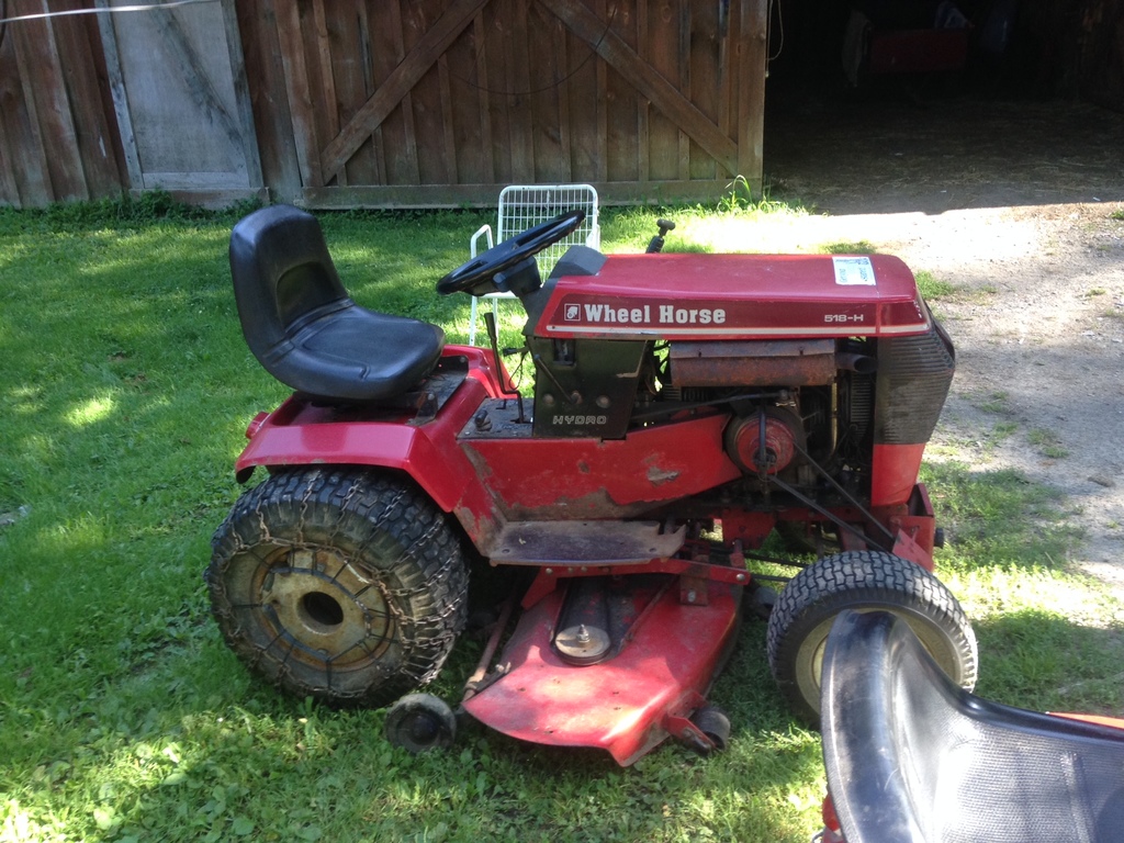

RandyLittrell
There is a serial number on the dash under the steering wheel. Post that and we should be able to tell.
RAndy
Ed Kennell
'88 - '89
1988 518-H
Evil Archer 300
Thanks For The Answer
31180EO1   1OO862
Model number 31-18OE01 is the way it is written with a dash
18 = engine hp
O = Onan engine
E = Eaton hydro transmission
01 = numbers
Too many digits in serial number 100862?
Possibly should be 10862
