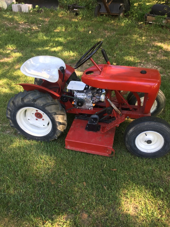

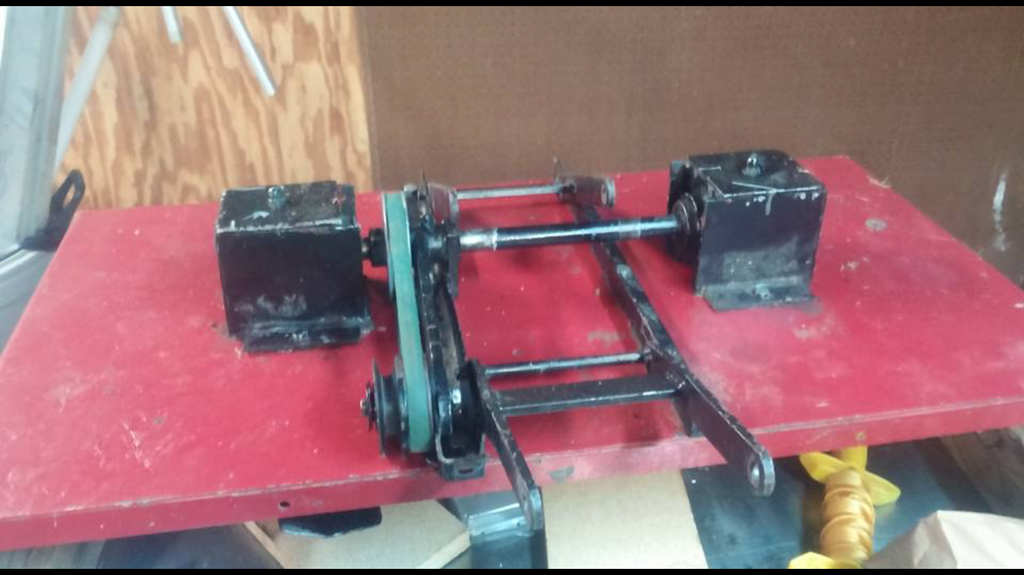

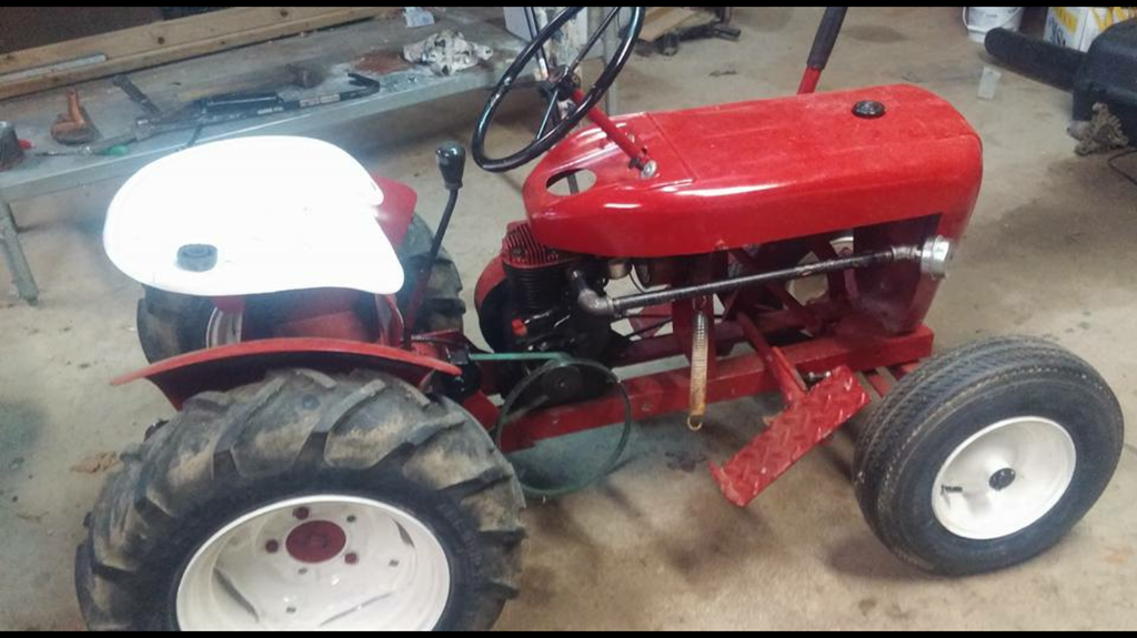

Help correctly hooking my belt drive up to my mowerIMG_2329.PNG.fe78bb9f64b7a50dbad2818f45da255d.PNGIMG_2332.PNG.32ac4260efaf3a94a05ef7d2a98749e7.PNGIMG_2343.JPG.278116ebd18757b49bac176c35ffcb7a.JPGIMG_2345.JPG.3e657182a6c14ae886a6f48474d28ff5.JPG

Yes I've read this manual but if you notice the manual shows a foot pedel on the deck to engage the blades where I have different setup on the opposite side
There are 2 manuals in the file with the same model number for both decks. I believe the first is a later version like you have.
The only thing I don't see is the item 10 clutch link shown in the first manual. It should pull the idler pulley forward which would tighten the belt. The link the pulley is connected to pivots around the mower drive shaft so the tension on the rear belt would not be affected.
I could be all wrong because I have never seen this setup.
