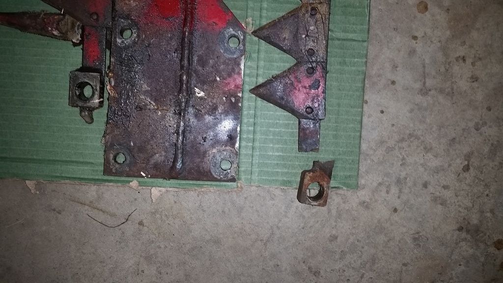

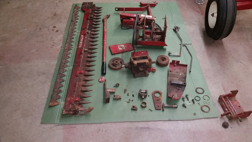

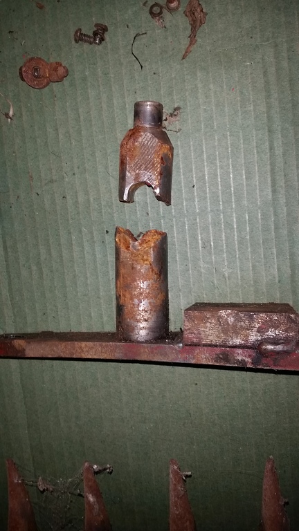

Note the broken weldment.... the only thing wrong and should be fairly easy to repro. Couple of tight idlers and no grass bar but again horse play.
Bonus.... front attachamatic and a bolt & washer for a deck blade :woohoo: :lol: ...extra pully too?!?!? Jeepers cats just noticed the front axle pin in my pic... another bonus.
Gotta love it when implements come in a plastic tote of parts!
Extra blade ... broke but fixable and worth the extra cutters.

Achto
A little time in the machine shop & we'll have that thing working like new. I wonder if that will fit on any of your round nose tractors?
Edited by Achto

JayB

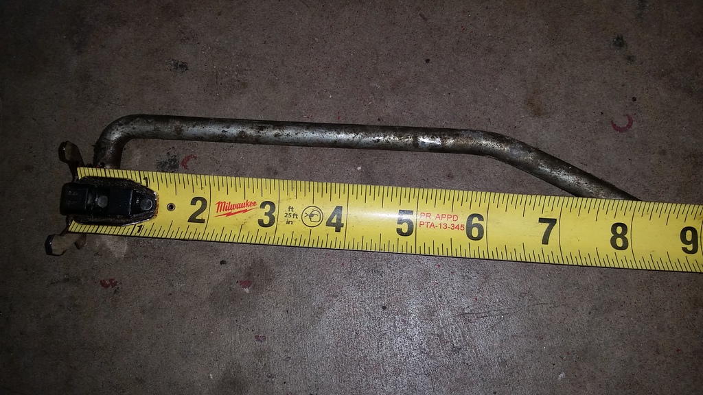

Looks like you got a winner.  I have a similar unit and the Weld met broke, welded and broke again.  I have a second one and another member who is a machinist is about to make a reproduction.  Also could you do me a favor and give me the dimensions for the rod used to lift the unit.  Interested in the two long length measurements and the angle they are set at.  I see the configuration otherwise.  That would be helpful in that I do not have that part.

WHX??
I'll see what  I can do Jay. I was happy to see that in the box as well as the travel rod. A almost 50 yo attachment has a way of losing parts over the decades. Should be easy to make. Seems the weldment was a weak spot in the design. When you look at the stress on that part it's no wonder.I had thought about welding and re machining but scrapped that idea when Achto said he would take a crack at making a new one. After further cleaning the only parts it appears I will need are the bottom bronze bearing and the two oil seals. @Shynon forwarded me some notes from @dclarke on these and are very helpful. Let us know if you might find them useful.

Achto

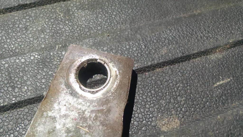

After looking the part over I found that some one had put a Helicoil in the threaded hole. Instead of just making a new shaft and welding it in, I'm probably going to remake the entire part.

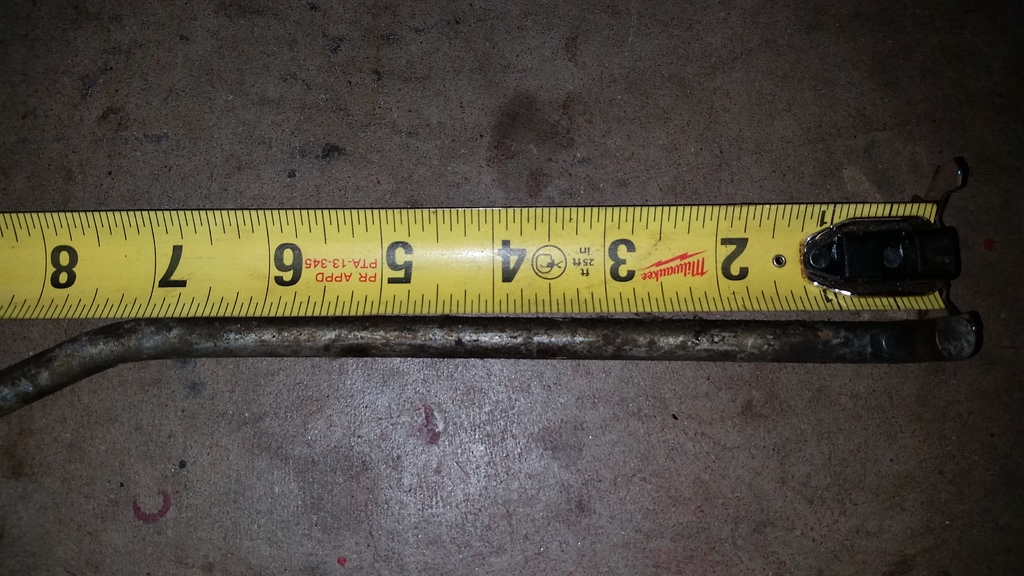

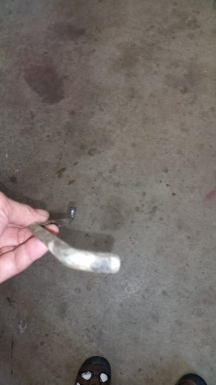

WHX??
Here you go @JayB angle looks to be in the neighborhood of 140 degrees
The side facing the camera is the 6" length.

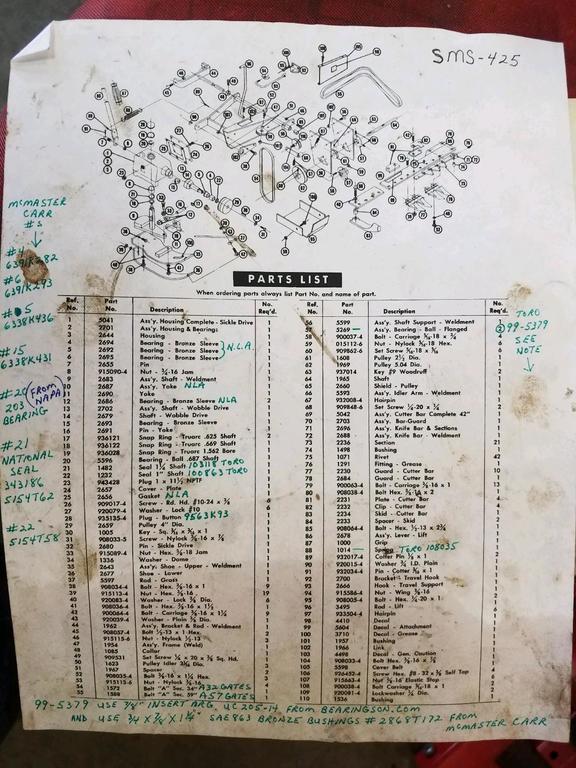

Also here is part  @dclarke's notes on it. This is for an SMS-425 but most of the part numbers are the same. Might want to double check. Save the pic to your desktop and zoom in for a better look.

If someone could throw up a pic & measurements  of the 2685  grass rod I need to make one of those. The SMS looks to use a 5597 grass rod ?:confusion-shrug:
Went looking for the lower seal on a :text-google: search and found this right here. The amount of help right here on RS never ceases to amaze me!

Achto
@WHX11 I grabbed a pic to show the Helicoil repair that was done.

Thanks Tom never fails to amaze me on what all he has.  I never tried to thread the pin in there Dan it was all disassembled in the box. Maybe we should check the fitment and if it's ok Loctite it in there. Save the time of making the whole part?
Shynon
Make It now or make it later, I don't think Loctite will hold up. You'll understand the first time you start the mower. :twocents-02cents:
