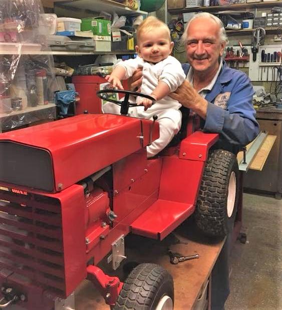

Alan R. 316 #57 Posted October 14, 2017 Various ideas were tried out for the seat using bits and pieces lying around and then discarded. A visit to a local upholstery shop with measurements resulted in a lottery win quote. Back to head scratching mode. I had already spent hours looking for something suitable on the internet without luck, trying various search word combinations. Then I spotted some cheap-ish scooter ( Lambretta / Vespa ) back rests. Not exactly what I wanted but worth a try. A pair were bought and after initial, not sure thoughts, the end result was better than expected. The fill in piece behind the seat cushion, made from plastic, still needs finishing off with padding. The first mock up from ply. The alloy frame, ex green house, just cleared the top of the gearbox. Fixing brackets were bolted on. Sheet steel was bent up for the base and back rest. There were two short threaded studs already fitted which made mounting easy. A length of U shaped trim finished off the steel plate and a similar section was fitted to the fuel tank. I finally managed to get my Great grandson Henry to try the tractor for size. Even though he is only 7 : 1/2 months he loved it. Mummy said she had never seen him so excited, squealing and swinging the steering wheel. We had to hold him though as mummy refused to let me cable tie him on. 6 9 Share this post Link to post Share on other sites
19richie66 17,560 #58 Posted October 14, 2017 Last picture says it all! Phenomenal work. 4 Share this post Link to post Share on other sites
elcamino/wheelhorse 9,360 #59 Posted October 14, 2017 Let him grow a little more and you two will be fighting over who gets to drive the D. A great picture. 2 Share this post Link to post Share on other sites
