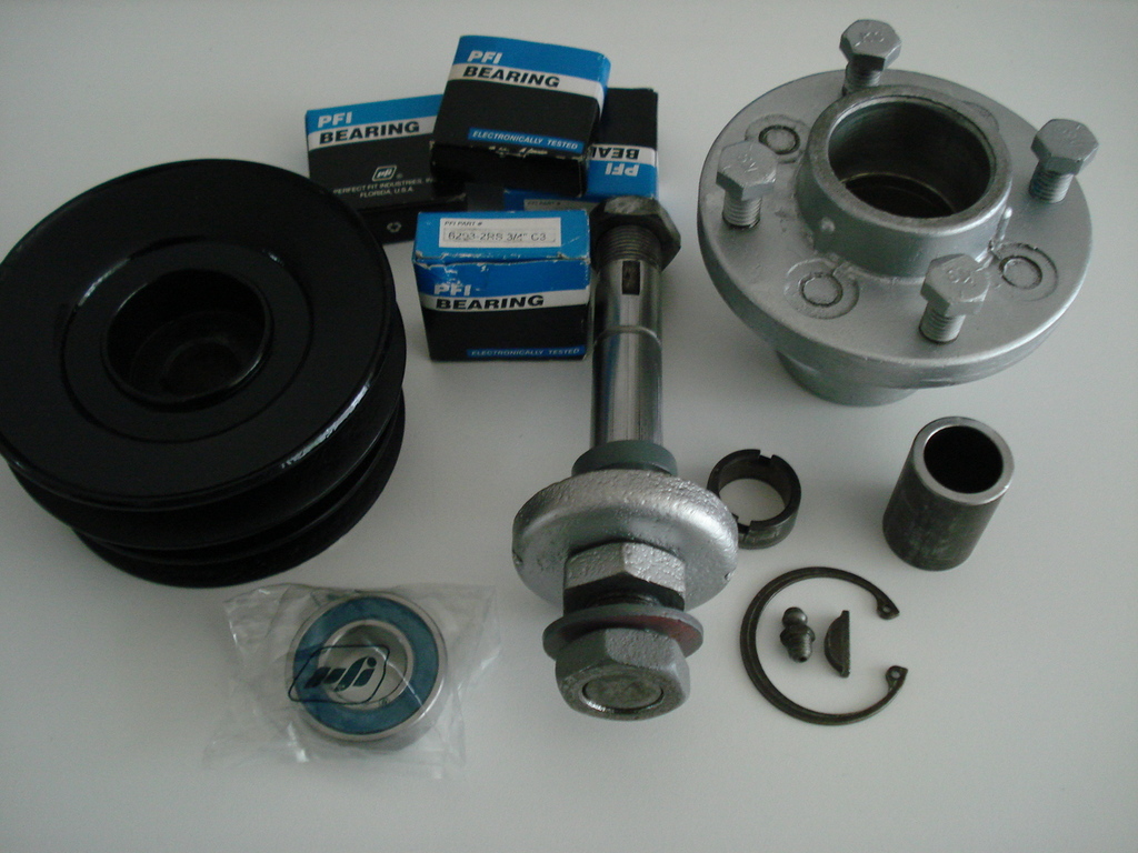

Anglo Traction 761 #1 Posted July 15, 2017 UK based- In the process of refurbishing a Deck (05-36MR01) which is covered in a thread in this -LINK- . I decided one of the Spindles (centre) had the slightest sign of resistance, so I pulled it apart. It was a mess in terms of botched workmanship/treatment in the past and took a lot of refinishing of the spindle etc. Anyway, I have now received my new Bearing stock (yes- made in USA) and all parts ready for re assembly- So before I proceed, I would like to know from seasoned Deck Refurbishers, Do you remove one of the 2 shields so that the original greasing system can be employed, or do you fit them with double shields in place (sealed for life) and blank off the Zerk points?......(I could not obtain single shield bearings). Also, I did search for answers on here, but found no relevant Threads on this. Thanks in advance. Share this post Link to post Share on other sites

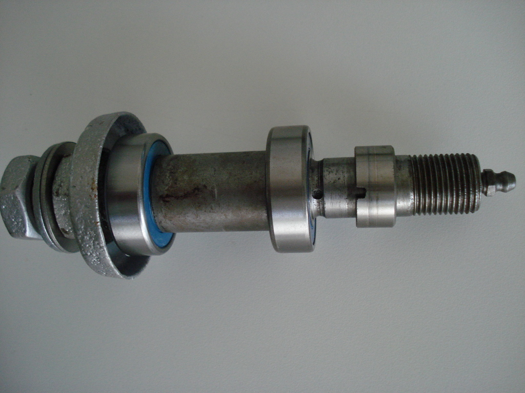

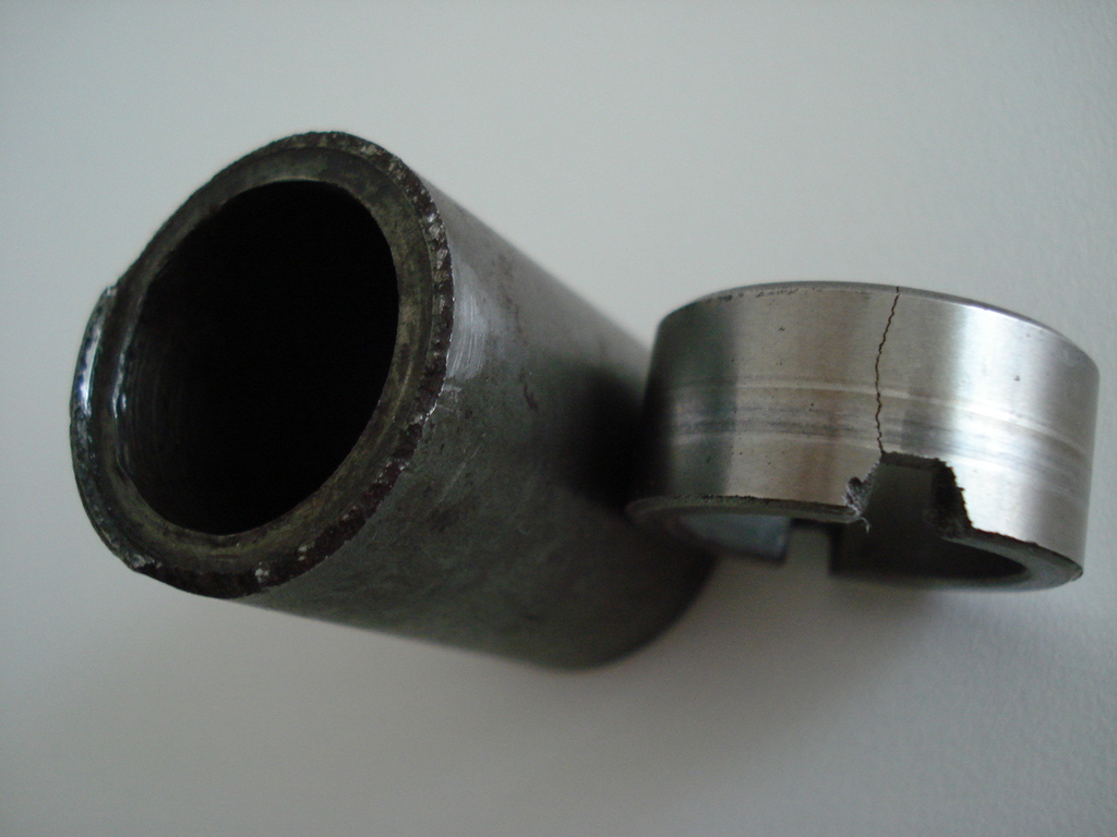

Anglo Traction 761 #8 Posted August 1, 2017 (edited) Reluctant to resurrect this thread, but it may give some clarity to the potential issues with only removing the INNER Shields on newly fitted Bearings. I found that I had to pull one of the other Spindles on my Deck Refurb due tightness when torquing up the Pulley Nyloc Nut. While doing so, I wanted check and photograph the layout of the Bearings in relation to the Grease channel or annulus, also the need for the Upper Oil Seal Shaft Collar to be correctly fitted with the cutouts next to the Bearing- Clearly, as can be seen, the upper New Bearing MUST have BOTH Shields removed to allow the grease to pass through the passageways and Shaft Collar cutouts. It then passes through the Upper Bearing Race into the Chamber and to the lower Bearing (1 outer shield). So if you want to continue greasing Spindles after a Bearing replacement, check the assembly and pull both of those Upper Shields Components on this Spindle have had a hard life and mistreatment. I found these defects- I've got to make these components, as finding these parts in UK are like Unicorns and fortunately, I have the machines and materials. I'm on the lookout for a Spindle Assembly for this Deck as a Spare if anybody has one and prepared to ship to UK ?....... Edit ...prayers may have been answered, think I have found one. Regards Edited August 1, 2017 by Anglo Traction Share this post Link to post Share on other sites
