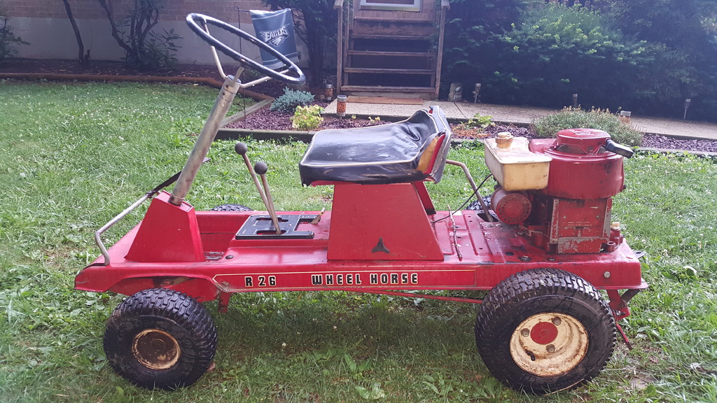

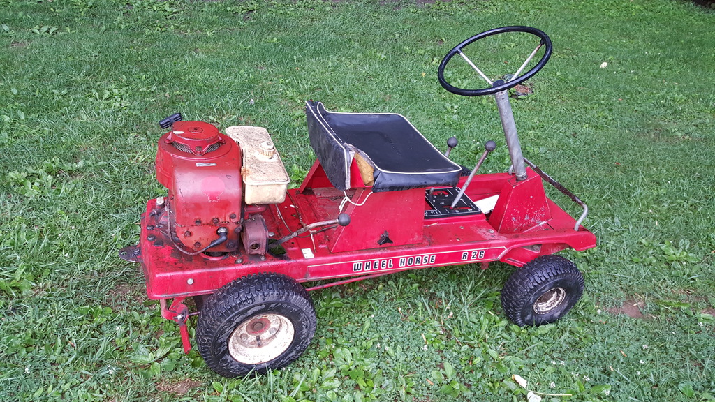

Hello All. Picked up this little feller here a couple days ago and just got around to wrenching on it last night. I cleaned up the carb, put a new plug in, new oil and fuel, and it doesn't want to fire. Checked the spark and I don't see anything.
Ran fine 2 years ago the guy said and I have every reason to believe him. I guess I have two questions:
1.) What is on this, magneto? Where can I buy one to replace?
2.) I have a Trailblazer 7 with a 7hp Tecumseh pull Start. Think I can pull that magneto off and use it? (Assuming it is indeed a magneto).
As always, Thanks for the help!!

It does have the magneto ignition. Before assuming the mag is bad,  clean the points. They're probably oxidized from setting.

I think the points and condenser would be the place to start.

At the risk of sounding like a water-head, where would the points and condenser be on this? It's definitely not like a k181 or k301 where the points are on the lower left under the governor arm. I'm thinking the points are on the magneto under the blower cover about centerline top of the Flywheel? Not sure it would even have a condenser if it's a pull start? I'm no mechanic, feel free to set me straight if I'm talking nonsense. I love to learn.
Howie
The Tecumseh does have a condenser under the flywheel along with the points. A bad condenser will not let it fire. If you get in there and the magneto
is held down with two bolts and if moved it affects the timing. Points can be changed without removing the whole unit.

As usual you guys were spot on. Dirty points was the culprit. I have to be a straight shooter and admit it took another RS Member to get in there and give them a proper cleaning before we had her sparkin away. So thanks Josh!
