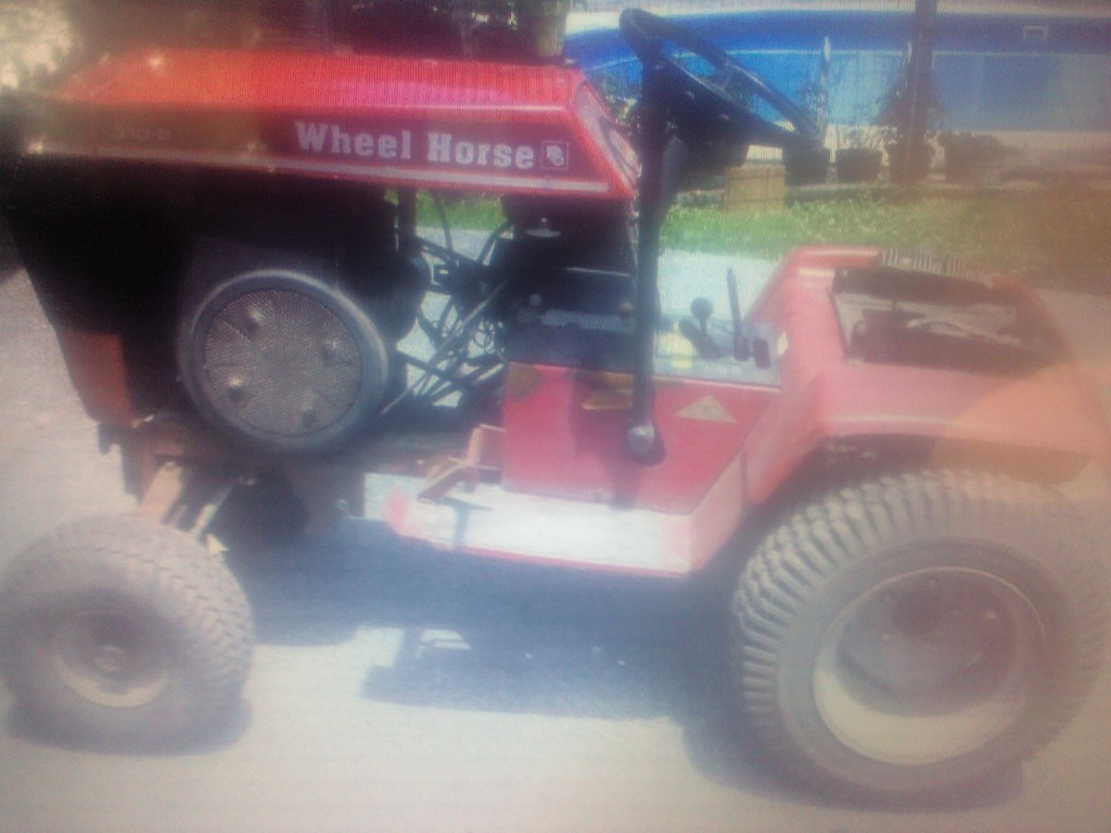

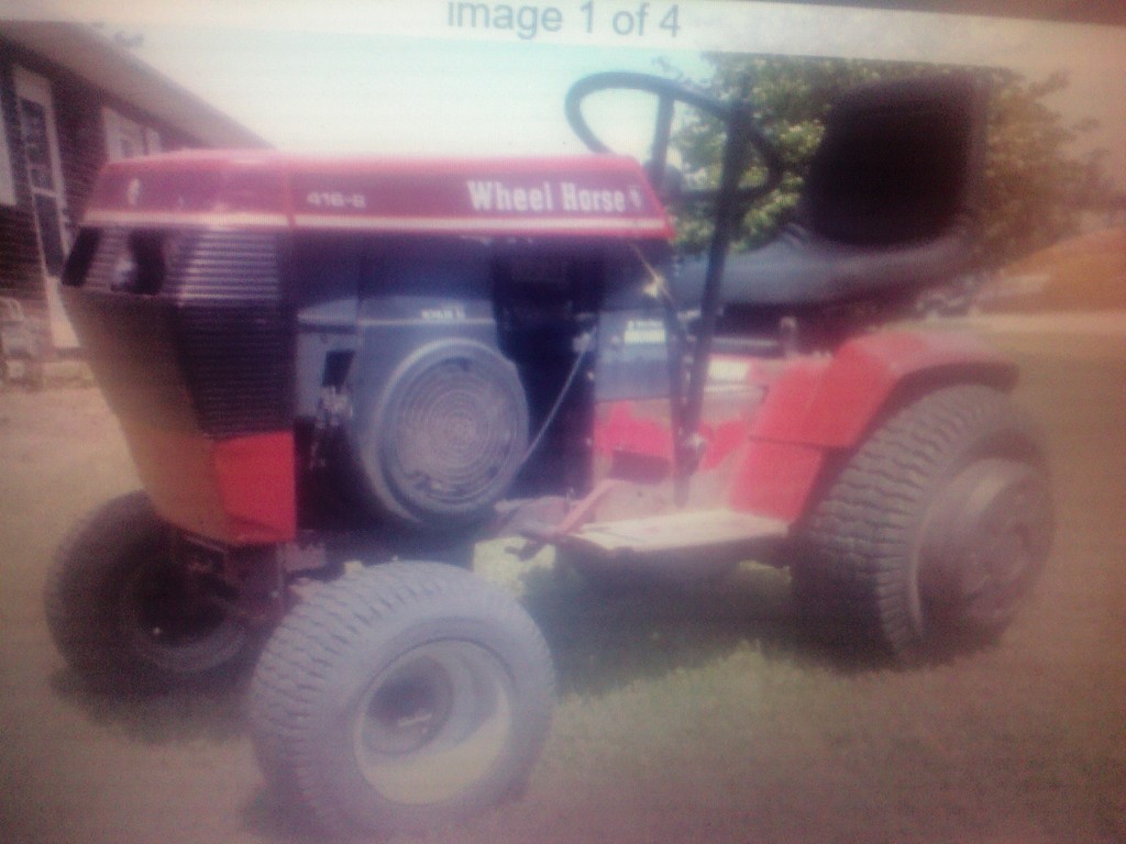

0705171707.jpg.779303edd6a413e1497ecab7a572dab9.jpg0705171708.jpg.a0c206b11e91d48af8e5b0bfd26438fa.jpgHello, I'm still a Newbie , Big Red Fred here, i have a chance to buy a 416-8, very rusty, the Hi/Lo is stuck in Hi, i wrote about that before and still hesitant buying it, he wants 425.00 no deck, but i found a clean 310-8 with bad motor, is it possible to swap motor & front axle out with the 416-8 ? He wants 125 for 310, Is the frames different on 310 to 416 ? Or can i just rob parts off 310 to refurbish 416, are the rears the same too ? Or should i just buy a 416-8 in better shape ? To me it takes the fun out of taking a neglected Tractor & turning it into a Eye Catcher & Neck breaker, Wow did you see that Horse ! Thanks Guy's for any Help ! Big Red Fred

Pictures are kinda fuzzy Fred but pretty much means the tranny has to come apart. No big deal for me but might be for others.  I would not go for it unless he came down....quite abit. Too much cash out lay upfront for a tractor you might plan to stick some coin in.  There are better deals out there waiting to be made... especially in your area. We do appreciate  your wanting to save a neglected tractor tho! :handgestures-thumbupright:

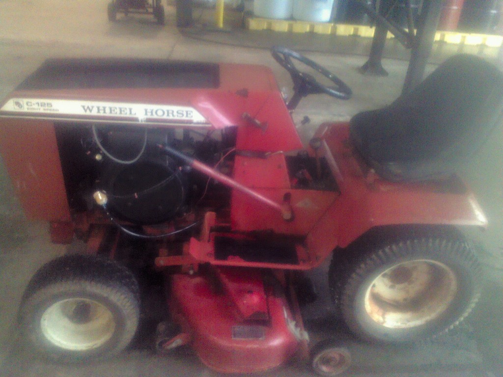

Well i did it, a Young Man showed up at my shop with a C125, i will start a new topic on the tractor, thanks for giving me advice today 953, wish i was at a tractor show instead of sweating the years off under a dump trailer ;-)  Oh i paid 200.00 for it, heres 1 pic0707171756.jpg.912f3a6c8742cfe60d009768bd3b811a.jpg
