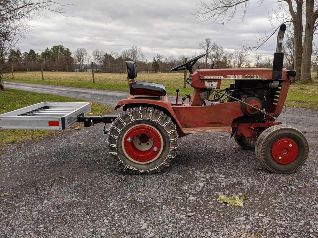

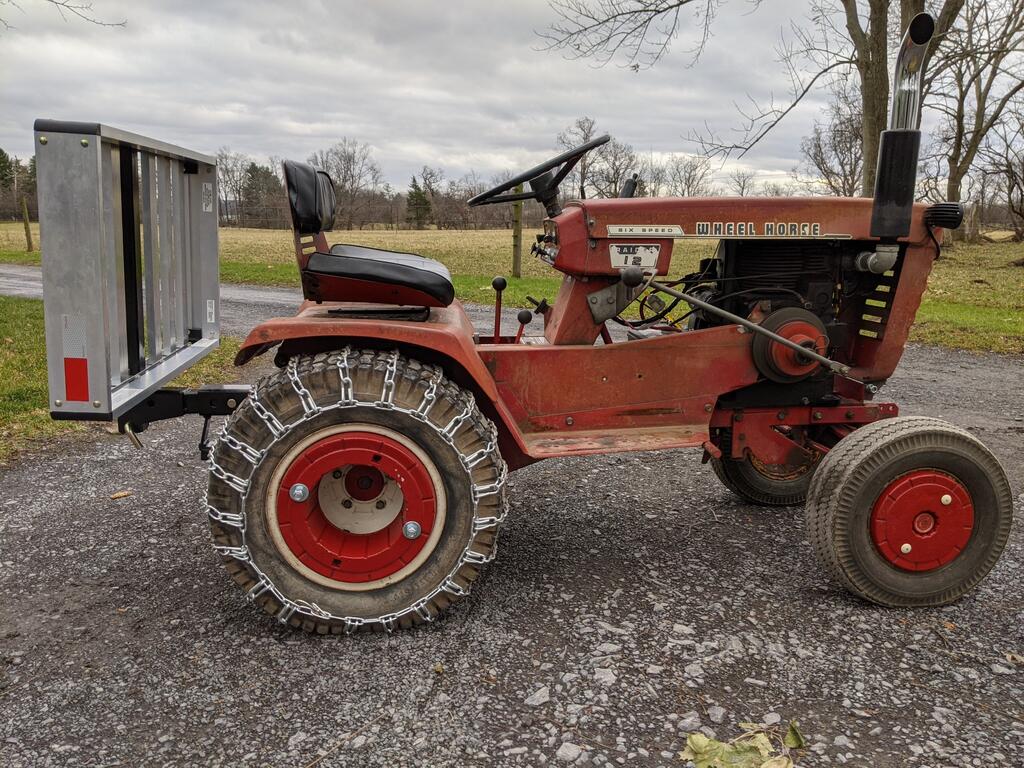

Not really custom, but added this to the Raider 12 instead of having to get the trailer out every week for hauling trash and recycling down to the road. It was 5 foot wide, but I cut it down to the width of the tractor. And it folds up when the tractor is parked. It's pretty handy and rated for 500lbs.
Excellent idea. Good for carrying tools or whatnot as well.

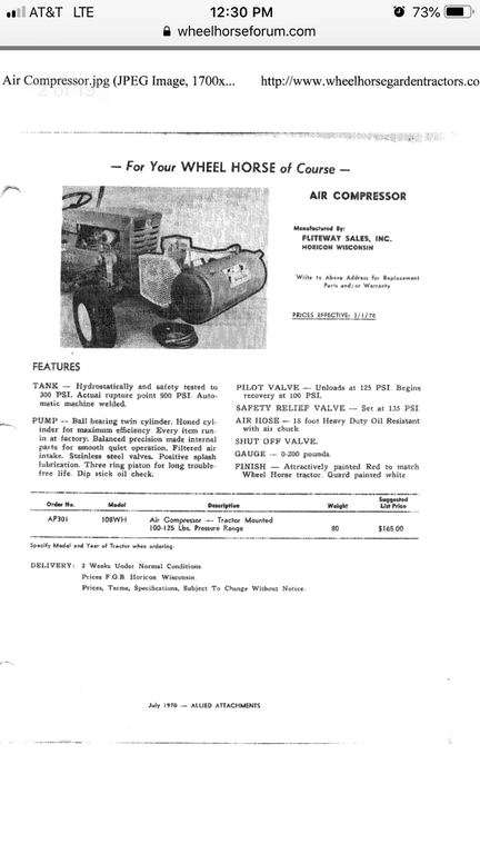

I have 220 in 2 buildings but not everywhere I need it AND there's a limit to my amps.  I don't need large CFMs most of the time except sandblasting so even a smaller compressor would help but why not go as big as a WH can power?  I've used and read about converting V8s to four cyl engine pumping air out of the other four so I'm sure we could use a single or twin cylinder engine as a compressor.

I've always wanted a BIG air compressor!  I could drive one off my NH PTO but how about a WH front mounted like the generator?  16-18 HP should crank out some CFMs.  Just mount a purchased compressor or what about converting an engine to a compressor.
I like the idea as well.  I've got an old air compressor that is set up for gas power with a pressure operated bypass valve, but had been converted to an electric motor by the PO.
Halfway there, I guess.
You guys figuring on mounting a tank as well as the compressor?  Maybe a 100 gallon on a trailer, so it looks like a mini anhydrous ammonia tank?

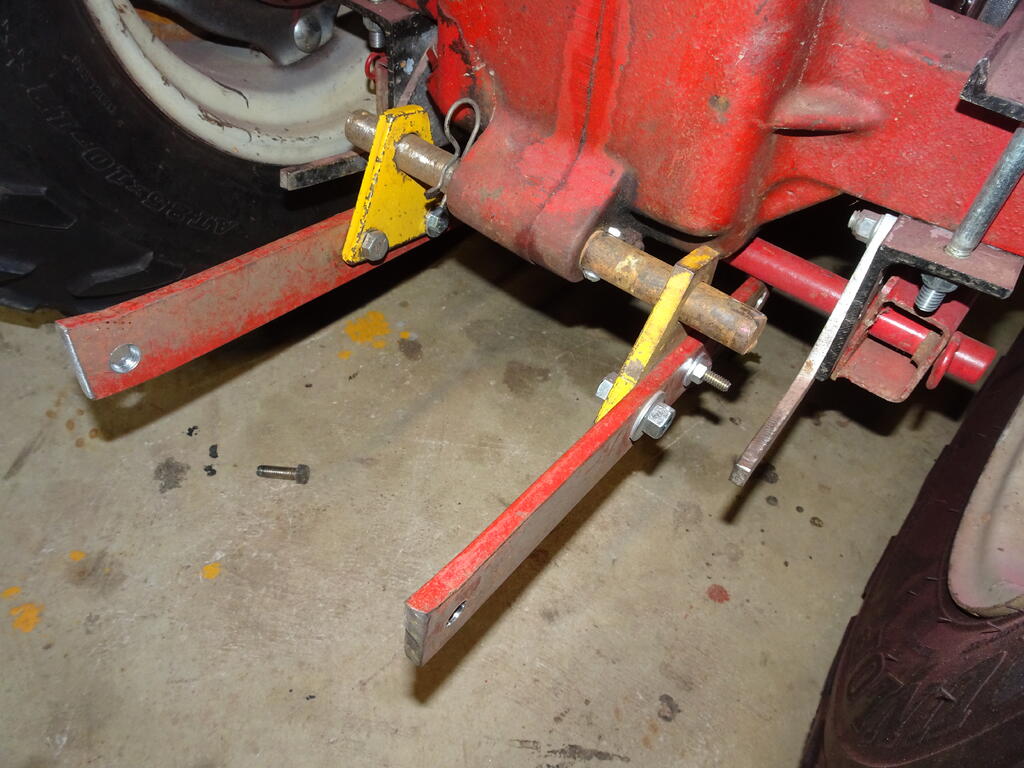

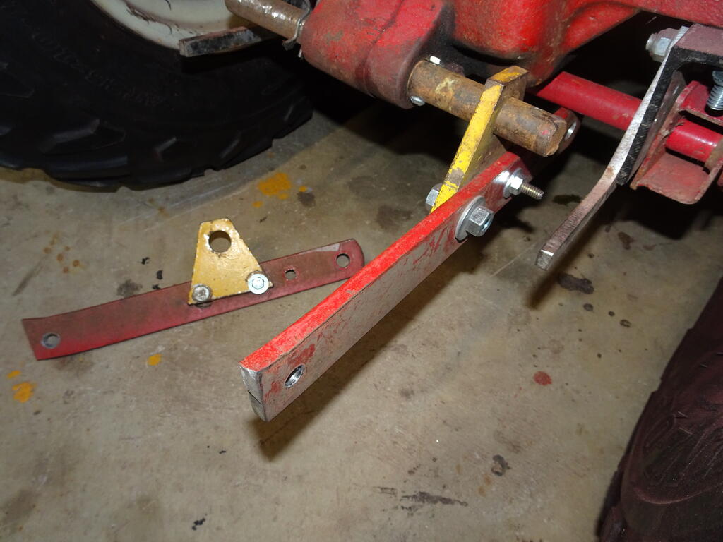

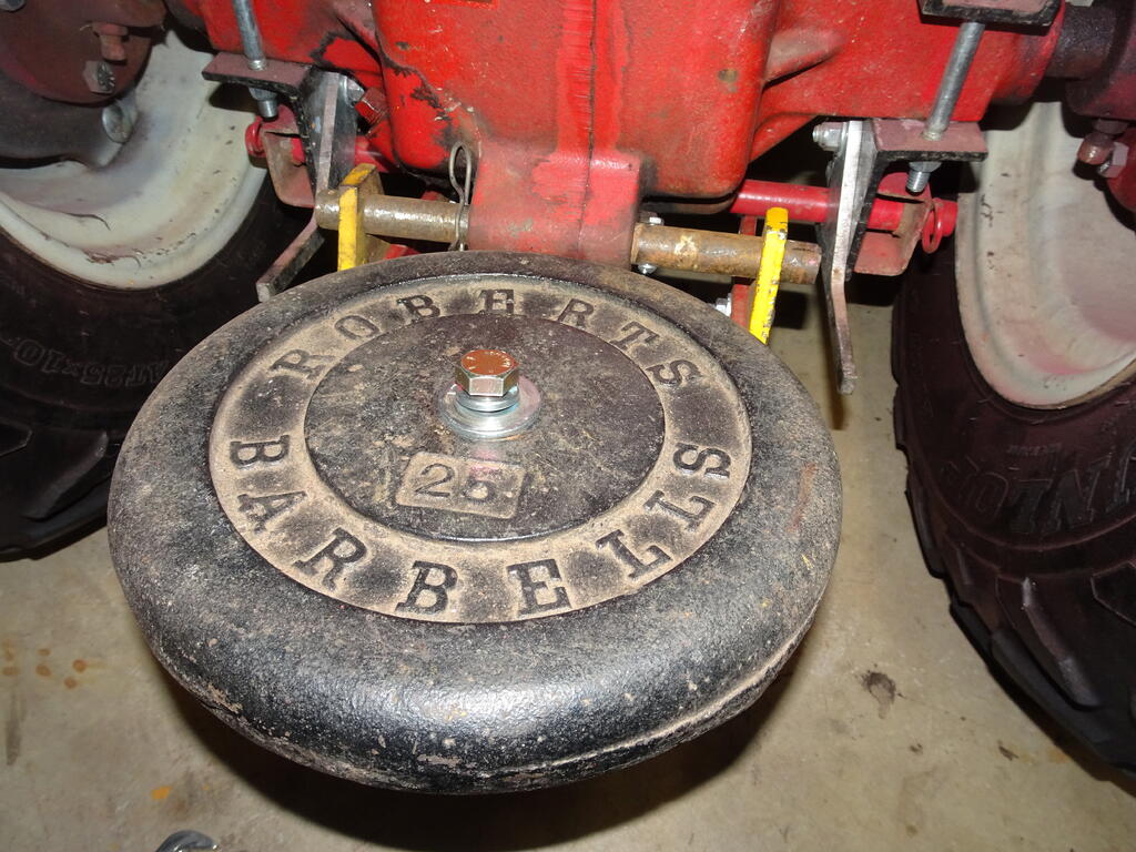

Weighing down the rear hitch applies pressure to the underside of the transaxle case and could crack it. With this simple lever the pressure is applied to the crossbar of the rear snow plow hitch. The pressure is then distributed to both ends of the axle casing. Not just for stacking weight for traction or counterbalance I'm sure it can be adapted for other attachments and uses.
Notice, comments to this post prove that my premise is wrong. This lever does not transfer weight to the snowplow cross bar. The weight is doubled on the transaxle drawbar.   Do not use
Edited by giddyap
correction
Agree with your premise of risk where a small area of the transaxle is getting a lot of pressure from torquing the standard drawbar hitch. Would add a caution, though, that your solution also has risk. It puts a multiple of the weights in your rack as downward pressure on the rear hitch crossbar due to the leverage being applied.
The multiple comes from the fulcrum of the lever being the point where it contacts the plow frame bar. The transaxle bar is roughly 6" along the lever and the center of the weights is roughly 12". So the down force on the transaxle bar is roughly twice (12÷6) the weights carried even though the down force on the tractor as a whole is only the weights and rack. Also, if the hitch holes are misaligned the force could be disproportionate on one half of the casing.
I have no idea what the max recommended weight on that drawbar mount is, though someone else here might.

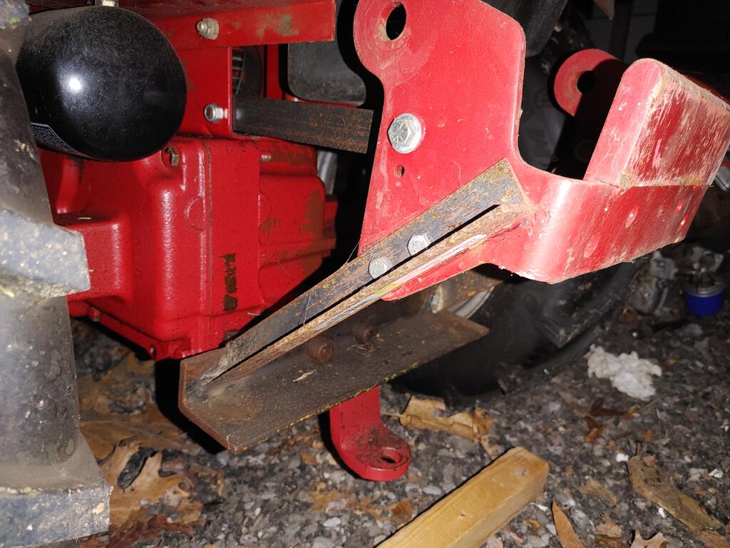

WVHillbilly520H
One of my owner's manuals for the 520H says do not too over 275 lbs in a yard cart which doesn't say tongue weight, but I am quite sure I have exceeded both many times over with wet sandy soil over flowing the big 17cf utility trailer for 1/4 mile hauls, I have my current snow blower counter weight bracket mounted on/through the drawbar hitch casting with approximately 130# hanging there. I won't say I abuse my tractors but I don't baby them either.
Handy Don
Wow, 275# is pretty conservative, though that may be partly a limit for safe drivability and braking, etc. so a tongue weight of less than 100#?
My rule of thumb for damp sand and soil is 100# per cu ft. so yeah, no babying there!
Your counterweight is not mounted on a lever, though -- its pretty much a straight down load (helped a bit by the bar to the upper tranny bolts) similar to tongue weight on slot-hitch. Your 130 would be 260 or more with the lever mount.
