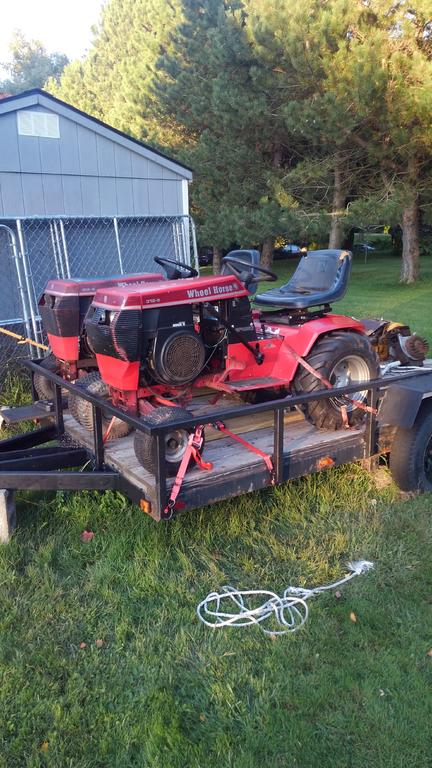

Tanker toy 1 #9 Posted December 11, 2017 Twins. Ready to rock and roll. 1 Share this post Link to post Share on other sites
Notfishin 64 #10 Posted December 13, 2017 Looking good . Share this post Link to post Share on other sites
