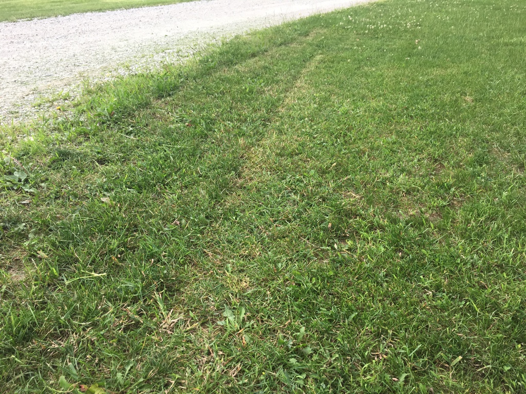

I'm used to messing with the narrow, rear discharge decks. The deck on my newly acquired C165 doesn't seem to cut evenly with multiple passes. It cuts great with one pass but if I make a second pass the grass is super uneven! What do I need to adjust to make it cut consistently? Here are some pics after 2 passes, in the same direction

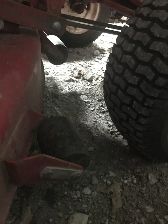

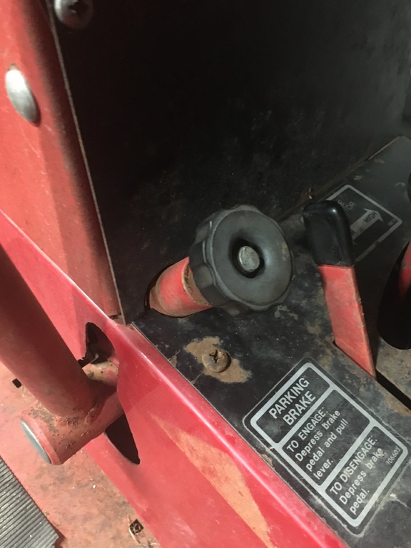

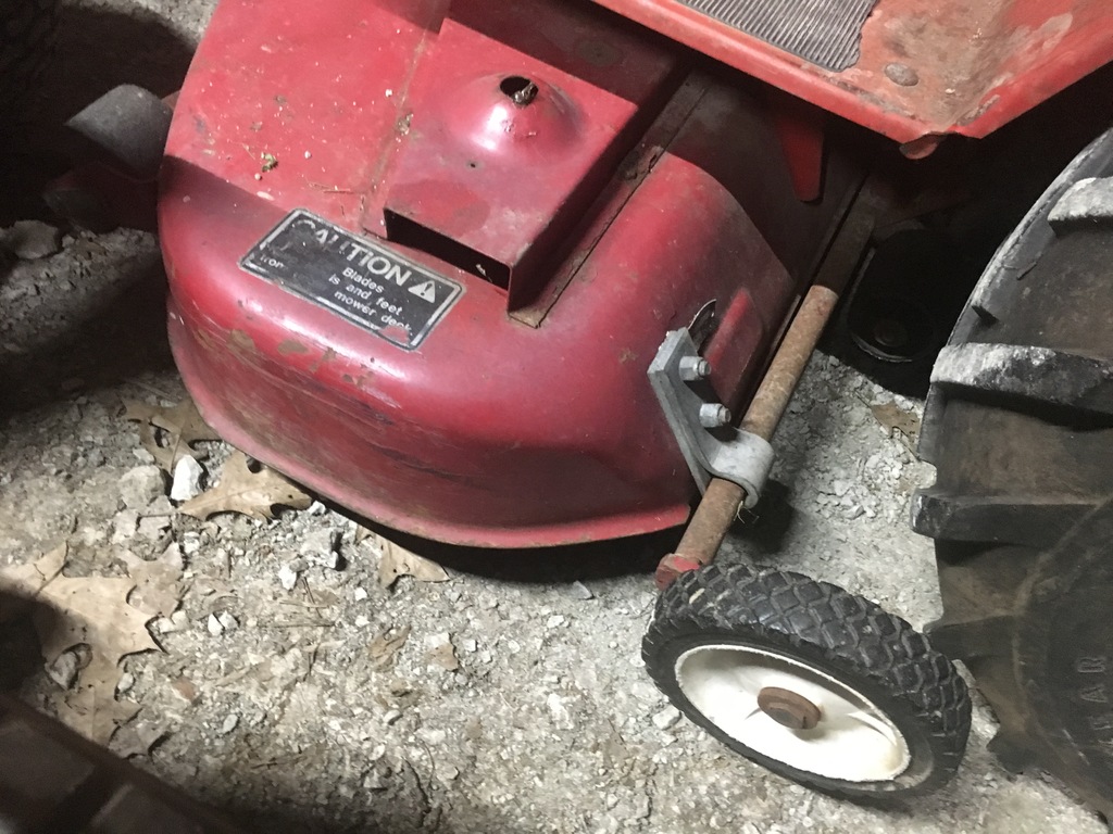

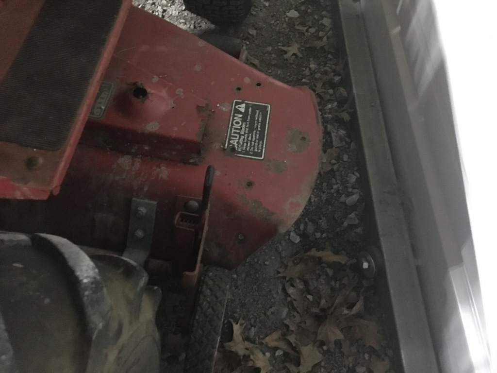

Sorry pics are terrible. Best I can do tonight. Has a total of 7 wheels with 2 of those being the adjustable ones on the rear. Am i not using the adjustable wheels and the adjuster knob for the lift handle correctly?

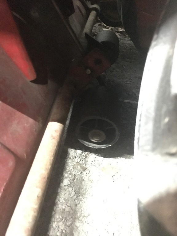

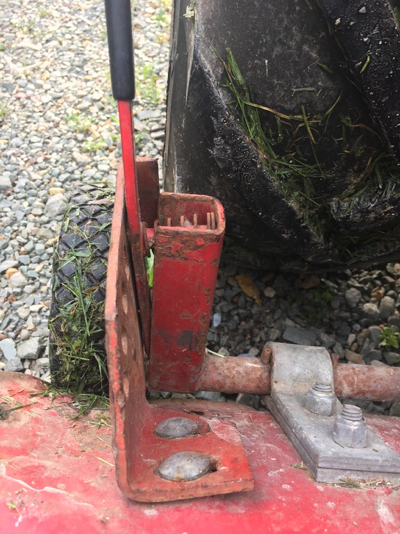

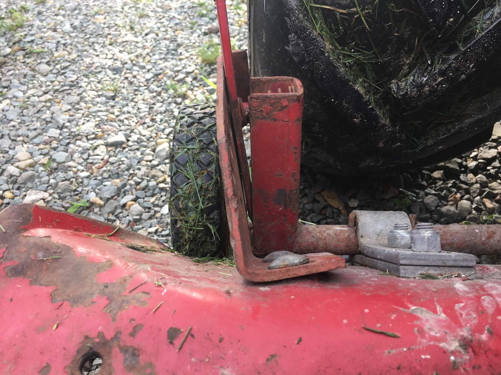

Well I got the spindles greased up everything seems tight and straight. We got to looking at the deck wheels and I noticed the adjustment bracket is wayyy bent. Hopefully the pics are good enough to show. Now I have to figure out how to straighten it. The detent spring and pin fall out of the respectable retaining hole!
  • Like 1
tunahead72
That could definitely be part of the problem.  It's hard to tell from the photos, but is the upper corner of the bracket (to the right in your photos) bent more than the rest of it, like somebody's been banging on it with a LARGE hammer?  And it looks like the bracket itself isn't mounted flush and tight to the deck -- are those two carriage bolts in good shape, or do they need to be tightened or replaced?  Is the deck basically straight where the bracket mounts, or is that area damaged also?
I would also check the large round cross bar that connects the two wheels -- is it basically straight and mounted securely to the deck?

"If it isn't a broken spring on the handle, 80% of the time the selector quadrant gets pushed or bent away from the gauge wheel "channel"/handle.
Remove the quadrant and bend it back to 90 degrees so it fits tight against the channel, or loosen it and slide it tight against. (if it isn't bent)
The other 20% is the square (looks like keystock) stops welded to the gauge wheel cross bar getting worn enough to let the entire gauge wheel assembly push away from the quadrant."

The quadrant is not even bolted on straight. It looks like the carriage bolts have started to pull/tear from the deck. So I'm gonna have to do some reinforcing I think
Racinbob
You nailed it there as far as that bracket goes. Get that sheetmetal straightened out so the bottom of that bracket is parallel with the cross rod, reinforce underneath and you'll be fine. I'm not sure it will fix your uneven mowing though. :)

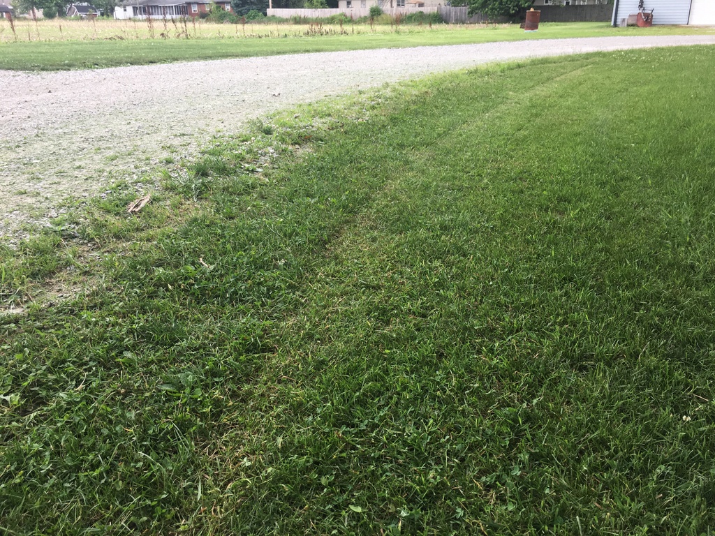

Haha I hope this fixes it!! Not really sure what else it could be :blink:  here's a few more pics I took after we messed with it a little last night. Hard to judge by the pics though
