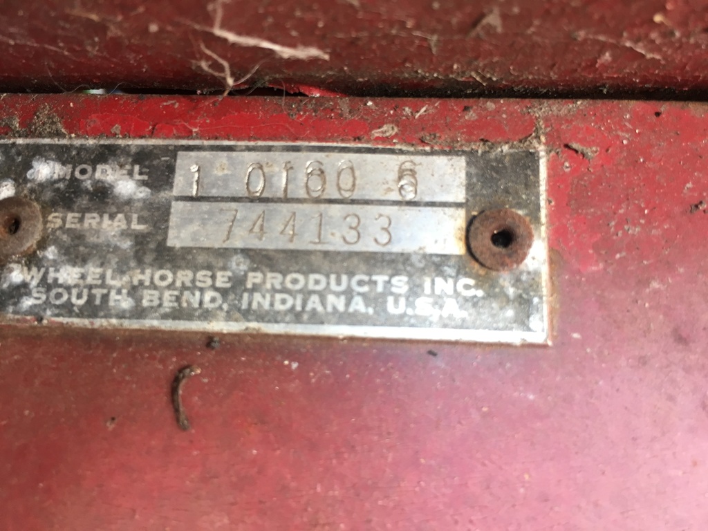

Just scored what I believe to be a c120. But I'm not sure. It has the 3 speed unidrive, which I know is incorrect. Not sure if it's been swapped or if something else is out of place. It looks the serial number plate was stamped twice!?:think:
Ed Kennell
A m/n 1-0100 should be  1971 Work Horse with a 3speed and a HH80 Tecumseh.
Team70R
Hmm... very odd! It's got a kohler on it haha. Now I'm really confused :huh:
pfrederi
It is a FrankenHorse :P  I have built a couple of those myself  so many WH parts interchange
Ed Kennell
                                                                          :text-yeahthat:
             A M/N 1-0600   would be a  1973 D series with an 18HP Kohler and a Sundstrand 90-1137.
Team70R
Hmm it's definitely a FrankenHorse!! 3 speed rear is currently locked in neutral. Won't shift into any gear.. so I'm gonna most likely sell the Kohler off of it.
Racinbob
Nuttin wrong with a Frankenhorse. I'm betting the transmission is an easy fix. You're not all that far from me if you'd like a hand. :)
Team70R
Thanks! I've got the transmission soaking in an array of fluids right now!

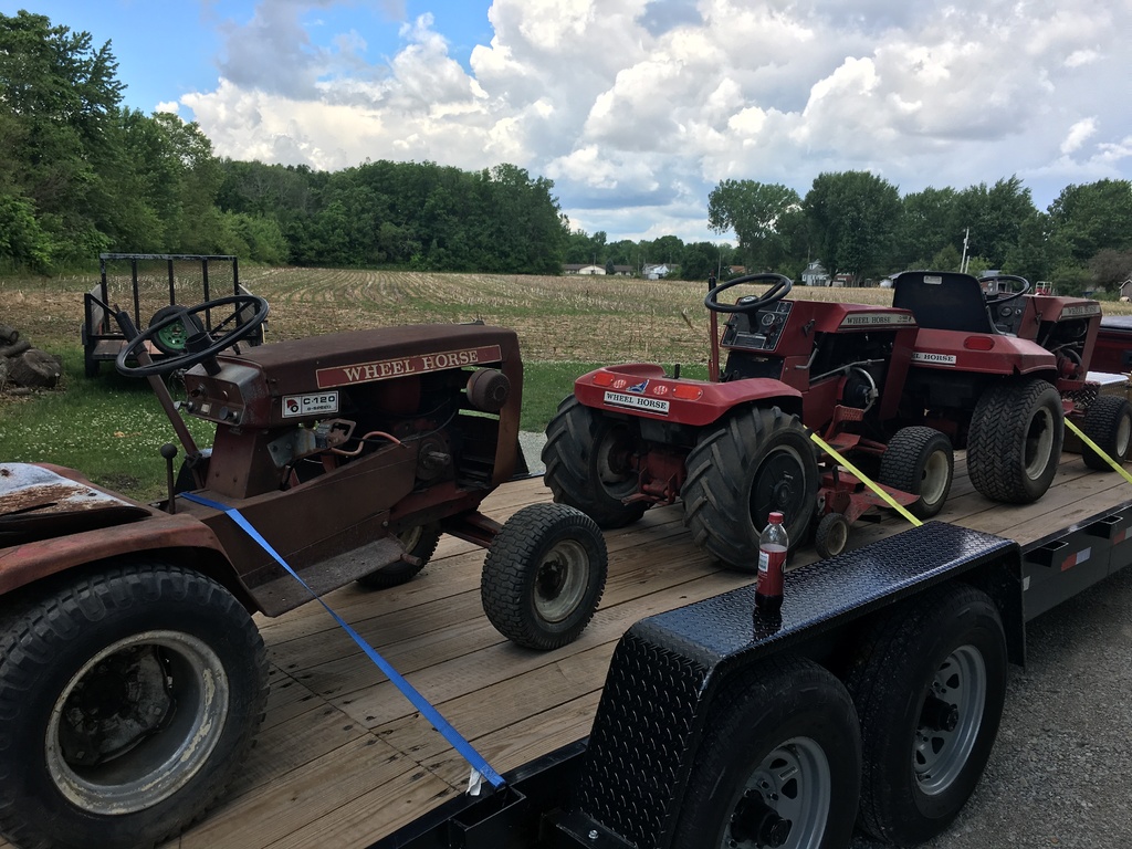

      Finished up work on the A800 ranger. Time to figure out the c120.
      The ranger got;
      Complete rewire. 👍
      New points.👍
      Re-timed and a new head gasket.👍
      Carb rebuild. 👍
      Full service. 👍
      My daughter is gonna use it this year. She has just under 1/2 an acre to cut.
      Now the challenge is the c120. Picked this up in Jan. Price was right and I was really just after the motor but the rest of it just had to come home too. Not sure if it's all there but the fun will be in finding out. So far I figure a broken clutch pedal and one rotted tire. The po had already taken it apart to restore but other things got in the way. The motor is stout and roars like a tiger.
      I'm  gonna put it all back together first...... fix what I find then tear down to restore.
      It's the transmission I don't know about. Po said it works fine......... Hmmmmm.
      Don't know much about them at the moment but "forum" research ans help here I come!!!
      Transaxle oil is low but clean and the tow valve doesn't look like it's been loosened for a while. The frame sat outside for a year.
      Thought I might change the oil and run it with an electric motor to see?????
      The axles are free and smooth.
      Anything I should be careful of?????
