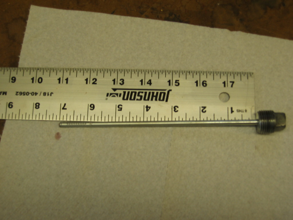

Tgtack 779 #1 Posted June 19, 2017 How do you tell how much fluid to add to the automatic trans? I did a partial drain when I pulled the filter, and need to refill it. Is there a way to measure the level down the fill pipe? (No dipstick). Share this post Link to post Share on other sites
pfrederi 18,074 #2 Posted June 19, 2017 There is supposed to be a dip stick. Allowing for it threading in bout 1/4" your fluid should be 6.25 inches from top of filler. 3 Share this post Link to post Share on other sites
