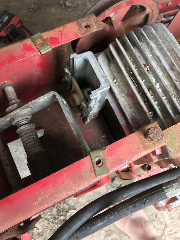

I bought a C1750 with a C160 parts tractor.  The frame was in bad shape on the C175 and the last guy planned on swapping frames with the C160.  I got both tractors for $50 and the C175 runs.
I am trying to put the transmission back together to the linkage and not sure what I am missing how this was already torn all apart prior.  Below are pictures of what I have done so far.  If anyone has pictures of what it should be I would appreicate it!
Thanks.

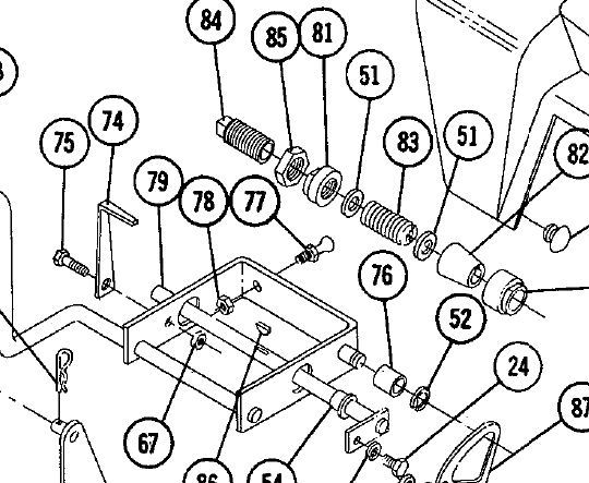

You appear to be missing the cam pin part #6127 Threaded end bolts in the hole in the cross piece the ball end goes into the plastic slider.  #77 in parts picture

Also, you will find that all of that friction linkage assembly is dysfunctional due to rust and corrosion. I had to completely disassembly mine to clean and unstick it. Stuck pretty good, and not easy to get apart without breaking it. It will not work properly like it is.
