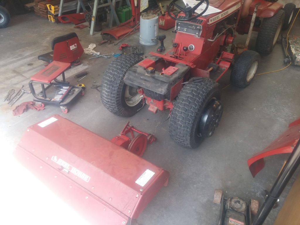

So I just got a 1975 Tiller, model # 7 1252. I am wanting to put it on my 1979 C 101 model 91-10k801.  What all do I need to adapt the tiller to this tractor? So far I have figured out that I need the lever assembly for under the seat. It also looks like the 78'-79' models have a lift plate attached to the shroud over the times, instead of the eyebolt conected to the frame of the tiller.
Any photos of this setup would be great.

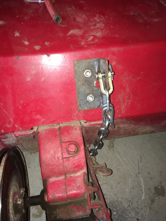

I just bought the same exact tiller this spring and was going thru just what you are.  Mine went onto a 2003 315-8.  I too had to buy the lever assembly (bought from a forum member, great stuff!).  After that I realized I needed the lift plate on the shroud. I just fabricated one out of what I had laying around.  I really didn't know where to position the lift plate so I put three holes in it for adjustment and just lined it up with the cable.  Works great!  I can get some pics tonight.

No problem.  Ain't computers wonderful?  Anyway, here are a couple of pictures I took yesterday.  It seems to me you are good everywhere except where the lift mount goes.  I took a shot and it works pretty good.  I just took a plate that I had laying around, bent it 90 degrees and put some holes in it.  Really no need to overthink it.  Good luck.

jsPond, thanks for the photos.
