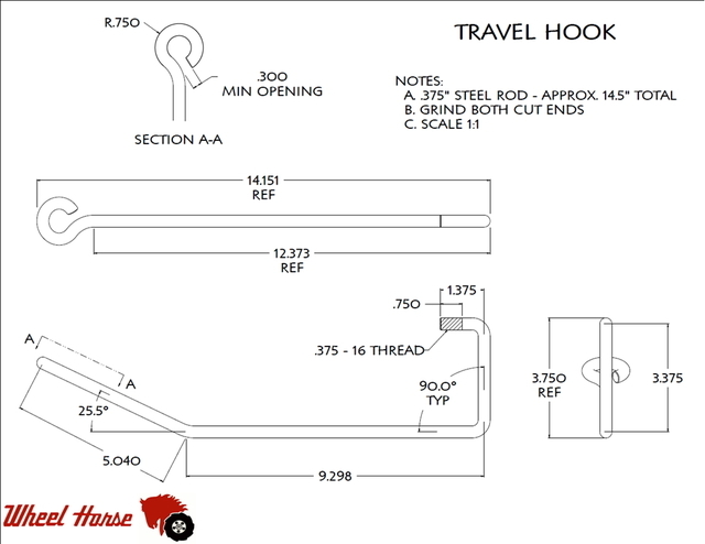

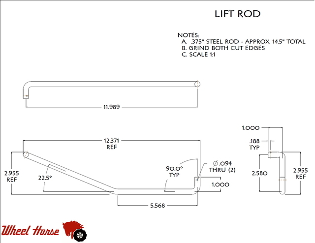

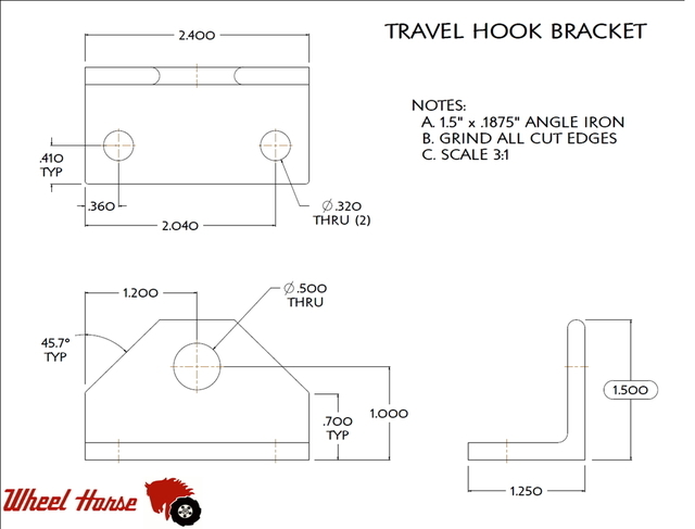

CasualObserver 3,410 #2 Posted May 31, 2017 2 hours ago, hcminis said: Will need those dimensions if anyone has them. this may help. 3 Share this post Link to post Share on other sites

jeremi3210 739 #4 Posted June 10, 2017 (edited) Pretty simple stuff to fabricate! Hope this helps! They are a lot of fun to use! If you need sickle teeth for it Jari parts will fit on these. Edited June 10, 2017 by jeremi3210 3 Share this post Link to post Share on other sites
