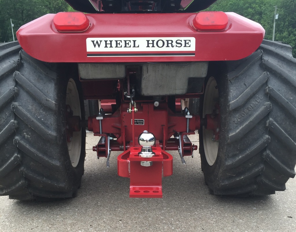

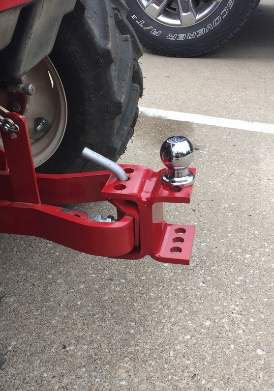

cschannuth 3,817 #1 Posted May 27, 2017 I keep a sleeve hitch on my C-161 all the time for my larger implements but frequently need to move trailers and carts with it. I've always wanted an easy way to do that and thought Lowell's (Wheelhorseman1000) adapter would work well. Then I thought two of them welded back to back would be slick, very strong, and flexible. I ordered two of them and he welded them before he shipped the order. When I received it I drilled out one of the center holes to 3/4" to receive a trailer ball, did a little prep work, and then painted it. To pull a cart I just turn it over. It could have been done less expensively but I thought this was clean and strong. I think Lowell and my wife think I'm crazy but I took care of my own Father's Day present so my wife was ok with it. 22 Share this post Link to post Share on other sites

shallowwatersailor 3,214 #9 Posted May 29, 2017 On 5/27/2017 at 4:49 PM, cschannuth said: I keep a sleeve hitch on my C-161 all the time for my larger implements but frequently need to move trailers and carts with it. I've always wanted an easy way to do that and thought Lowell's (Wheelhorseman1000) adapter would work well. Then I thought two of them welded back to back would be slick, very strong, and flexible. I ordered two of them and he welded them before he shipped the order. When I received it I drilled out one of the center holes to 3/4" to receive a trailer ball, did a little prep work, and then painted it. To pull a cart I just turn it over. It could have been done less expensively but I thought this was clean and strong. I think Lowell and my wife think I'm crazy but I took care of my own Father's Day present so my wife was ok with it. Any indication of the load "over-running" the tractor? Does the sleeve hitch attempt to rise with a highway trailer attached without being solidly held down? It is a nice and simple solution, plus also being able to pull a L&G cart. Share this post Link to post Share on other sites

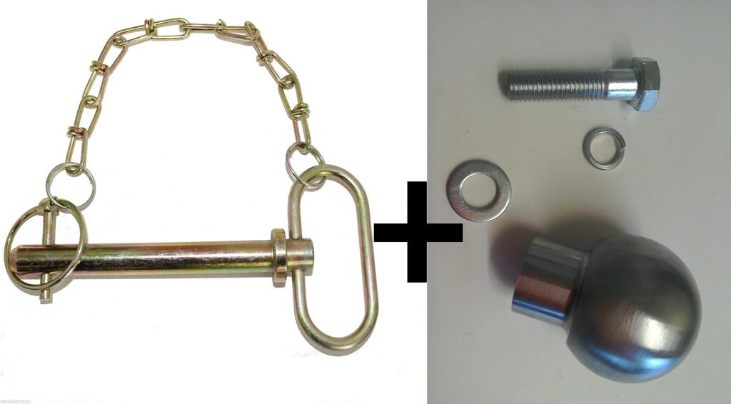

Ian_Courts 77 #10 Posted December 21, 2017 (edited) Perhaps an even easier solution would be to weld a bolt mounted tow ball to the top of a 5/8" hitch pin after removing the loop handle? Edited December 21, 2017 by Ian_Courts 2 Share this post Link to post Share on other sites
953 nut 56,559 #11 Posted December 21, 2017 8 minutes ago, Ian_Courts said: weld a bolt mounted tow ball to the top of a 5/8" hitch pin That seems like a good idea. Thanks for sharing. Click on this link and post an introduction and tell us a little about yourself. http://www.wheelhorseforum.com/forum/47-introductions/ 1 Share this post Link to post Share on other sites
