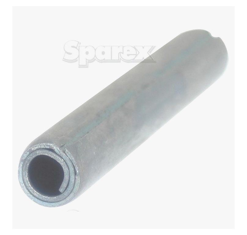

Molon_Labe 731 #12 Posted May 31, 2017 Many of these pins were a "Spiroil" design. A pin made of multiple turns of spring steel, hard as hammered Hades. Best way I have found to remove them is to soak them in Kroil or similar penetrant and drive them out with a punch the exact same size as the hole. Spiroil pin 1 Share this post Link to post Share on other sites
