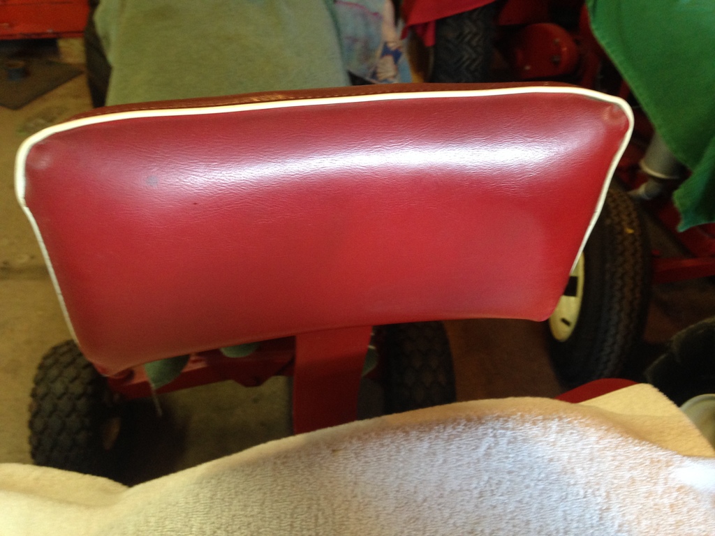

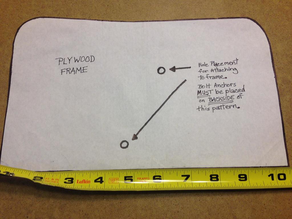

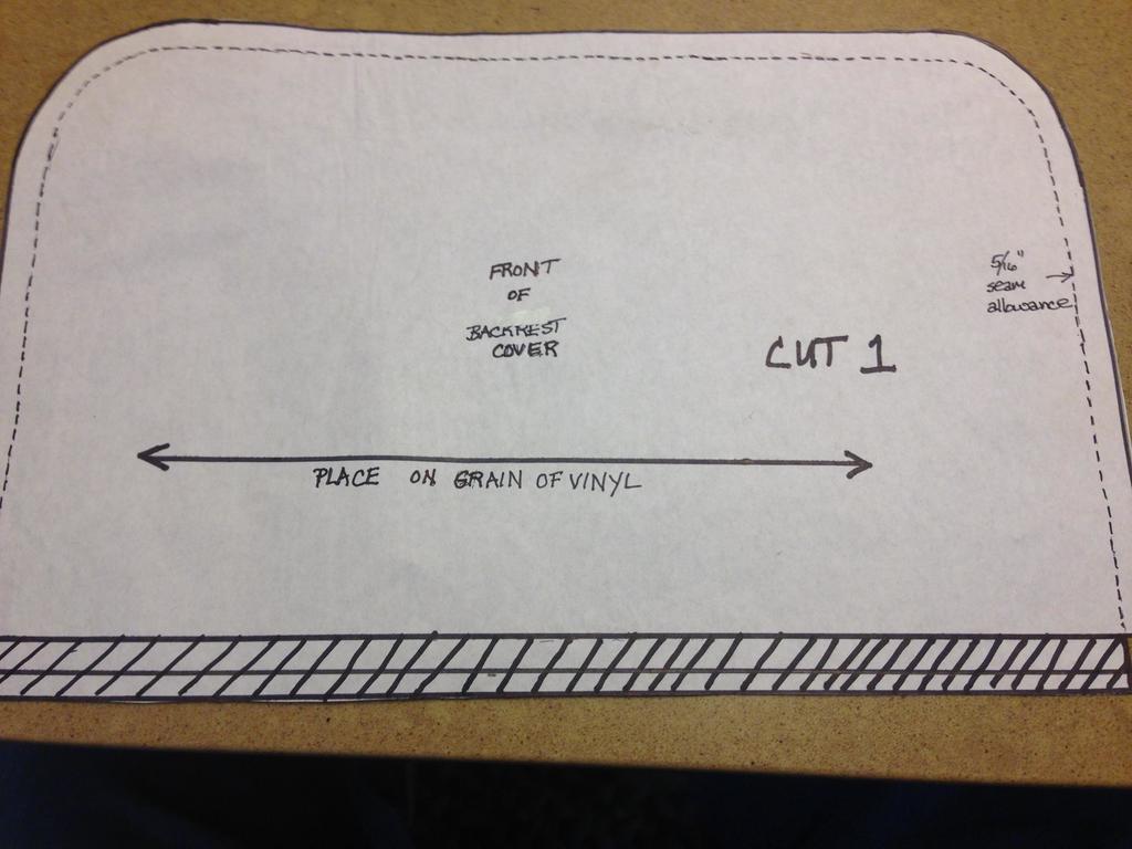

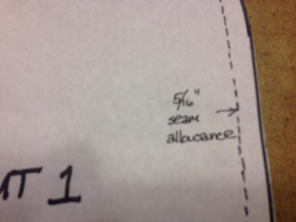

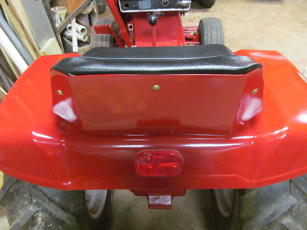

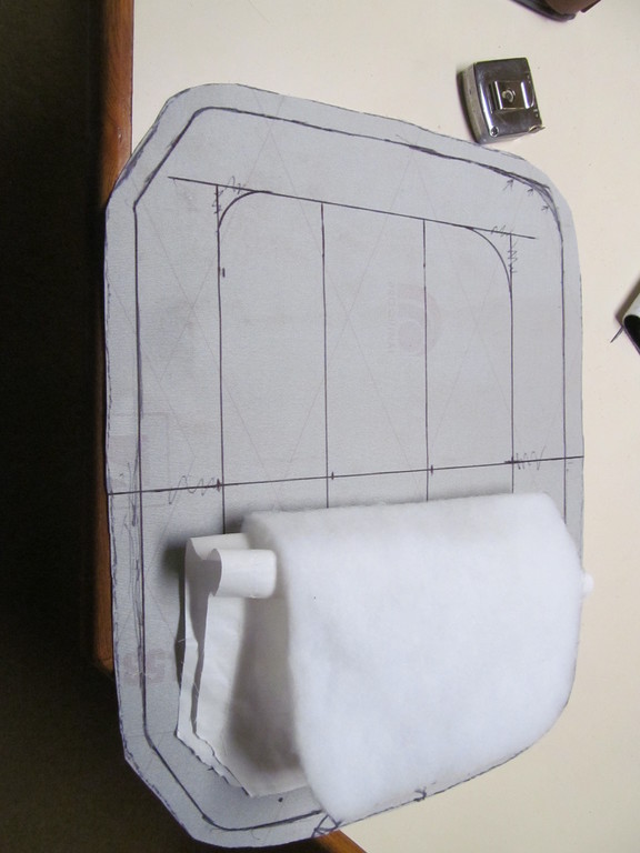

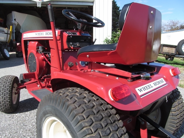

Lane Ranger 11,085 #1 Posted May 24, 2017 (edited) My sister has made a couple backrests (plywood board and upholstery also) for my old Wheel Horses. She has used 3/8 plywood but I have seen other folks use different types of materials. Glued chipboard is not a good materials to use as the embedded three prong threaded 1/4 x 20 clips ( I guess they call these T nuts) that go into the seat back to secure the two screws will often come loose or work out. I am posting pictures of two of the backrests my sister made for me . The measurements on these drawings is what she used to sew up the materials for the seatback. I will note that I took a picture (last picture in this set) of one of the early seatbacks and found it to be one inch wider -so you can take that in consideration if you want to when making. This posting may help some of you wanting to have a seat back made or reupholstered. Edited May 24, 2017 by Lane Ranger 13 Share this post Link to post Share on other sites

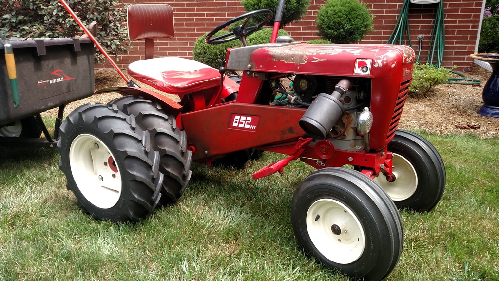

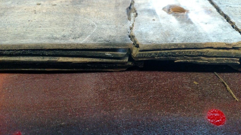

RedRanger 1,469 #5 Posted May 24, 2017 Good info! I also have an early 60's original backrest on my 702/852. The wood dry rotted and last fall I cracked it in half moving the tractor around my garage. I'm hoping I can open it up and make a new wood insert for it while re-using the factory cover to keep the retro look. Been trying to figure out if I should use plywood or a board? I'm guessing true plywood is the way to go. 2 Share this post Link to post Share on other sites
Lane Ranger 11,085 #6 Posted May 24, 2017 I think they even steamed some of those early backrests that had plywood to make a little bit of of bend on the ends. Round the edges and sand if using your old cover. Share this post Link to post Share on other sites
RedRanger 1,469 #7 Posted May 24, 2017 21 minutes ago, Lane Ranger said: I think they even steamed some of those early backrests that had plywood to make a little bit of of bend on the ends. Round the edges and sand if using your old cover. I haven't tried to disassemble yet, but yes, it does look to be curved. 1 Share this post Link to post Share on other sites
BOB ELLISON 2,981 #8 Posted May 24, 2017 REDRANGER you will find the old original seat covers are very dry and will cracks if you try to remove it. Mine was so dry rotted it fell apart in my hand so making a pattern from it was impossible. Good luck on that. 1 Share this post Link to post Share on other sites

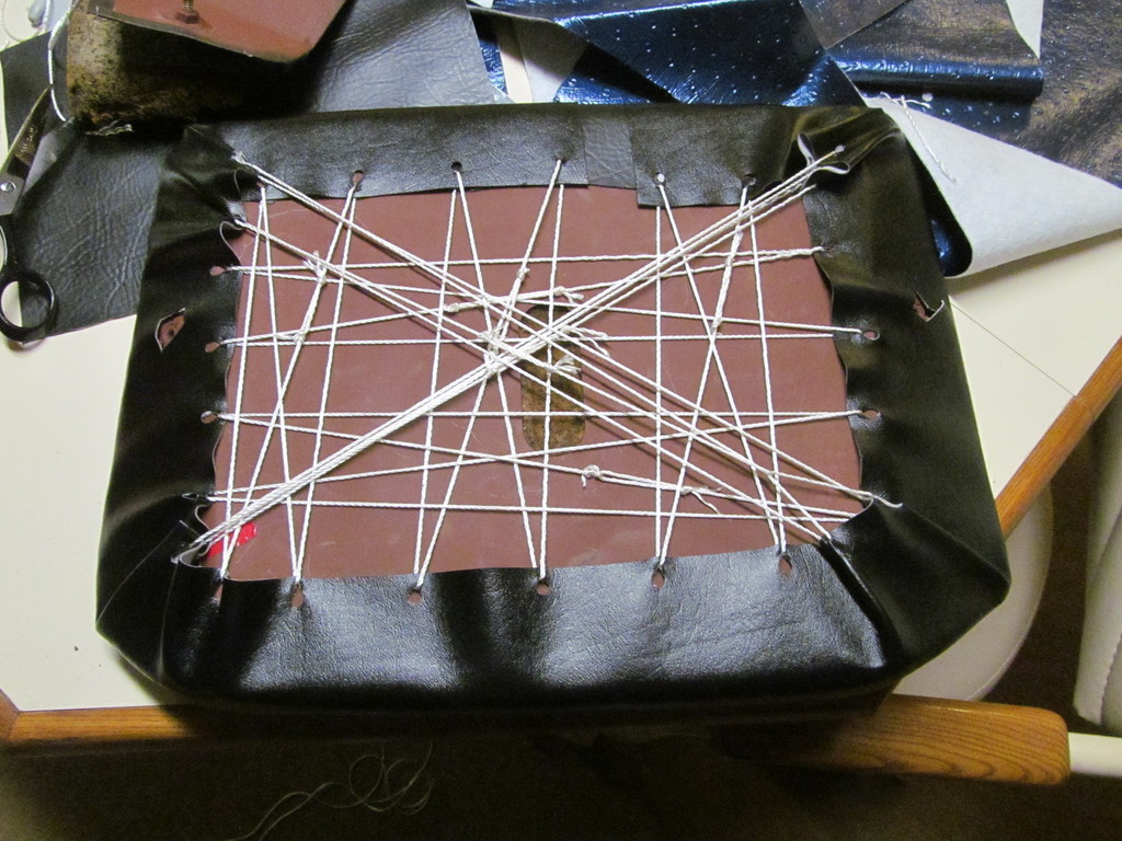

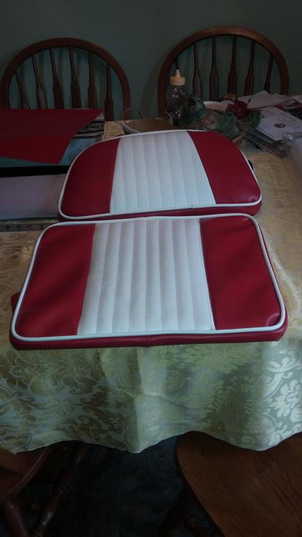

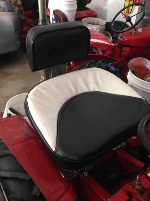

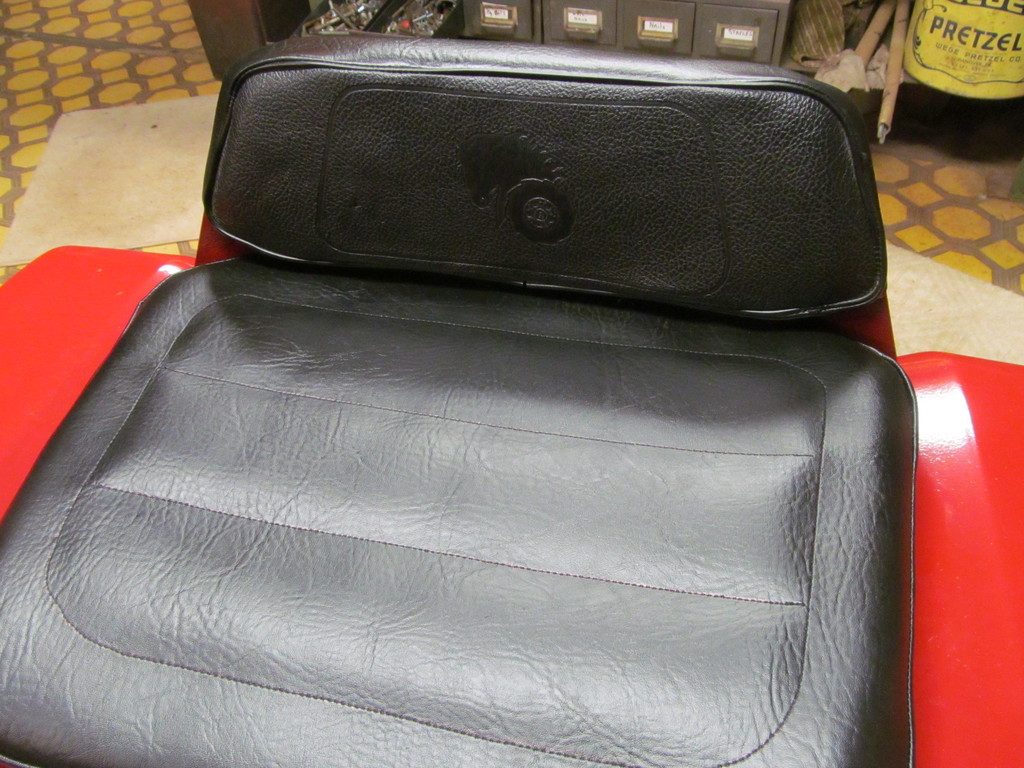

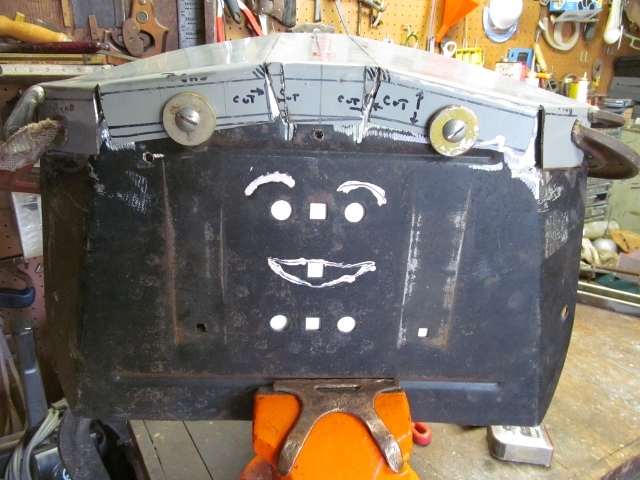

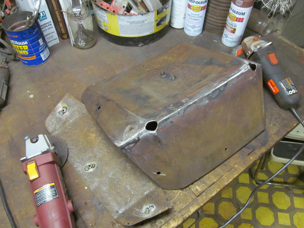

Ed Kennell 40,030 #9 Posted May 25, 2017 Thanks for the info. Those are some great looking upholstery jobs. I know it's a completely different assembly process, but if you don't mind @Lane Ranger, I'll add some pictures of the seats I have rebuilt. The seat back on my C-101 was broken off and not with the tractor, so I made a pattern from another seat and fabbed a new back. Mrs K does the sewing. The Commando 8 seat back was broken off, so I just had to weld it back to the bottom and make new cushions. I have found the back cushion with the WH Logo is usually OK, so I just add new cording and side panels. 3 Share this post Link to post Share on other sites
Lane Ranger 11,085 #10 Posted May 25, 2017 (edited) Ed: A very good addition to this post. That two piece seat looks great. My sister is doing a project like that right now. We are trying to save a WH horsehead logo on the back of the two piece black seat and redo the vinyl on the sides. Edited May 25, 2017 by Lane Ranger 2 Share this post Link to post Share on other sites

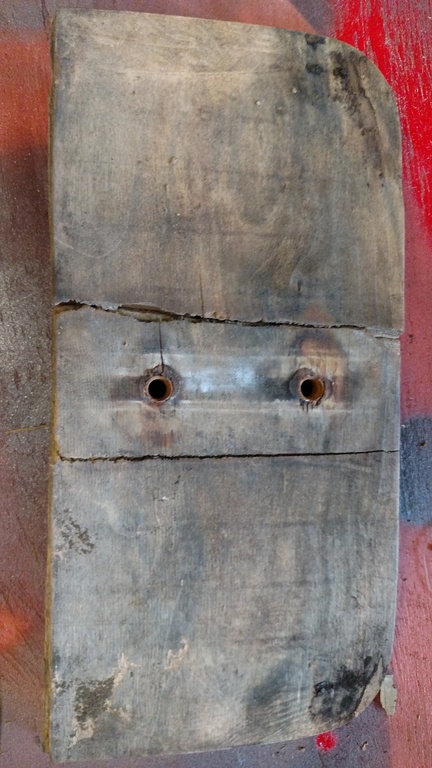

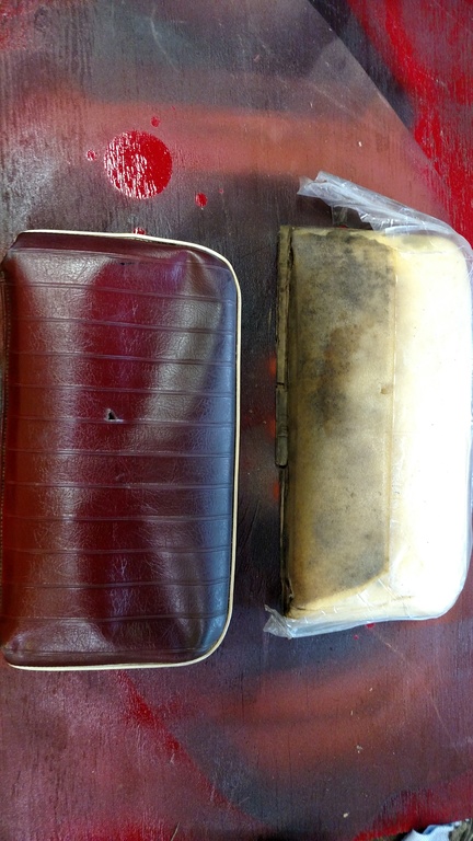

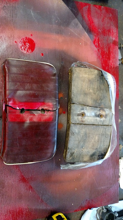

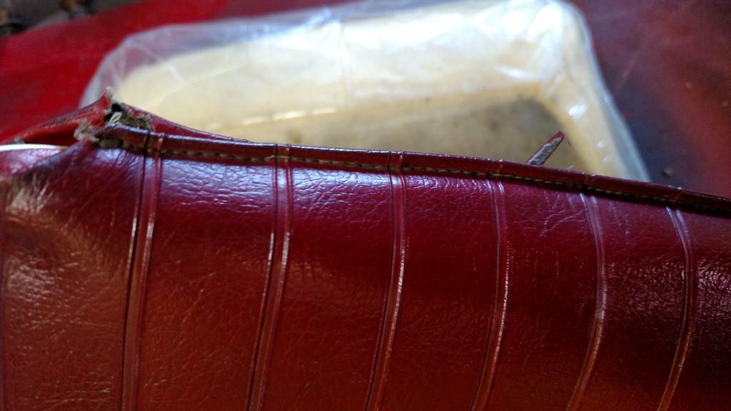

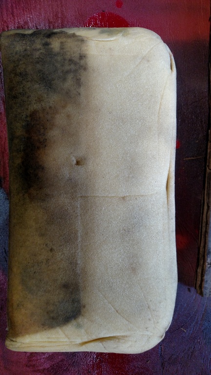

RedRanger 1,469 #15 Posted June 9, 2017 For anyone wondering what the inside of the original backrests looks like.... I've made a new plywood insert, transferred the T nuts, reapplied the factory foam and put it back together. My cover split on the backside under the metal bracket so I think we can sew the bottom back together and with some staples and duct tape, I can make it work. 99% of the cover damage will be hidden behind the back brace. 3 Share this post Link to post Share on other sites
