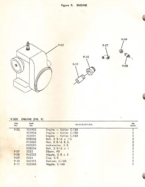

Racinbob 11,448 #11 Posted May 23, 2017 54 minutes ago, WHX11 said: It's definitely not 1 1/2" I thought it was 1" as well but maybe 1 1/4"?? Were you that indecisive guy in the Busch beer commercial?? All the 341's I've dealt with were 1 1/4" like the drawing Paul posted. That's not to say some of them were 1" though 2 Share this post Link to post Share on other sites

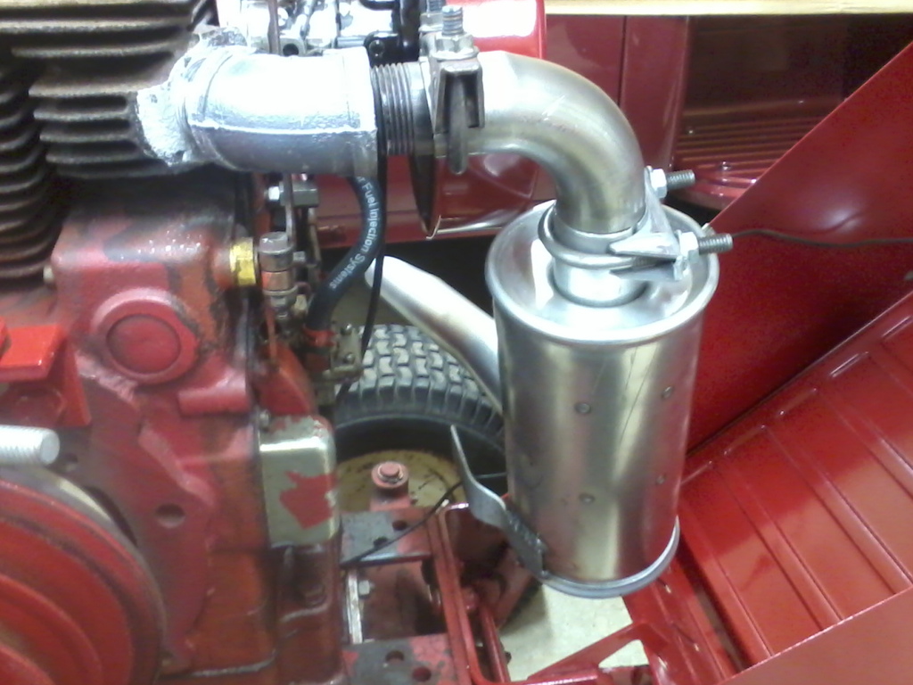

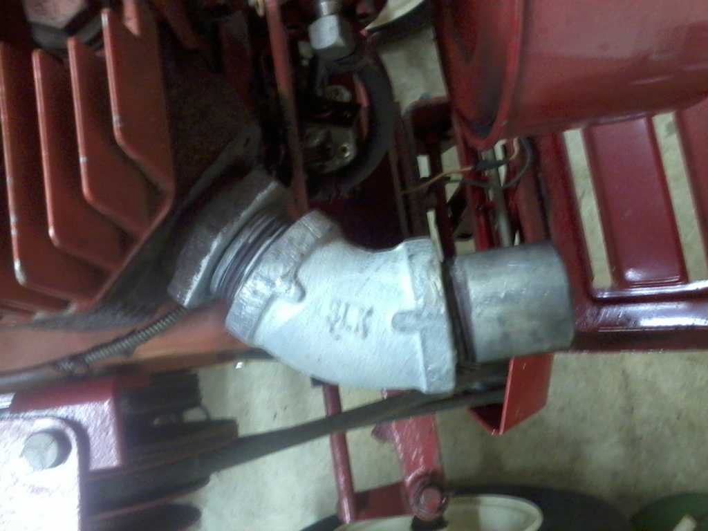

jay bee 912 #14 Posted May 24, 2017 As Paul said in Post #7, the K-341 uses a reducer down to 1" i.d. pipe which is 1 1/4 o.d. The muffler then connects to the nipple. The first picture is of my K-341 with the reducer and the second picture is of my K-321 where there is no reducer. And yes, I do sell these Mufflers and the 90 degree exhaust pipe elbow that connects it to the nipple if you need a muffler. Jim Share this post Link to post Share on other sites
