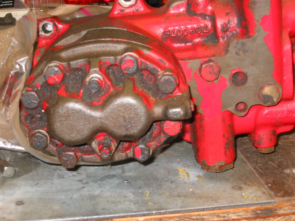

Red Fluid is ATF (Dexron).  Tan is Motor oil.
If the hydro motor part looks like this then it is still a hydro gear /Wheel- a-matic  (same thing and both Sundstrand..  The unit is lying on its side in the picture the figure 8 shape will be vertical.
By all means do the tune up
