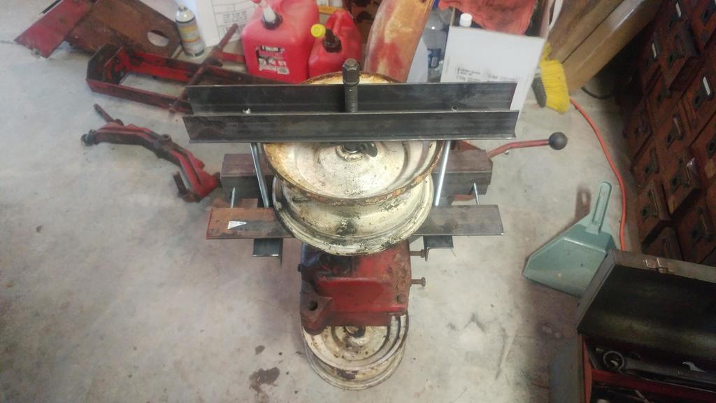

My WH had been sitting outside for 3-4 years with prev owner and who knows how long before that, so I started soaking the hubs and looked around for ideas on breaking them off the transaxle.  I borrowed this idea from the Blizzard Tools wheel puller and decided to give it a shot.   I had the angle iron, borrowed some pieces from my gear puller, and it worked like a charm!   Very glad to have that problem solved without destroying the wheels.

Being a Hoosier myself, and having had big problems removing hubs in the past, I find this to be both a novel and practical option to the often nasty chore of hub removal.
Kudos, Sir!
