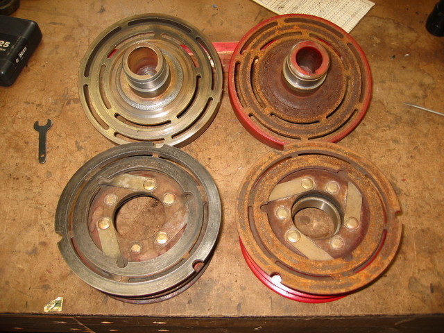

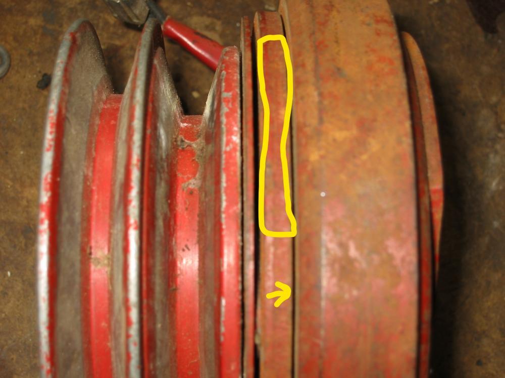

pfrederi 18,334 #4 Posted May 21, 2017 (edited) Try the clutch with the engine not running...Ignition switch in the run position. There is not much movement The disk highlighted in yellow should move towards the coil assembly (direction of arrow) only moves about an 1/8 of an inch. The gap between the yellow disk and the coil assembly when the PTO is off is called air gap. Wheel Horse doesn't much mention it in its manuals. When JD uses electric PTOs they make a big deal about adjusting the air gap....go figure. Edited May 21, 2017 by pfrederi 3 Share this post Link to post Share on other sites

pfrederi 18,334 #11 Posted May 22, 2017 This is a bit of a puzzlement.....Look at the thin gap just to the right of the highlighted disk (the gap the arrow points to). How big is your gap??? Share this post Link to post Share on other sites

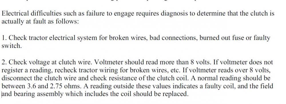

gwest_ca-(File Mod) 11,243 #12 Posted May 22, 2017 Some of the later models came with a separate manual with setup instructions for the servicing dealer. This is from one of them 1998 267-H but theory should be the same. I don't know if the older models even had a method of adjustment but have seen where a too wide of gap on the later models would not apply the clutch. Magnetism must have been too weak with the wider gap. Garry 2 Share this post Link to post Share on other sites
pfrederi 18,334 #13 Posted May 22, 2017 (edited) Garry you are the man when it comes to finding good stuff. This is the kind of detail John Deere has on Electric PTOs. Unfortunately the adjustment process for the older units is pretty blunt. You bend three metal tabs the thin metal pieces in the bottom half of the units pictured..... I haven't seen a spec for the airgap on the older units. i have two horses with working PTOs so i am off to the storage shed to measure the gap and see what a working system has. Edit: Went up and measured the air gap on the two horses (Charger /Electro)that use electric PTOs One measured .038 the other .030 they both work. Another test with engine off but PTO turned on see if the face of the PTO attracts steel. Mine both ant e to pull on the feeler gauge held up against the front of the PTO. If you have that magnetism then we have to look at the air gap or something (corrosion) keeping it from moving. Edited May 22, 2017 by pfrederi Share this post Link to post Share on other sites
