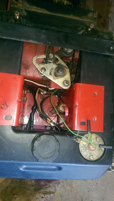

EricF
The pic above has the fender pan removed so you can see everything that's underneath. If you just tilt the seat forward on its hinge, the cam plate and tension nut is exposed and easy to get to through an access hole in the fender pan. All you have to do is make the big friction nut in the middle snug, so you can operate the hydro motion lever easily and have it stay in place when you let go. It's not an exact thing, just whatever you prefer.
If the lever action gets rough or tends to bind unless it's too loose, then make sure the cam plate isn't roughed up with surface oxidation. Mine was. I rubbed a tiny bit of grease along the metal-to-metal surfaces to "season" it by getting the grease worked into the surface, then wiped it all off so it wouldn't attract dirt -- just a tiny bit of film left. The action works really smooth now. In the future, a little bit of dry lubricant like a Teflon or graphite lube should keep it in good shape.
The manual specs a force of 6 pounds to move the motion lever on page 12.
Garry
Duramax7man7
I agree. This nut has a friction washer underneath. Slight tightening of this nut can do wonders and make the lever nice a snug and stay in motion.
IIRC, the manual states that it should take 5-6lbs of pressure to move the motion lever.
