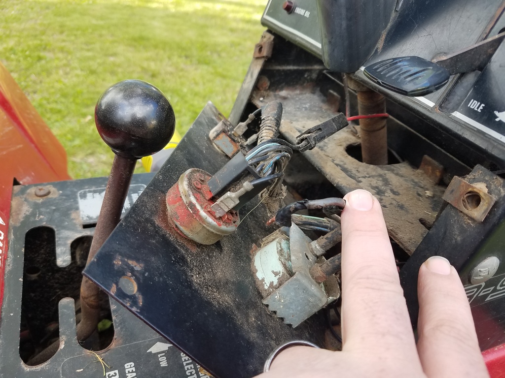

Hi all, new to the wheel horse world. My grandfather gave me his. Not sure of the year. I have had the tractor for 2 weeks. All of sudden today is started blowing the 15 amp fuse every time i turn the key. I replaced it twice, Second time it fired. After I cut the grass and turned it off, when I tried to refire it started blowing fuses again. Any ideas?

Sounds like you have a short to ground .  Possibly a pinched or bare wire from the ignition or starter  side of the ignition switch.

I took the plate off that holds the ignition and the is a ground disconnected but I can tell where it goes.... anyone have a wiring diagram?

See the red wire wrapped around the steering shaft? It appears to have left rub marks on the shaft. Pull the wire back and look for a flat spot worn in the insulation. It will get thin enough to expose a strip of wire and that is all it takes.

Thanks everyone I gave up on it go tonight. I will check the red wire I also couldn't figure out where that unhooked ground went

There should be a ground terminal on the ignition switch.
