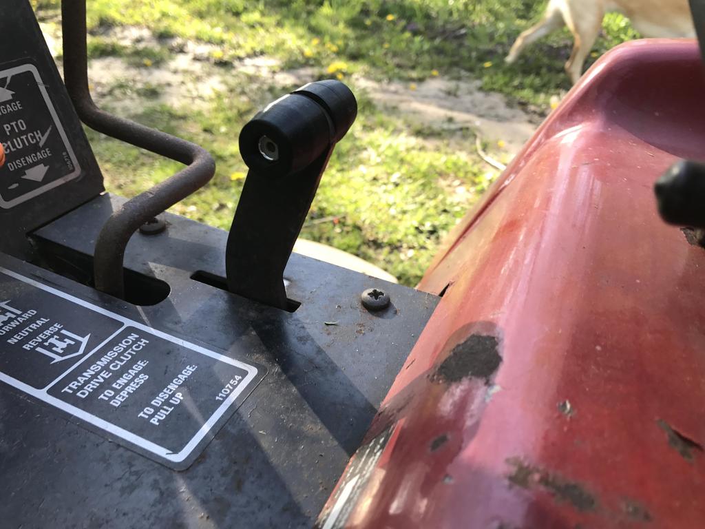

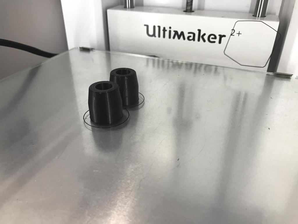

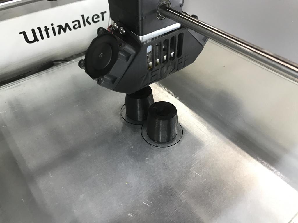

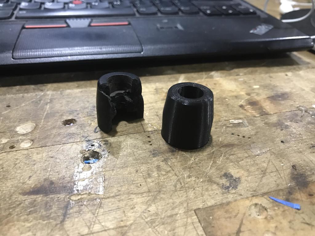

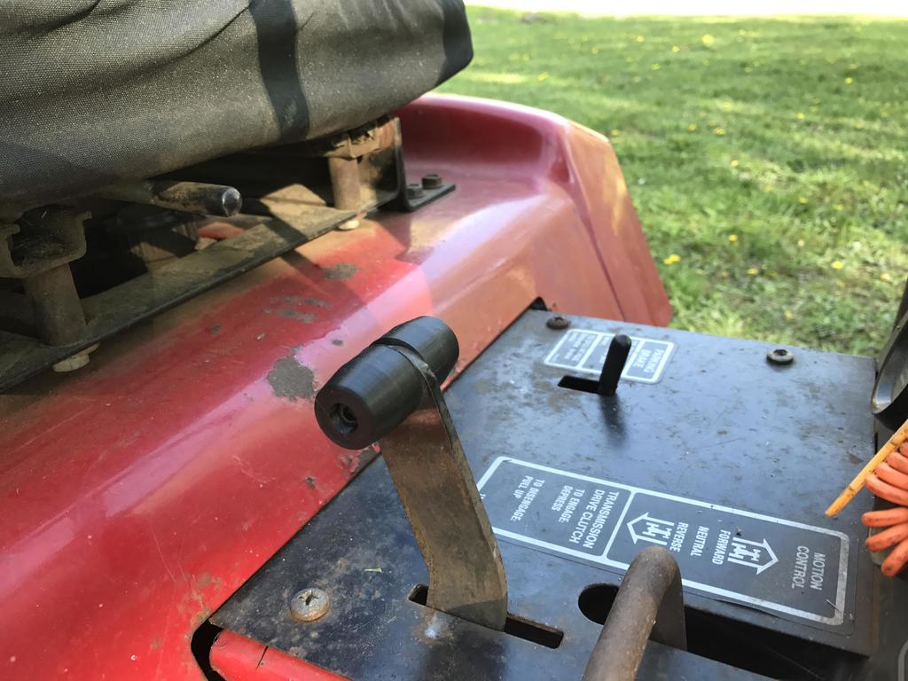

JUSS10 250 #1 Posted May 6, 2017 So while I was out mowing for the first time this year on the 314-A, I looked down and saw that the transmission belt activation lever was missing the little end pieces that make up a handle. I hopped off the tractor and started to look around in the grass. All I was able to find was half of one of the pieces. Looks like with time it just fatigued and cracked. Seeing how simple it was I got an idea. I am a designer/engineer by trade and do lots of model making and prototyping where I work. I looked at the part I quickly modeled it up in solidworks (3D cad software) and ran over to my 3D printer and knocked it out. I made it so one of the pieces can hold a lock nut so it should never work its self loose again. Attached are some photos of the printing process and final parts on the tractor. Everything is back to normal and it works great! I'm trying to think of other common parts I could model up and print as the old plastic starts to fail on these great machines! Justin 19 Share this post Link to post Share on other sites

JUSS10 250 #9 Posted May 6, 2017 2 hours ago, classicdmax said: I'd love to see one of those printers in action in real time Its not that exciting. Its really rather slow. That said next time I'm printing a set of these I'll take some video and post it up 2 hours ago, Jerry77 said: If you are interested in making and selling the handles you just made, put me down for a pair of them...very nice job.. I can make a few sets if people are interested 1 hour ago, neil said: So how difficult is it to work one of those 3D printers? In theory its really simple. However, there is sort of a black magic to them to get a really great print. Different materials have different properties, even different colors of the same material can print drastically different. Knowing what is/isnt good for printing is also key as well as how to orientate and tweak the settings to get he best results for any given part takes a lot of practice and experience. There are at least 5-10 settings that I tweak for each print to get the best results. The other thing that is a huge disconnect is that unless you have the skills to model and design something in 3D cad, all you can really print is trinkets and random "junk" that you find online. I honestly think that's the biggest reason they aren't a household item yet. You essentially need that middle step between "I have an idea" and "I have a physical part in my hands" which is the ability to use a cad program. Then finally there are certain atributes about 3d printing that just isn't great. They are really only "strong" in 2 of the 3 axis'. When it a print fails its usually due to layer separation. Once again, you can avoid some of this with experience and designing a part that is specific to 3D printing that you may not design that way it it were injection molded. So is it difficult? Yes and No 3 hours ago, WVHillbilly520H said: Yes those very ones, Toro quit making them... Well I thought I knew where my set was, I'll have to keep digging for them. I did find a set for the black hoods. I would think those are also no longer available? 2 Share this post Link to post Share on other sites

bds1984 1,466 #13 Posted May 7, 2017 Interesting... I have a 3D printer in my classroom that is nearly the side of a refrigerator, I cannot believe I have never thought of printing out the plastic bits before! What kind of model and support material do you use? Does your printer heat up on the inside or just the nozzles? Share this post Link to post Share on other sites
JUSS10 250 #14 Posted May 8, 2017 On 5/6/2017 at 3:06 PM, KC9KAS said: Glen Pettit (one of our vendors) has the knobs for sale...just saying............ Quite aware he has them, but when I have the tools and the means I'll try it myself! Also, I'm assuming Glen just makes molds of existing parts. I wanted to add the lock nut to mine so it will never work itself loose from vibration. Thus I had to redesign and print it. On 5/6/2017 at 9:17 PM, bds1984 said: Interesting... I have a 3D printer in my classroom that is nearly the side of a refrigerator, I cannot believe I have never thought of printing out the plastic bits before! What kind of model and support material do you use? Does your printer heat up on the inside or just the nozzles? This part was printed in PLA as its nice for quick prints. I'll likely print another in ABS when I get the chance. No support material. I always try and design my prints to have no supports. This is primarily due to the fact that its a single extruder machine which means any support material is the same as the regular print material which makes supports more difficult to remove. Also, no supports mean less print time! Printer has a heated bed. It is enclosed but I haven't added an ambient heater yet. I plan to do that soon as that will greatly help with warping caused by uneven cooling of the parts. Justin 2 Share this post Link to post Share on other sites

bds1984 1,466 #18 Posted May 9, 2017 On 5/8/2017 at 10:18 AM, JUSS10 said: This part was printed in PLA as its nice for quick prints. I'll likely print another in ABS when I get the chance. No support material. I always try and design my prints to have no supports. This is primarily due to the fact that its a single extruder machine which means any support material is the same as the regular print material which makes supports more difficult to remove. Also, no supports mean less print time! Printer has a heated bed. It is enclosed but I haven't added an ambient heater yet. I plan to do that soon as that will greatly help with warping caused by uneven cooling of the parts. Justin I have a Dimension 1200es. This is the first time I have ever had a 3D printer in a classroom. It has a pretty slick set up; model material and support material heads that are headed, plus an environment heater so the whole unit gets hot. Print time is a bit slower for larger parts and they usually have to take an acid bath to remove the support material, but I'm certainly not complaining one bit! 1 Share this post Link to post Share on other sites
JUSS10 250 #19 Posted May 10, 2017 23 hours ago, bds1984 said: I have a Dimension 1200es. This is the first time I have ever had a 3D printer in a classroom. It has a pretty slick set up; model material and support material heads that are headed, plus an environment heater so the whole unit gets hot. Print time is a bit slower for larger parts and they usually have to take an acid bath to remove the support material, but I'm certainly not complaining one bit! Impressive machine! My personal printer has about the same build volume but is definitely not a professional model. I actually got it from a local model shop that I do a lot of work through for my job. It was broke so I got it cheap. I redesigned the whole XY gantry and built a custom hot end for it. The one I showed in the photo up top is the one on my desk at work. I did manage to find my headlight inserts for my 300 series tractor. It might take me a while to model up as its actually a rather complicated geometry. Will post up something once I get to it. May also look over the other parts of the tractors and see if there is anything else I can print that isn't currently made by a vendor or available through toro. Justin Share this post Link to post Share on other sites

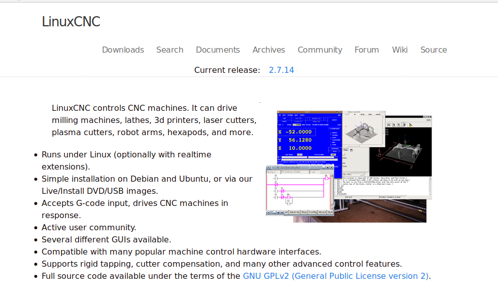

bc.gold 3,403 #25 Posted October 8, 2019 Open source software that will run your cnc equipment. http://linuxcnc.org/ Share this post Link to post Share on other sites
