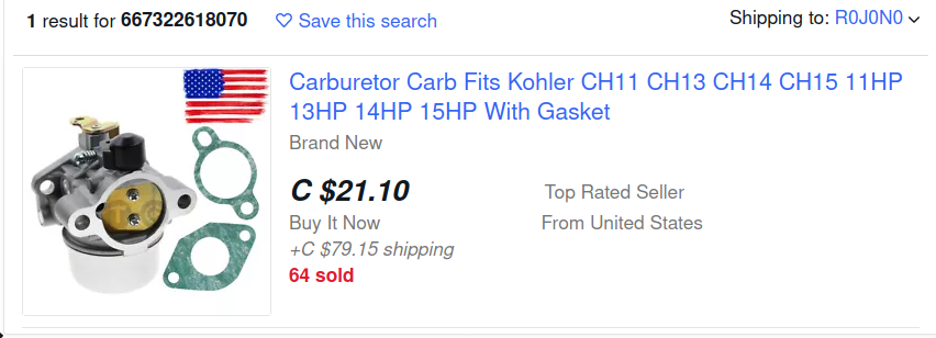

A carb for less than $20 made in USA I very seriously doubt it....
