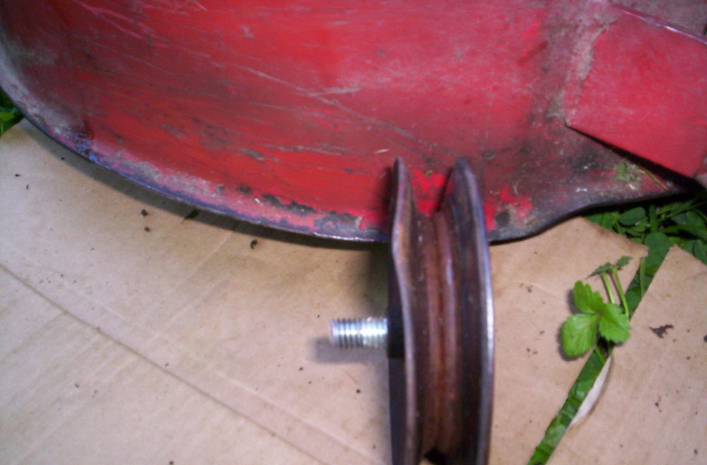

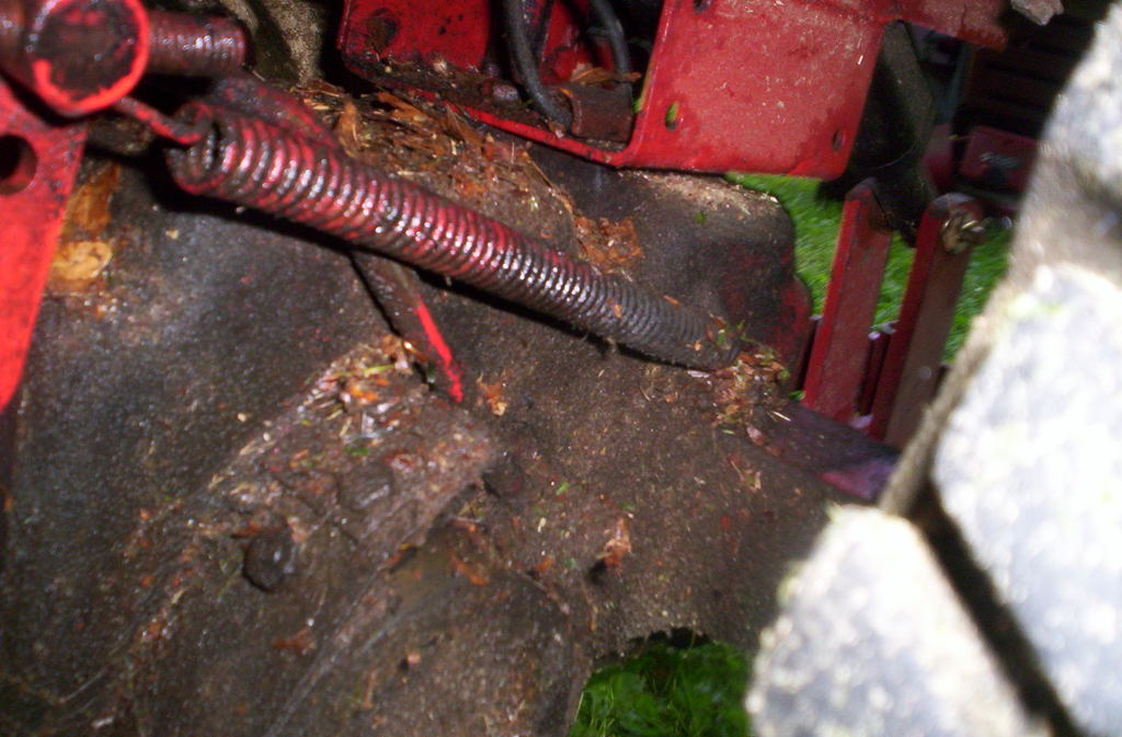

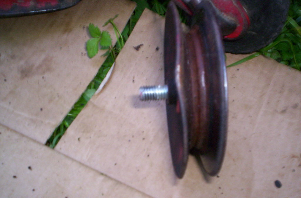

elcamino/wheelhorse 9,358 #1 Posted April 28, 2017 (edited) This was the second or third problem with the horses today.Just started mower,push in clutch heard a wack and the drive belt had been throw off. First time it has ever happened . Finally towed it back to the work area outside the shed . Nothing hung up under the tractor , took the tin off on the side found belt off and stuck behind idler pulley holder. Again can't see anything problem. Finally got belt on went for test ride. Got a 10 feet , happened again. This time removed idler pulley and it is bent in two places on outer edge. I know I need an idler pulley ,but can you think of anything else I should check. It does not have a damper so the clutch does jerk. The pulley on the trans appears ok , but I need to check . I do have a question about the spring on the opposite side of the trans for the clutch. There appears that the spring could be attached in two different holes on the arm. Mind is in the highest hole. I have checked the parts and service manual with a diagram of clutch but it just list the spring without showing how it is attached . If the spring is attached in the lower hole would than reduce the tension on the idler pulley and reduce the jerky clutch . Any help would be appreciated. Edited April 28, 2017 by elcamino/wheelhorse spelling 2 Share this post Link to post Share on other sites
953 nut 56,511 #2 Posted April 29, 2017 3 hours ago, elcamino/wheelhorse said: spring could be attached in two different holes on the arm. Mind is in the highest hole. I have checked the parts and service manual with a diagram of clutch but it just list the spring without showing how it is attached Is this a tractor you just bought or is it one that the clutch has been operating normally up till now? How old is the belt and is there any indication of uneven wear? Most have a small heavy wire retainer near the engine pulley and there should be a retainer on the idler that helps stop the belt from rotating when you push down on the clutch, is it in place and slightly ahead of straight up? 3 hours ago, elcamino/wheelhorse said: took the tin off on the side There is a angle iron piece on the bottom on most belt guards, was it in good order? Let us see the condition of these items please; you know what is coming next ..... 1 Share this post Link to post Share on other sites
elcamino/wheelhorse 9,358 #3 Posted April 29, 2017 I have had this tractor for about 12 years , first time this has ever happened. The retainers are in place top and bottom on the engine. Belt looks ok . there is a retainer on the idler pulley arm and the piece of angle iron ( sheet metal ) is in place , I have ordered a new pulley , belt and spring. The clutch was acting strange in that it felt like it was jerky more that normal.I need to check the position of the idler arm. I am going to pull tins on both sides and take pictures. The belt was caught behind the pulley on the transmission and the idler arm for the idler pulley. Will post pictures tomorrow or Sunday . Way behind in yard work and getting the stare from The Empress of the Known Universe. 3 Share this post Link to post Share on other sites

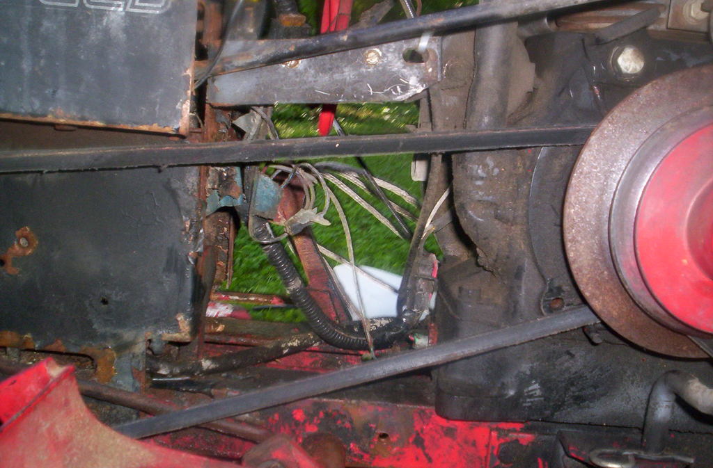

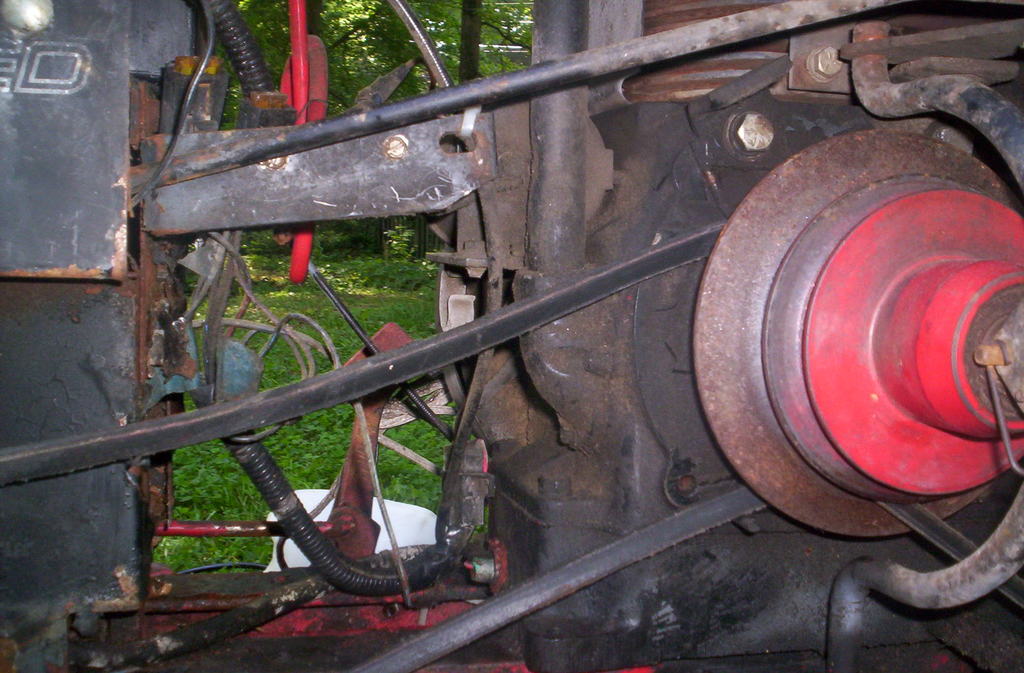

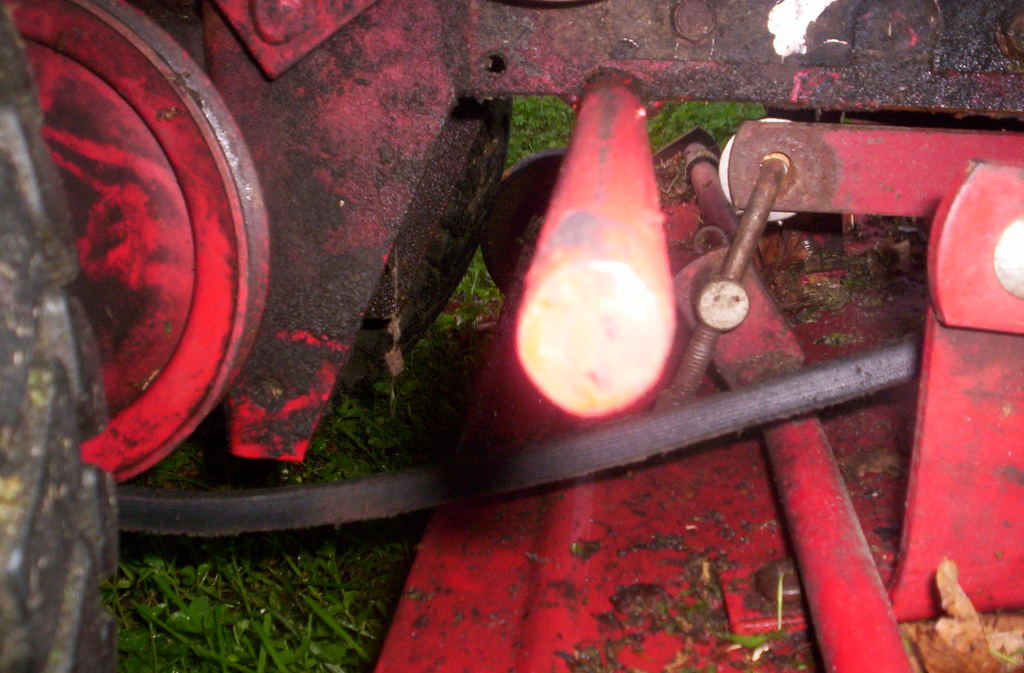

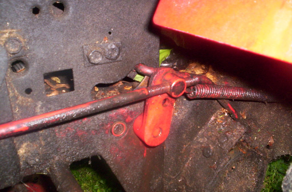

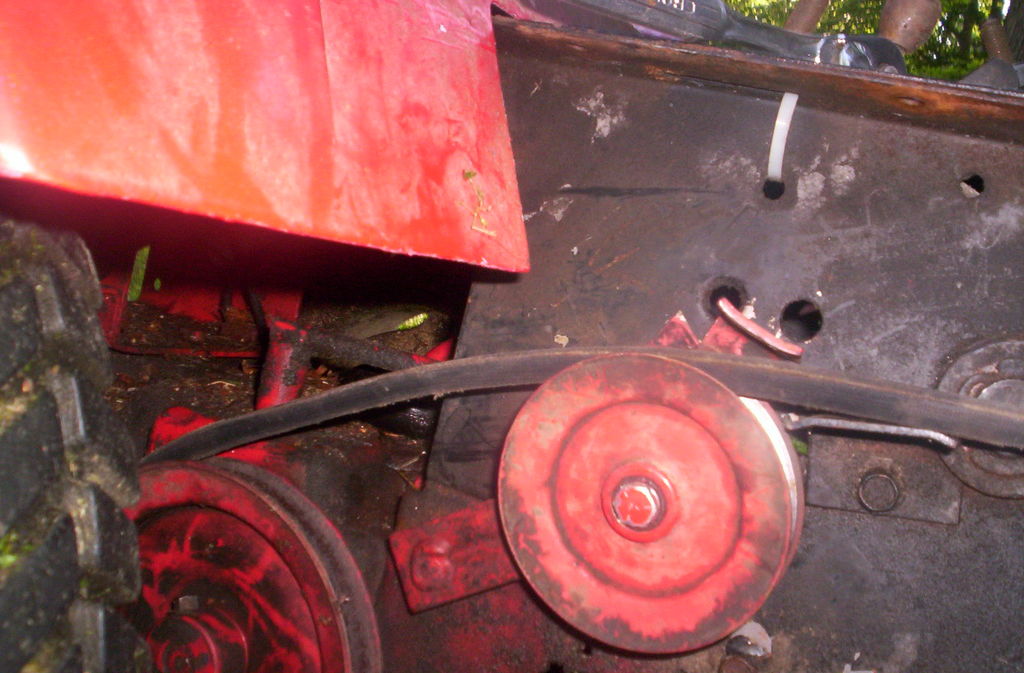

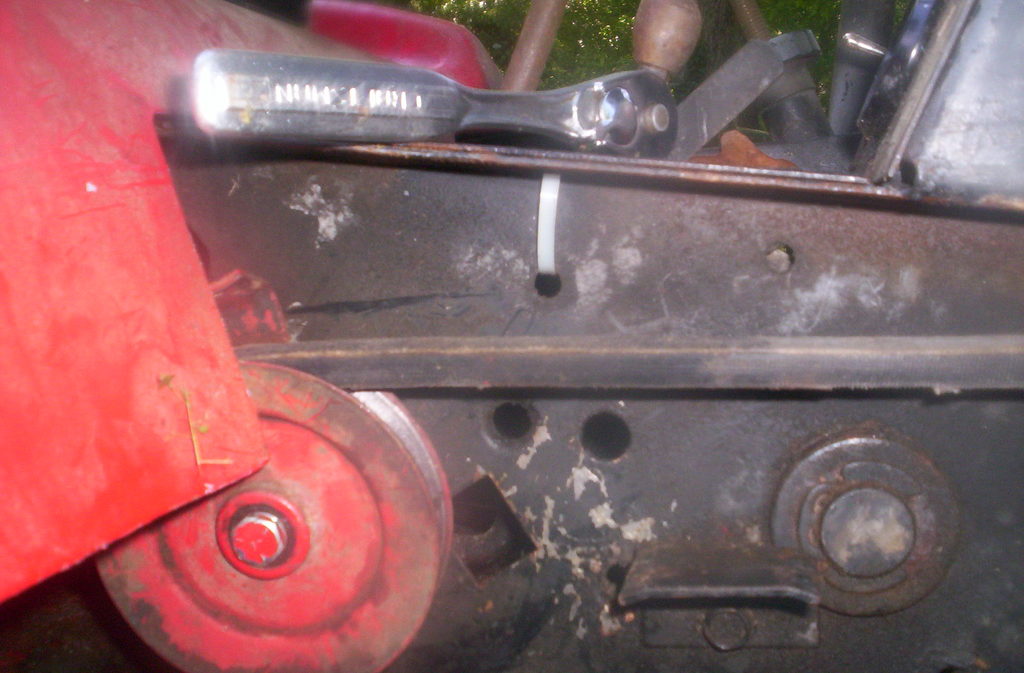

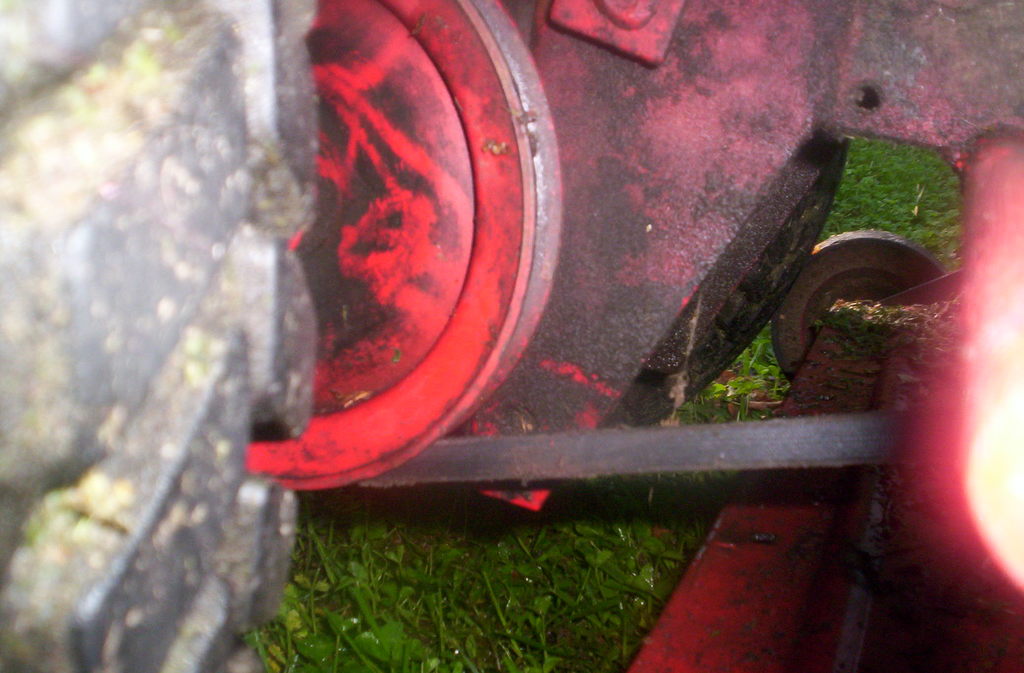

elcamino/wheelhorse 9,358 #15 Posted April 30, 2017 Now that the funny comments are over , back to the issue of the belt problem. I went out early morning before it got way to hot and humid. Removed the tins and foot rest on both sides. Put the defective pulley on to show the belt. I think the belt is stretched are that caused the problem . Please look at the attached pictures and let me know what you think. I have not checked roll pins . I did not see a lot of rust on the pulleys and the trans pulley is on correctly. Share this post Link to post Share on other sites
953 nut 56,511 #16 Posted April 30, 2017 Were we getting ? Looking at the photos I would think a belt and idler should get you back on the lawn for another thirty years. 1 Share this post Link to post Share on other sites
elcamino/wheelhorse 9,358 #17 Posted April 30, 2017 @953 nut I hope that those items will fix the problem. It needs a good cleaning and paint on all the tins and foot rests. The parts are scheduled to arrive on the 4th so I should be able paint all of the tins. I plan on cleaning as much as possible. I want to replace the front spindles with 8 inch spindles with correct rims and tires , but not sure if I will have time. 2 Share this post Link to post Share on other sites
elcamino/wheelhorse 9,358 #18 Posted May 1, 2017 I got off topic with the photos of my arm bruises and then the Peanut Gallery had to tell their stories of bruises. I wonder if @squonk gets bruised setting on the bench at the Big Show waiting on a ride to New York ? 2 Share this post Link to post Share on other sites
bizzo15 52 #19 Posted May 1, 2017 In that first photo is the clutch pedal depressed? I ask because it seems like the idler arm and pulley are way far forward as if the clutch is depressed, if that's not the case that may be your problem right there but I'll let someone with more experience wrenching on these weigh in. Share this post Link to post Share on other sites
1995 520H+96+97 937 #20 Posted May 1, 2017 The tractor is missing engine mounting plate and bolts. Share this post Link to post Share on other sites
stevasaurus 22,959 #21 Posted May 1, 2017 Jim, in the 1st photo...is that piece of metal that sits on top of the idler pulley adjustable...in other words, can you close that gap a little?? 1 Share this post Link to post Share on other sites
elcamino/wheelhorse 9,358 #22 Posted May 1, 2017 @bizzo15 I had the clutch pedal tied down with a piece of rope, made working on it easier. @1995 520H+96+97 to my knowledge 1986 310-8 does not use a mounting plate and two of the mounting bolts are under the frame. @stevasaurus Never tried to adjust the gap but may take a wack at it when I start putting the new parts on it. I need to do some clean etc, so I will take look at it then. Don't want to been something and break it. 3 Share this post Link to post Share on other sites
bmsgaffer 2,046 #23 Posted May 5, 2017 I am with @stevasaurus. YOur idler pulley guard should be flat (parallel) with the top of the belt, and I think it should even be a little hard to get the belt to fit in between it and the pulley. If that guard stays angled like that, as soon as you push in the clutch, that flap will push the belt right off the pulley. My theory is that the first occurrence was a fluke, (bad belt, etc who knows?) and then after that it will continue to happen due to the damage caused by the first time. That belt will come off pretty violently if it gets pinched by something then yanked on by a 10HP kohler. Also be sure that your belt guard has that little tab on top up by the engine still that helps guide the belt when the clutch is pressed. If that tab wore away then I could see the engine grabbing the belt when the clutch is pressed (and thus yanking it out of the idler pulley damaging that little top guard on the clutch pulley) 2 Share this post Link to post Share on other sites
