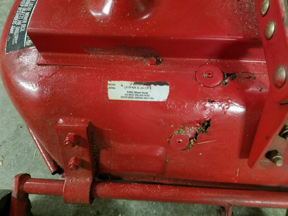

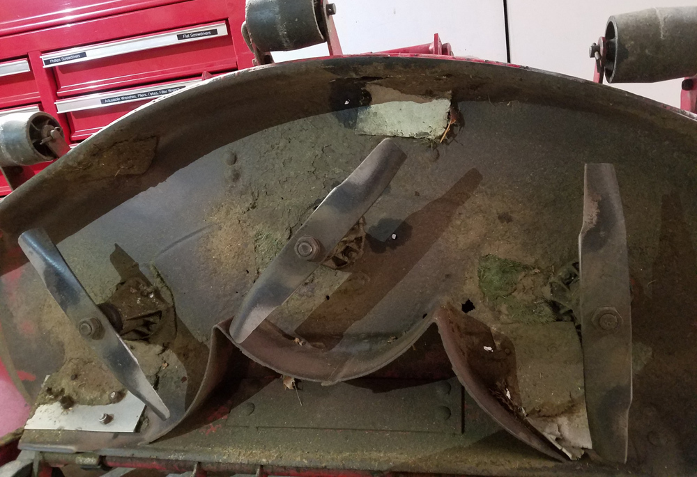

Hi All,
I'm new to the wheel horse forum. I inherited my Grandfather's 416-H.  The deck is showing some holes from rust. Would you suggest I have the deck welded or try to replace the deck with one in better shape? You can see some metal plates in the attached photos. These were a quick fix.  It's time for a real one!

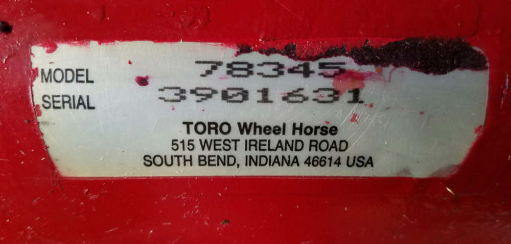

I've also included the model number of the deck. I'd appreciate any suggestions about what other model numbers would be compatible with my tractor.

Here is a list of 42" decks produced over the years. At some point the blades went to a 3/4" center hole like you have now. Before that they had a 5/8" x 3/4" double-D hole and those blades are no longer available. Will figure out when the change was made.
5-1001 replaces RL-426, 5-1421, 5-1422, 5-1423, 5-1000
5-1001 replaced by 5-1010, 5-1011, 5-1012, 65-42MS01, 65-42MS02, 75-42MS01 (Blades up to this point had a 5/8" x 3/4" double-D center hole)
(The following decks used blades with a 3/4" center hole) 75-42MS02, 85-42MS01, 95-42MS00, 95-42MS01, 05-42MS01, 05-42MS02, 05-42MS03, 05-42MS04, 05-42MS05, 15-42SC01, 15-42SC02, 15-42SC03/78345

" (The following decks used blades with a 3/4" center hole) 75-42MS02, 85-42MS01, 95-42MS00, 95-42MS01, 05-42MS01, 05-42MS02, 05-42MS03, 05-42MS04, 05-42MS05, 15-42SC01, 15-42SC02, 15-42SC03/7834"
Thanks for the information. The above decks will fit my tractor?

Thanks for the suggestions.
I opted for the welding option. We'll see how it turns out.
