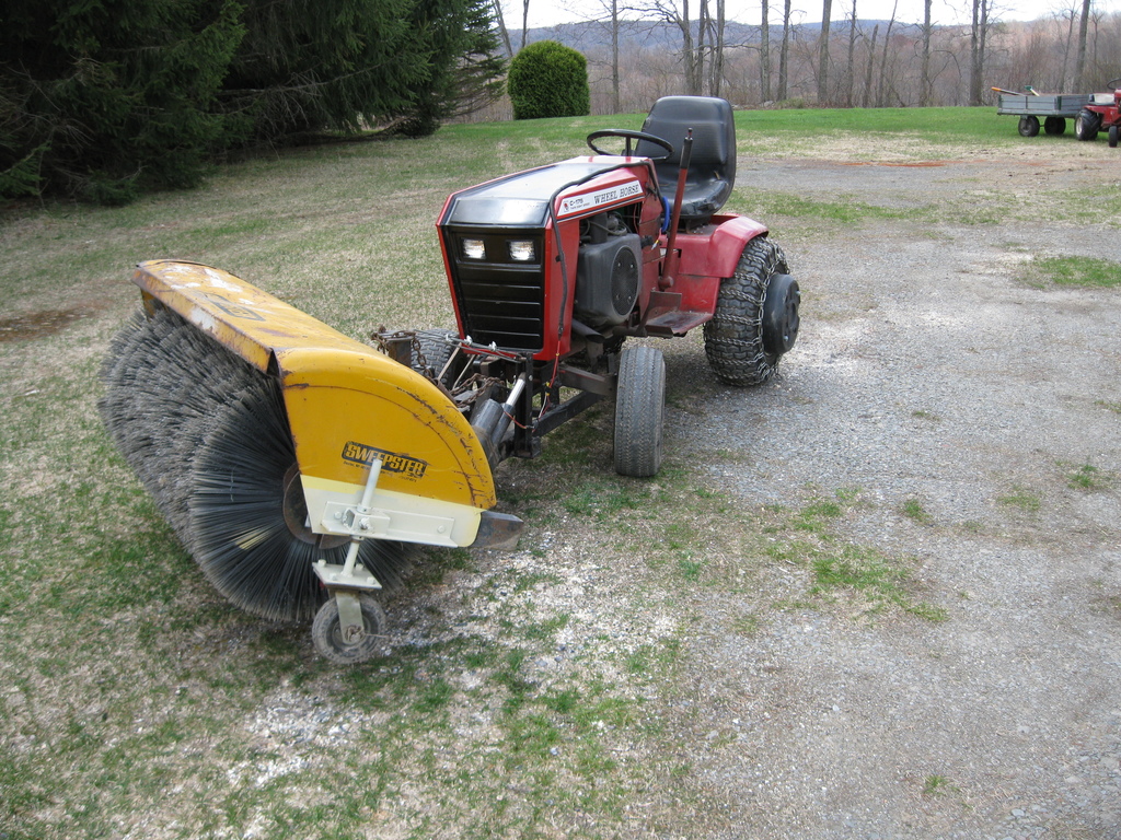

Any point in considering this:
to fit an XI series?
Obviously the hydraulics are an issue but the XIs have that front PTO right up there...
Never thought about using a 12v hydro on a WH but I do have 2 of them.
$400 for a 44" Sweepster if I hurry!
pfrederi
The frame for my sweepster uses both the front and mid tachmatic mounts.  the hydro lift would be nice as the electric on mine is painfully slow.
Bigger problem is the one in the picture is setup for a North south mounted engine.  Where is the output shaft for yours.....

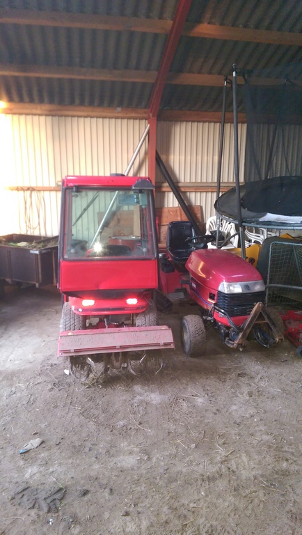

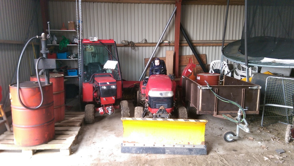

Just wanted to show you, that here in europe there were made a broom for the xi models or a A frame for the tractors. And I have now become the happy owner of a 523 dxi with a front 3 point hitch and pto, and 2 extra hydraulic spools. Including broom, snowblade and mower. IMAG0397.thumb.jpg.518a25b1d53c6767a195bf04d081b9e8.jpg

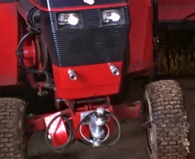

And look at this front tow ball mount below and do I see remotes poking through the hood?

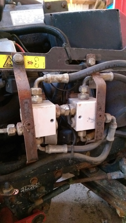

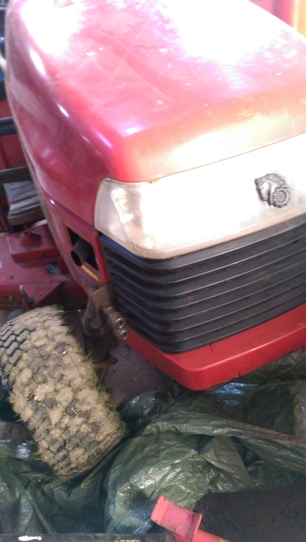

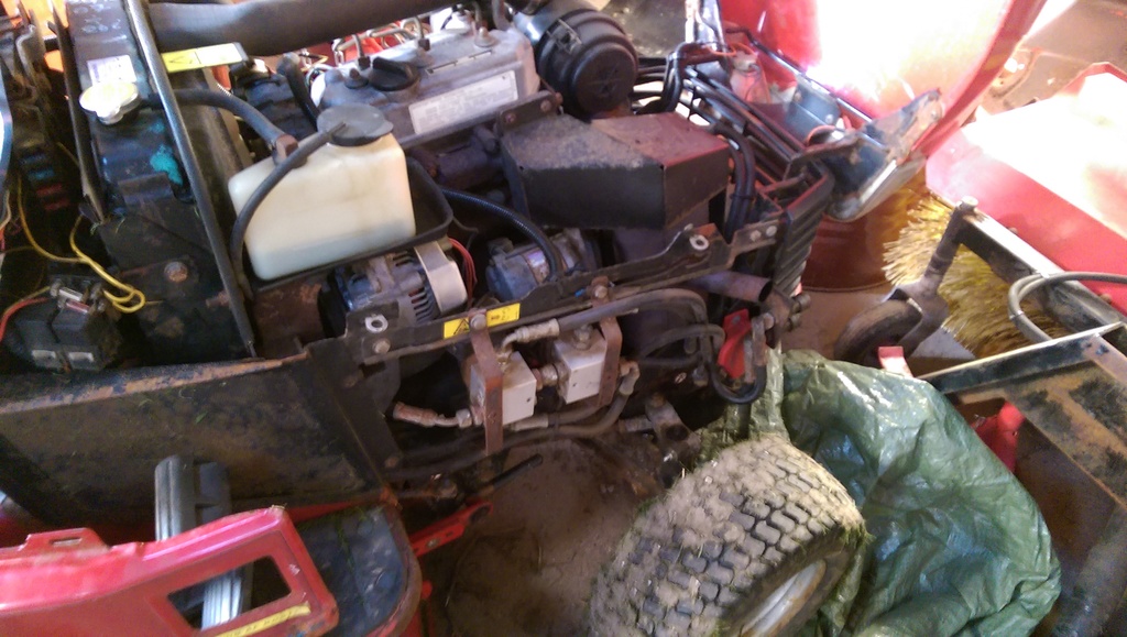

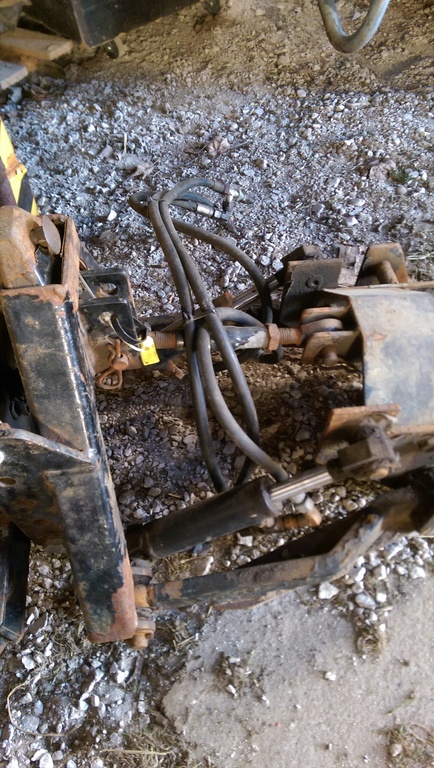

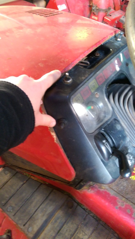

The extra hydraulics to lift the hitch and to swing the sweeper or snowblade is tapped into the hydro with two electric actuated hydraulic valves. This was made by the dealers, as I was told. Think it was a kit made for the xi models by the company Who made the hitch. "GMR Stensballe". http://en.gmr.dk. That company still exist.
So there are two small Electric switches on the dash. I'll will take some pictures.

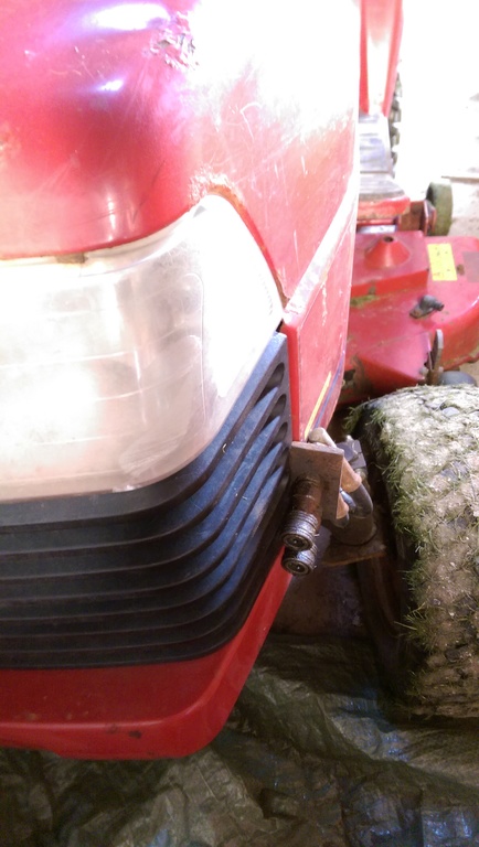

On the 518 hydro besides the 523 dxi. I have made quick hydraulic couplings both front and back. I have dismounted the original hydraulic valve and replaced it with a 2 spool. The ones on the front was for the sweeper, which I am currently trying to sell.

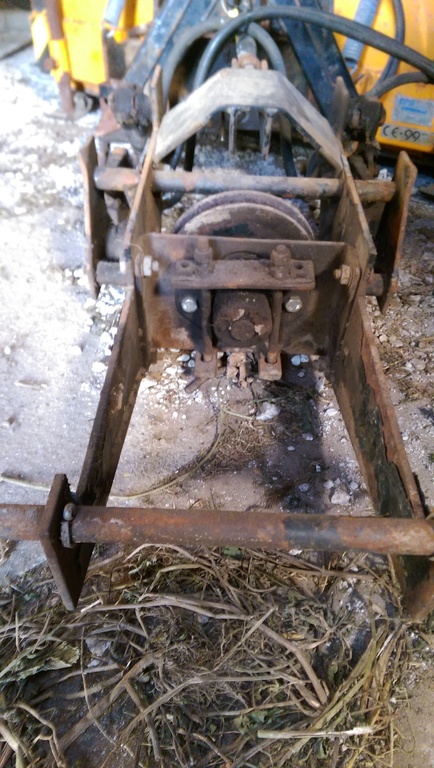

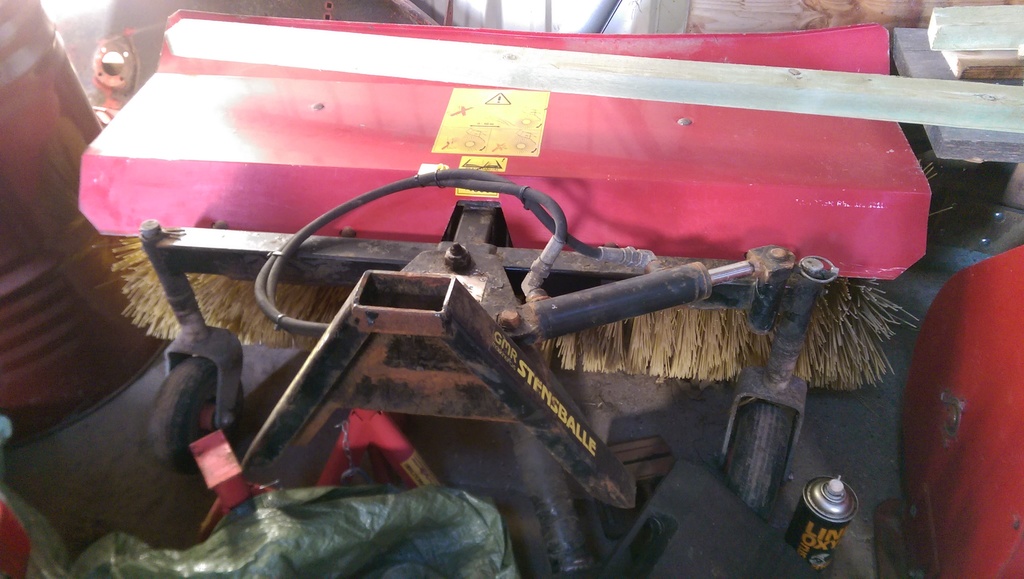

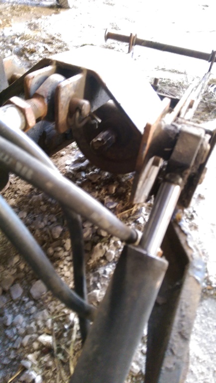

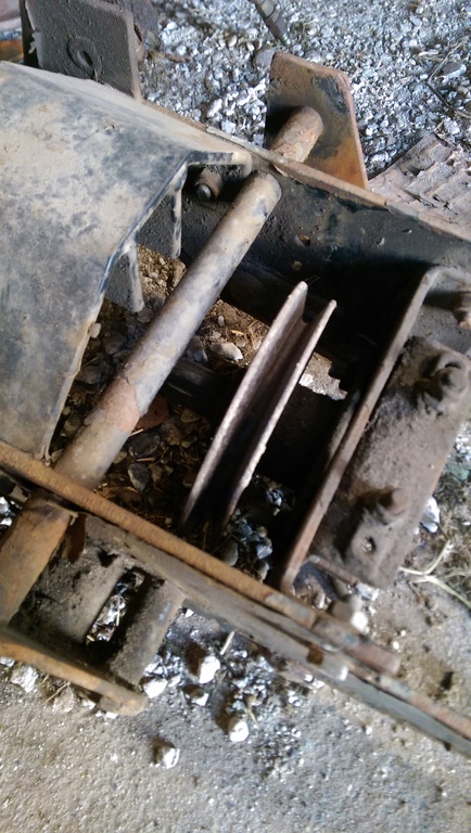

Here are some pictures.
Steffen_Brandt

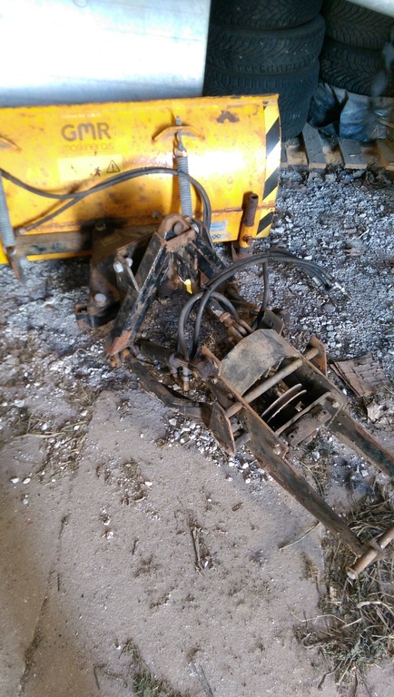

The hitch attaches to the mid and front attach a matic by driving over it, connecting the hydraulics and using the hydraulic hitch to lift it into place. It takes 5 mins. The pto has two screws which is used to tightend the belt.
If only the world was smaller, then you could buy this xi with cab and sweepster. It is for sale now here in Denmark: http://www.altimaskiner.dk/ads/used-toro-for-sale_JmkzMjczMjI.htm?LanguageID=da&CurID=DKK
