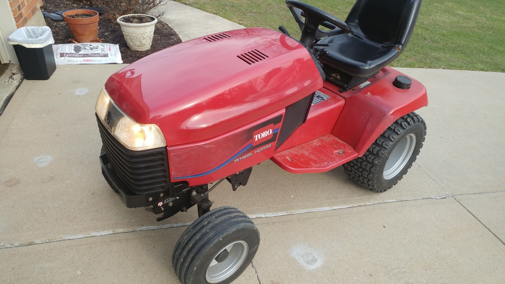

Hey guys! new wheel horse owner here. I picked up a 2001 523xi that came with a berco subframe. I happened to find a 40" compact berco that was hardly used to slap on it only I'm not sure where to start as there are no resources for this that I can find. I'm mechanically inclined, rebuilt the injection pump, injectors etc... as I purchased it non-running as it wasn't receiving any fuel to the injectors (it runs amazing now btw).
so for starters I'm going to go out on a whim here and say that this will require the mule drive or "pulley box". and I've got the rest of the parts in the picture. The parts of the subframe that look to bolt up seem so narrow compared to the hookups on the rest of the tractor. Any help is greatly appreciated.
