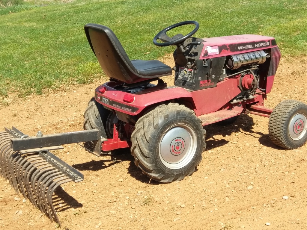

would like to know what is the range of tires that will fit my 310-8 with a 42" deck.Have 23by8.5-12 on back and 15by6-6 on front
Sparky
With the rims you have those are the biggest you should run. If you wanted larger fronts you could upgrade to 8" rims...and get 16x6.50x8 rubber.

You also have a range of choices regarding patterns, turfs, ags, ribs, some use atv tyres, it's down to what you want the tractor to do, and how you want it to look.
Lots of images on RS, have fun choosing.  :handgestures-thumbupright:

With the cheaper ags like I bought (NANCO) or Deestone, a 23x10.5-12 would be acceptable as they measure out mounted 22.5x9.50-12, Jeff.

      Inexpensive - Carlisle X Trac ATV Bias Tire - 16x6.50-8 Good quality (I expect) Should look nice with my large rear aggies
      I don't know how much these have been discounted, but I expect anything you find like this from a good brand will be 2X to 3X the price. $45 each at Amazon. This tire is discontinued.
      Rough measurement seems they are about 16" tall and the lugs are about 1/2" deep.
