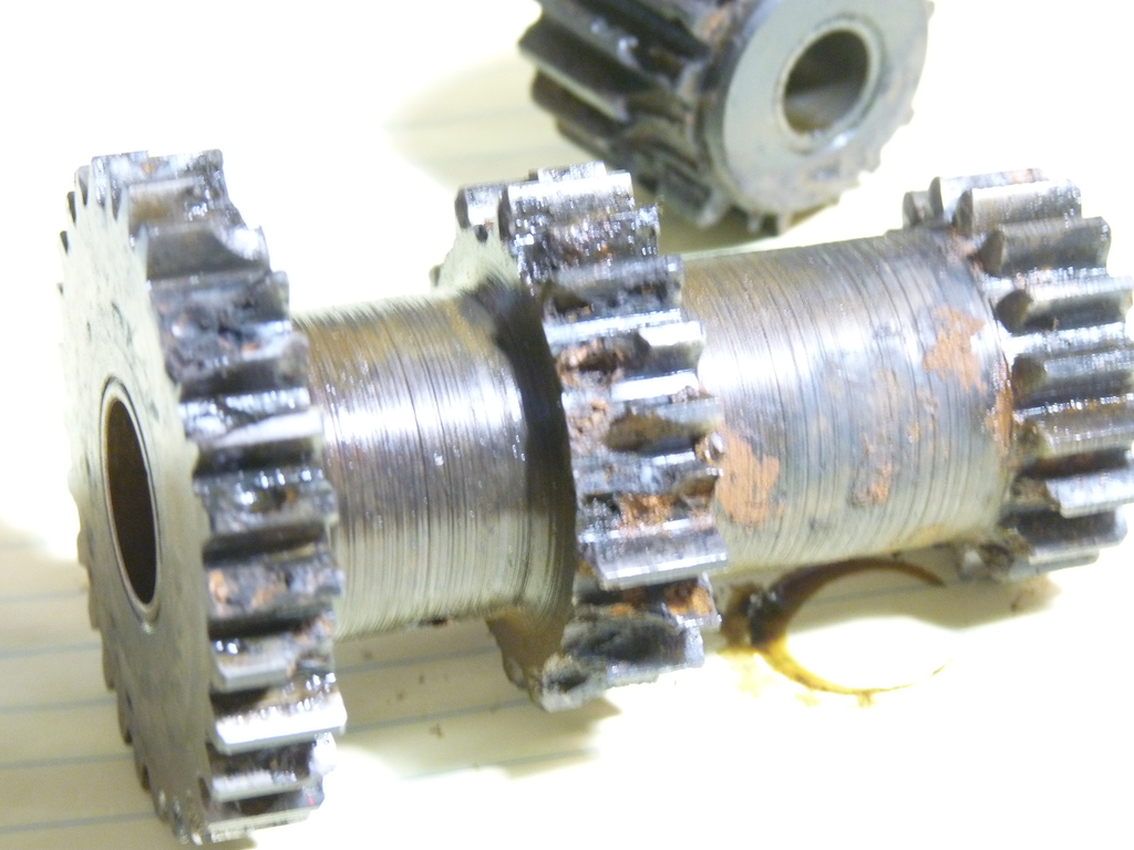

Well I did the tests that were suggested and the differential proved OK.  When I was doing the second test the transmission unlocked.  When I ran it there was a real bad clunking sound so I proceded to remove it and take it apart.  The clevis hitch was really frozen in place.  I beat on it until I was afraid I might break the case.  I soaked it and applied heat to no avail.  Then my cutter tool proved to show it who was boss.  Long story short.  Its all apart and I am looking for a cluster gear and a reverse idler gear.  This is a 5053 transmission.  I am not having any luck.  Anybody got one or have any tips where I can find them?

Sure would like to see some pictures of what you found.  Send a PM to @racinfool40, he probably has the parts you need.  PM me if you can't get a hold of Mike.  :)

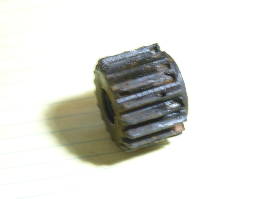

Here is what I found.  The gears do not show wear as much as just metal eaten away from the water.  These are the only two that show any damage.  Thanks for the tip.  I'll contact him.......B

Now that's some serious damage.

You may be in luck...those 2 gears are not the usual ones that go bad.  What does your 1st/rev fork gear look like.  :)

Like I said everything else looks good.  Most show no wear at all.  Several needle bearings are gummed up pretty bad.  I drained at least three quarts of yellow water out of it.  No oil to speak of.  It sat out with the gear shift boot in bad shape so the rain had a direct shot.  I think something in the yellow water reacted with those two gears and just ate them up.  Its a new one on me.  I was going to send a pic of the water but guess I get too many on the previous post......Not used to this forum yet.....B
