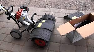

We have one of those Stihl Yard Bosses with the rubber paddle. Makes quick work of what the DOT leaves you! :)
Sent from a tiny open area in Wallfish's van!
imgres.jpg.1328ae64027f74b8e7b2cc27abb8471a.jpg imgres.jpg.05069d4793c70b9d56dc2f224afb466c.jpg imgres.jpg.d9e35a2d77fbd71fcedf9a358b9588fa.jpg

We're a Stihl dealer so certainly!  Not the answer to my quest but a darned good idea and I think quite doable at a darned good price!
Thanks Garry!

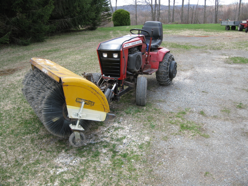

This is what you need...  Just got done 2 days ago doing the driveway.  The ditch by the dirt road is still too soggy to get that done. Beats the heck out of raking
Indeed!  And I've admired your rotary brush before and I believe we've chatted about it.  I still want one but this is a somewhat different project and it may help others utilize stuff hanging around.

c-series don
I agree with Pfrederi the Sweepster model C-48 rotary broom is an awesome tool. Although I had to wait for many years to find a good one and I don't use it a lot, when I do I love it. Great for getting those rocks out of the grass, cleaning up after a light snow, and de-thatching my lawn. PLUS as a collector it's just kinda cool to have!!! People come over and they are like"what the heck,a broom?"And I'm like  "yah try that with your Home Depot mower"!!

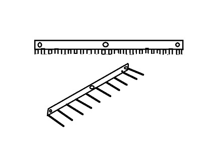

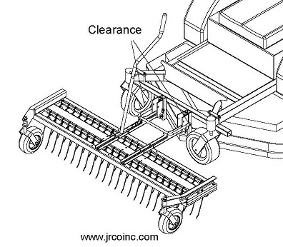

The Tine Rake Dethatcher by JRCO mounts to the front of your garden tractor. Mower not included.
DennisThornton
Figure 1. The rake installs to the front of a vehicle using a snowplow attachment.
Edited by DennisThornton
NA73
hmm. never seen a 'leaf plow' before... kinda neat.
DennisThornton
First time I've seen a leaf plow as well.  I think that would work great on a manual lift WH.  Maybe some wheels too.
