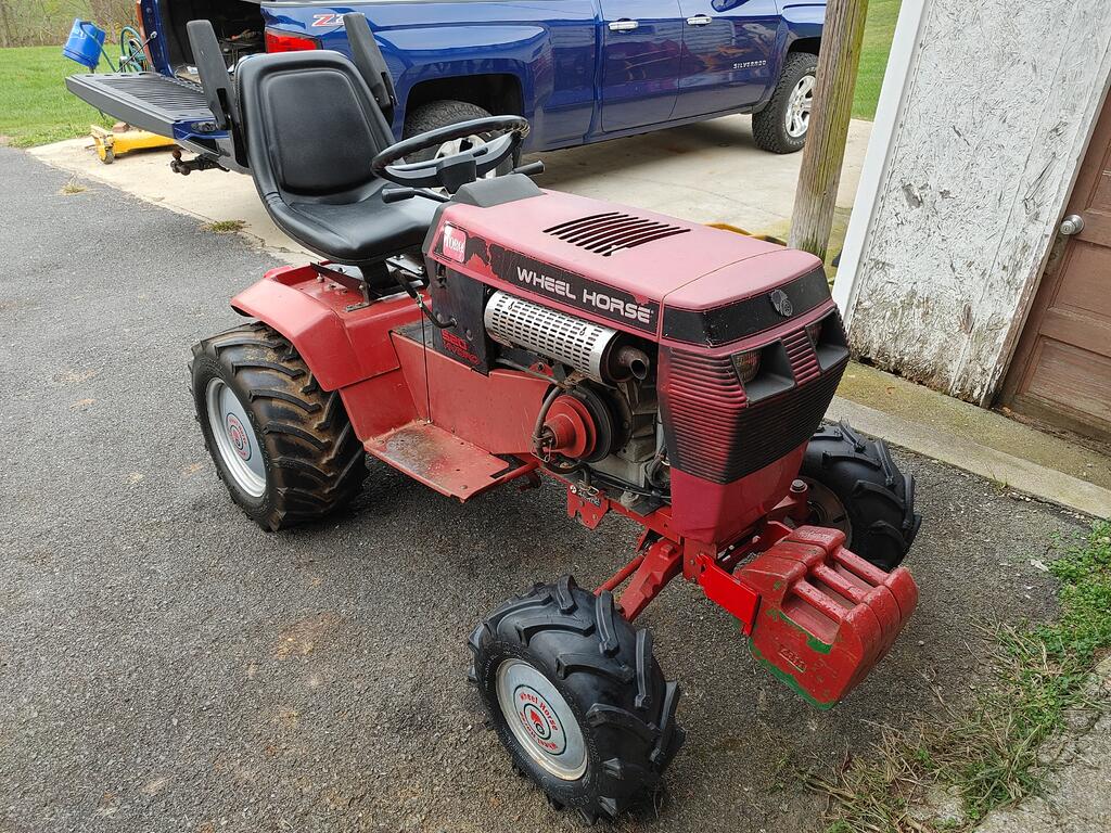

21 hours ago, WVHillbilly520H said:
@PeacemakerJack, @WHX22, @Herder here's the tires and weights all mounted up and ready for work.
Looking good.  How's she ride?
WVHillbilly520H
Through the "swamp" there just fine, especially on that super cushy Kubota seat.

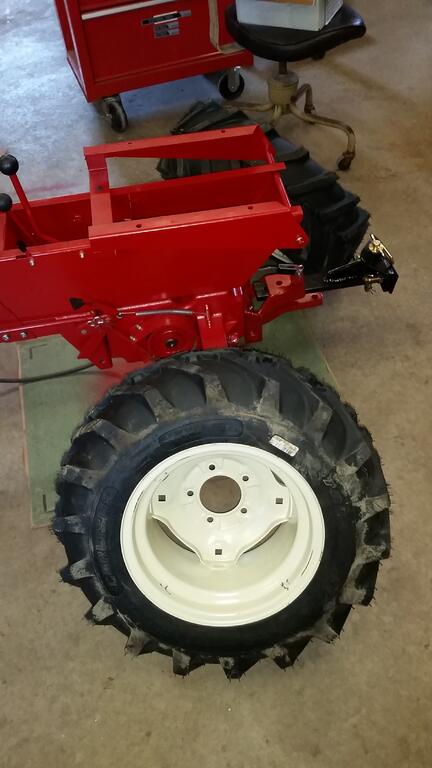

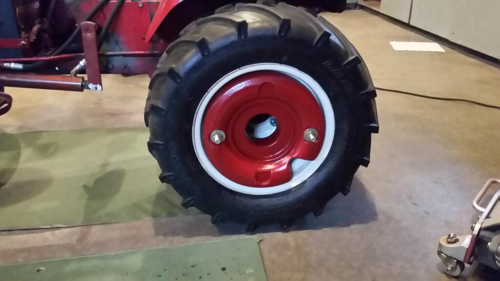

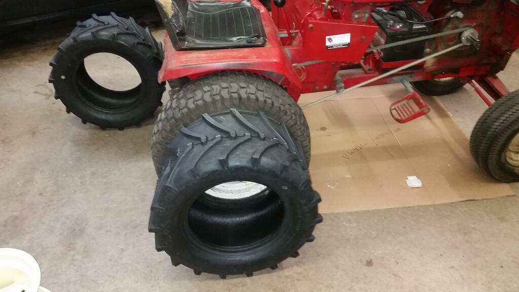

On 4/7/2017 at 6:57 PM, WVHillbilly520H said:
I finally got around to mounting 1 set of new tires front and rear on my "Good Friday" 520H after 22 years the original Dico brand were weather/dry cracked through the sidewalls only tubes were holding the air inside, @HorseFixer, Duke the 23x10.50-12 Nanco brand Ags mounted out to 9.5" not 10.50" but still more than 8" wide ,I don't think you would've been happy with that for your set up, but I'm OK with them being a bit narrow, means a bit more traction and bit less flotation for my intended purposes mowing,gardening, and snow pushing. The fronts are Trac Gard 16x7.50-8 turfs they were an PITA to seat the beads but got it done, had tire shop do the rears, also did inside MF approximately 45# and outside weights CC 30# on them and put my one off powder coated wheel covers on (they hide the "blue" weights that were originally MF red) all this today since I'm on 4-10 hour days now Friday is going to be project day, anyways here the goods, Jeff.
Looks like you can use an alignment
WVHillbilly520H
Why you say that?
  • Haha 1
Ralph S
Those front tires were trashed. LOL
WVHillbilly520H
Yeah dry rot and weather checked...

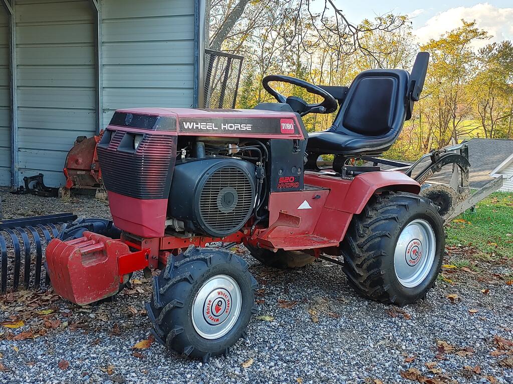

I suppose I should update as both of my 520s now have 100% all 4 corners Lawn Trac R1 AG tires 16x7.50-8 fronts and 23x10.50-12 rears and shown me from my experiences to be very good mowing grass, plowing gardens, grading dirt/stone driveways, and (no chains needed) snow removal.   BTW for all you guys that can't get them big enough for the rear @Achto@ebinmaine @WHX24   https://www.ebay.com/itm/392067872752.

PeacemakerJack
:text-yeahthat:I’m going to be getting a set of those for Kelli’s REDxi.  With the loader on it...I am lacking for traction big times and those work great.  I have watched Jim’s plow mule in action and even at the mud fest at Uncle Bob’s back in August—those did great!
 Thanks for the update Jeff👍🏻👏🏻

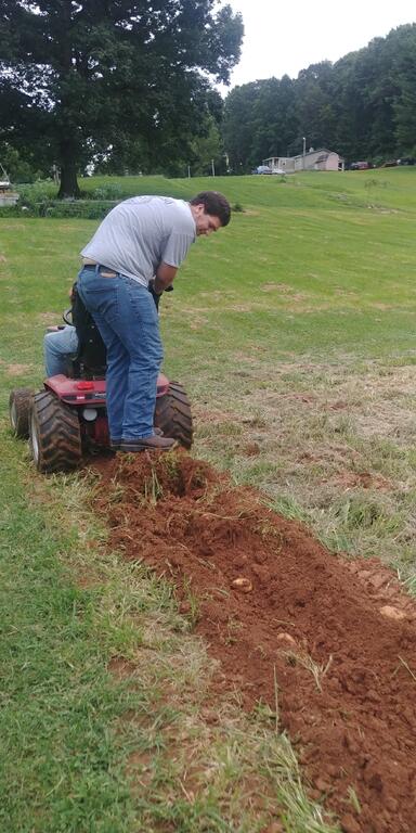

I love mine. Traction, unless they load up with mud, is really good.  I think I paid even less but they are only 23s. They seem to run wide tho and wished I would have got them in 8.50. Think they would have fit in the furrow better and since this is a dedicated plow mule.....
